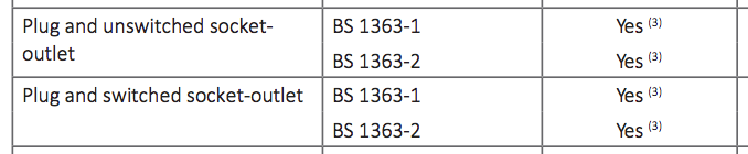

Table 53.4 would seem to disagree with you both
assuming JohnW and I were each of the "both", the relevant information seems to support our understanding about what was an isolator
Table 53.4 would seem to disagree with you both about what are isolators and emergency switches.

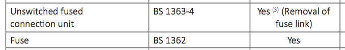

We've discussed before the fact that Table 53.4 now says that 'isolating switches' are suitable for 'emergency switching' (hence capable of breaking a full load current), which presumably means that the relevant Standards have changed such that 'traditional isolators' not designed to break current probably no longer exist - hence my comment that it seems that any 'isolator' one can now get will also be rated to break a current equal to its full CCC.
I see that the Table also says that BS88 and BS1362 fuses and unswitched FCUs ("by removal of fuse") are acceptable for 'isolation' - but, as I said previously, one cannot get BS7671-compliant isolation in a TT installation by the use of a fuse.

Note 3 of Table 53.4 says those devices are suitable for on load isolation, and
note 4 deals with TT.
From reading your posts, I did not get the impression that you agreed with Table 53.4. .... Note 3 of Table 53.4 says those devices are suitable for on load isolation ....
Not for fuses (BS88 or BS1362) - so, in keeping with common sense, they are saying that fuses are not suitable for on-load isolation.
I'm not actually sure what they mean when they say that BS1362 fuses are suitable for isolation, although not on-load isolation. Do they simply mean removing the fuse from a plug, and then plugging it into a socket - but who would be daft enough to do that?! (they deal with FCUs separately).
They simply man that a plug without a fuse provides effective isolation.
