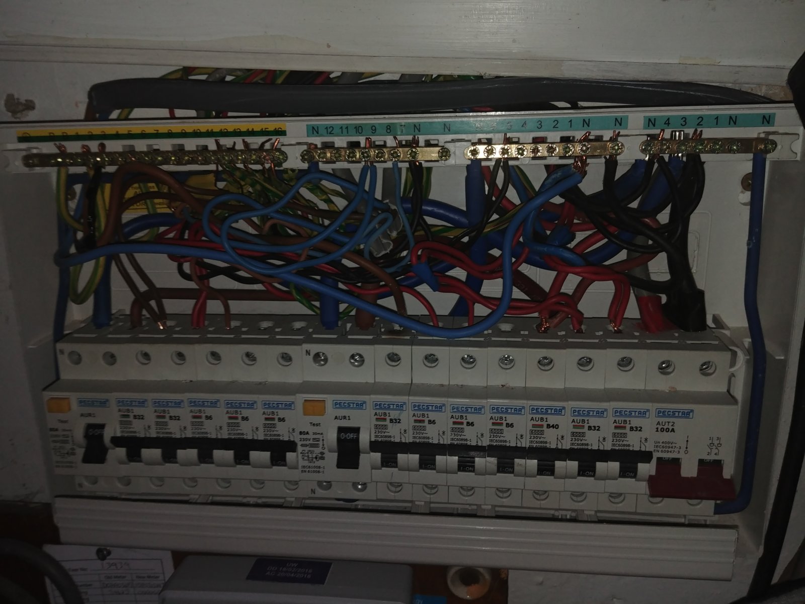

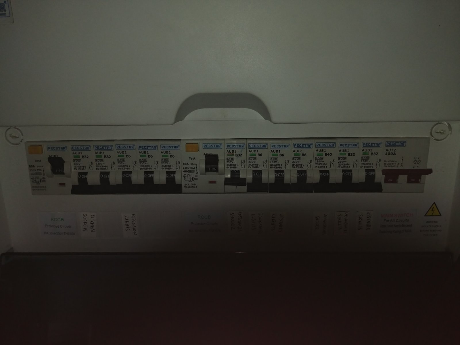

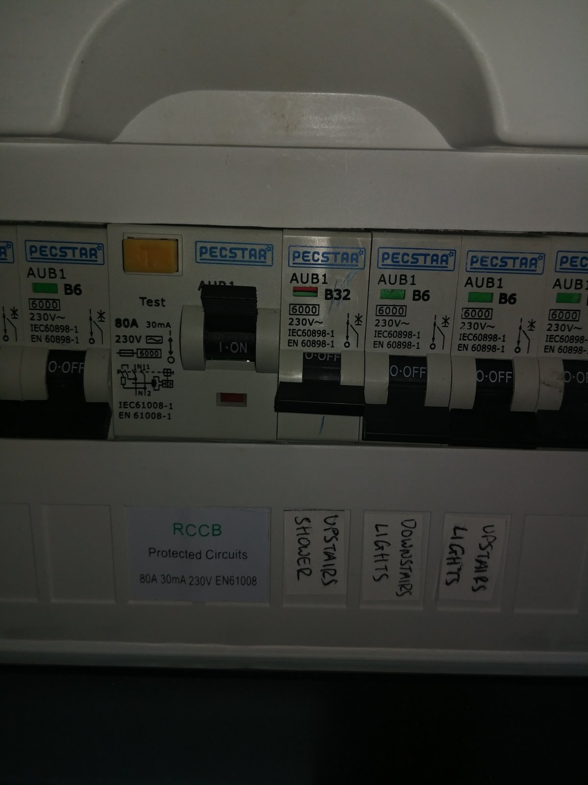

Sorry for the later reply. I have taken the cover off and taken pictures. Can't really make sense of anything. Also, when I was turning all the switches off the one labelled upstairs shower would not fall all the way. It was stuck half way. It goes up but not all the way down.
I was reading online and was wondering if changing the TCO might fix the issue. But I'm a little out of my depth when it comes to electrics. So would need guidance before attempting anything.

First thing- did you isolate the supply to your consumer unit? (Knocking all the breakers and rcds off still leaves live parts accessible when the lid is off)
Second, the cable in the breaker marked UPSTAIRS SHOWER looks too small to run your shower- it looks like 2.5mm, for your shower 6mm would be a minimum, 10mm might be required (depends on length of run and installation method)
Third, you've probably cooked that UPSTAIRS SHOWER breaker with your frequent (daily) overloading.
Fourth, you may (low odds but possible) have knackered your shower by repeatedly subjecting it to power fail conditions.
Fifth- unlikely you have 2 breakers serving 1 appliance- if you did then the shower would work (maybe briefly) if either circuit breaker was on
Sixth, given the poor design of the installation and your lack of knowledge about electricity i'd suggest you get an electrician in to verify what is actually installed and what is required to maje your shower work safely
Seventh, do you have a downstairs electric shower as well as the upstairs one?
It will not. The shower isn't the problem.
The consumer unit is a piece of cheap tat that has been installed poorly by someone who had little or no idea what they were doing.
It has multiple problems.
You can't fix this yourself.
Just some of the problems contained in that untidy mess:
1 - many examples of single insulated wires outside the consumer unit
2 - black wire connected to the earth bar, which is either a neutral or something that has burnt. Main earth conductor appears undersized, unclear which if any are bonding conductors but they are undersized as well.
3 - bare copper exposed outside of terminal (multiple examples)
4 - CPCs poorly terminated and in the wrong order relative to the circuits. Same for the neutrals.
5 - all 3 neutral bars in use which implies some circuits have no RCD protection, probably the 2 socket circuits at the right side
6 - 40A MCB supplies multiple circuits, overload is likely
7 - Shower MCB incorrect rating and damaged by overheating
8 - incoming tails taped up which suggests the insulation is damaged
9 - circuit not labelled on cover, but has wiring connected
