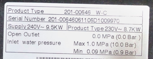

Even worse than. 8.5kW at 240 volts is 35.4 amps.
And chances are, that newer 8.5KW heater is rated for 230V and when run on 240V would potentially be more like 38A [or 40A at 250V] and still the fuse will not blow.
That's not likely.
They would rather call it 9.26kW @ 240V.
Depends on it's country of origin. Those that were on 220V do tend to quote at 230V and I fairly regularly find currents higher than predicted for this reason.

Of course it does, a unit rated for say 10KW at 230V has a predicted current of around 43A but run it on 240V and it will be 10.88KW and 45.3A.

If you buy a Triton, Mira or Gainsborough shower, the rating is at 240V.
The last Gainsborough I checked came out a little high, so either it was rated at 230V or it was a heavier heater than quoted. My present 10.5KW Triton at 243V drew 41A so less than10KW.
Are we talking at crossed purposes?
I (and I think Aptsys) are talking about what the manufacturer states on the box (and internal label), not what you may measure.
This may be 9.5kW in large print for advertising. In smaller print (and internal label) it will state 9.5kW @ 240V, (and likely also on the label 8.7kW @ 230V).
These figures do not match exactly according to Mr.Ohm so I presume they are near enough for manufacturing tolerances which might vary slightly.
If they make an element with a resistance of (in this example) ~6.06Ω, they could quote whatever voltage and power they wanted but it will still be the same shower. Obviously they will quote what the user is likely to actually have, ~240V plus (for Winston) the nominal 230V.
It could be but I have never seen one where only 230V is stated.
The resistance of the element will increase with the temperature so I would consider that normal.
