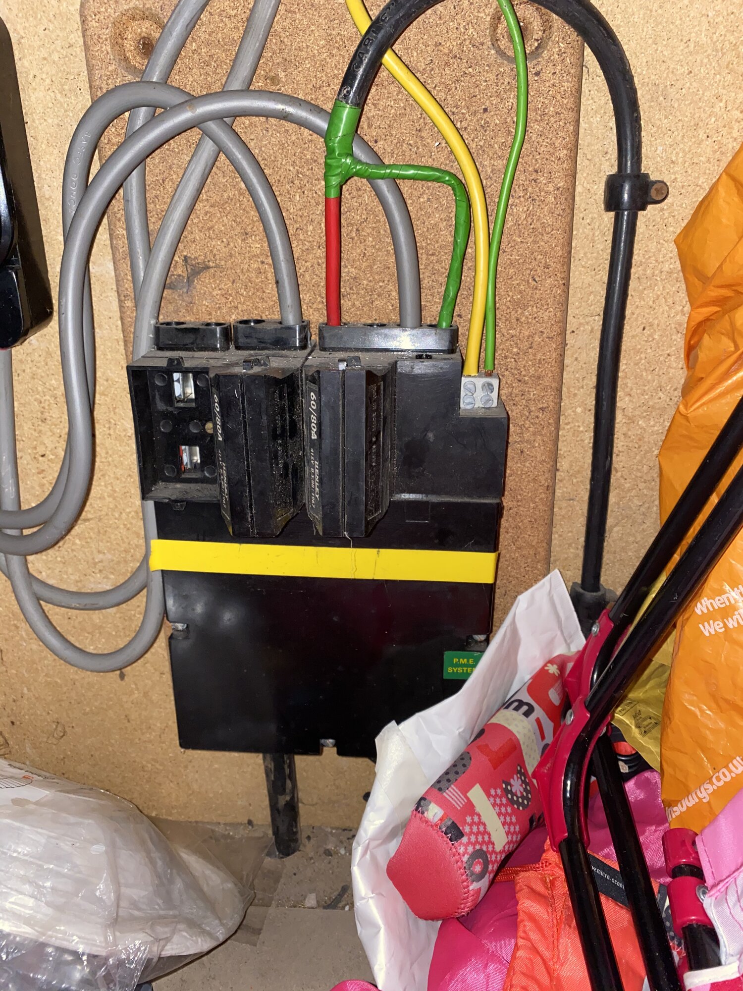

I’ve been researching EVs and came across the term looped electric supply. (I’m not an electrician)
I wanted to know if mine is and I don’t think it is but it looks like there used to be 2 cables at the bottom due to holes in shelf but now isn’t. However I don’t understand is what the black cable with the red and green at top top is - this goes into the ground in a separate place to the main supply.

I would guess it goes next door.
or maybe a garage
I would have used black tape. But the DNO do what they like
Looks like a feed to another dwelling, but the fuse is in your gaff, so not ideal.
Unless there is another meter in your property.
Where is the missing fuseholder? That's a hazard!
There's no garage/other meter on my property. Looked an odd setup to anything else I've seen pictures of.
The fuse holder - I don't know, we've never touched it. Apart from possibly when an electrician upgraded our fuse board when we moved in. :/

Use this map to find out who your electricity supplier is, and then ring their emergency telephone number to report a dangerous cutout with exposed live parts.
They will normally have an engineer on site within 3 hours. While he’s there, you could ask him where the other cable goes to. They will not charge you for this repair.
I wouldn’t class this as a looped supply as it’s on a different phase, but it’s still a bit of a poor setup, and currently is in an unsafe condition.
Thanks for the advice. I've called and someone is coming out today
I would agree it does seem to be a three phase supply, with one phase unused, as to if there is actually three phases or if some has used a three phase head on a split phase supply we have know way of knowing. There is only one set of people who can tell you, and that is the DNO.

As expected, 3 phase supply -one going to neighbour and one not in use. They replaced the missing case, and upgraded my fuse from 60 to 80 while they were here.
Did they sort out the exposed basic insulation on the looped supply?
