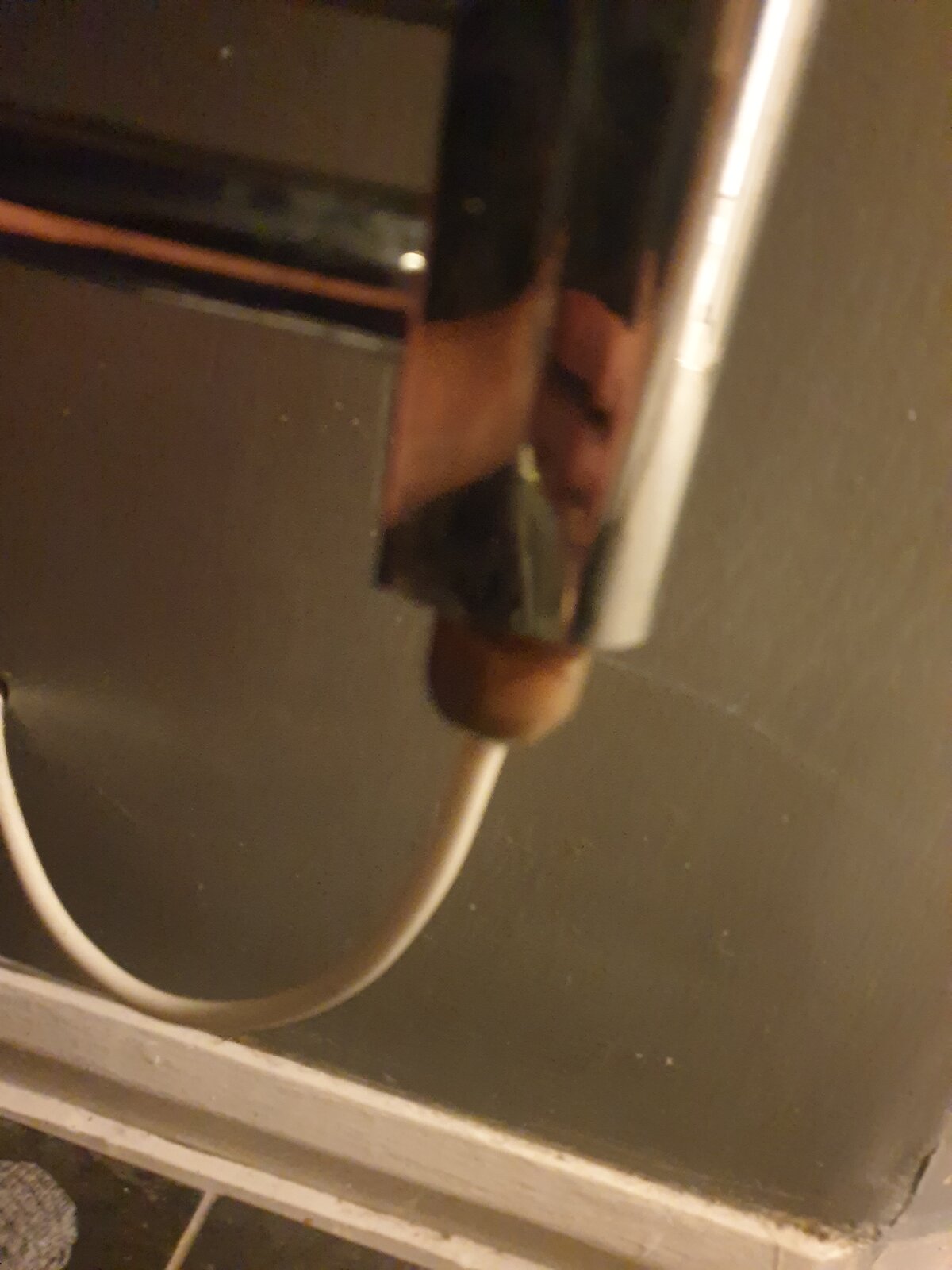

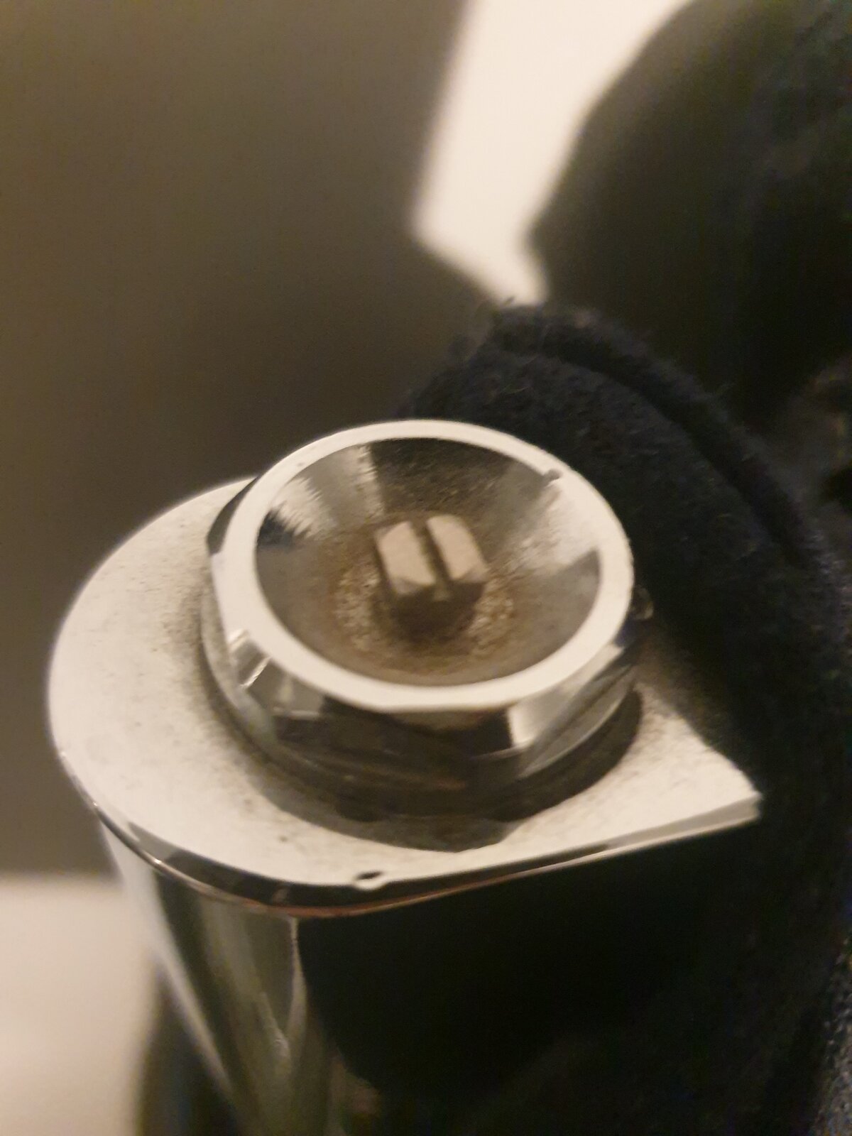

My towel rail gets too hot to touch. Its electric, no water feed so i assume its water filled. Is there anyway to lower the temperature? I have provided a picture of a screw/valve? Situated on the top of the towel rail. Didnt want to touch it, but is that possibly a way to do it?
Any help would be appreciated

The heating element has a thermostat.
Standard (single heat) elements like yours heat to between 65-80°C and maintain that temperature.
If it’s getting hotter than that the thermostat may be faulty. You can buy a replacement element. You can also get ones that have a variable temperature.
If you change the element you’ll need to refill with water.

Do you know what the screw on the top does?

They are a standard size from a screw fitting point of view, but they vary in length and power (watts). Replace with one the same spec as your existing. It should be written on the element where the cable goes in.
Fill it from the top! Unscrew the plug at the top. The large plug, not the valve in the middle of it.
You have a radiator that can also be hooked up to a central heating system. The screw at the top is the bleed valve to let Any air out.

Those don’t actually limit the temperature in the way that a thermostat does. There is no temperature sensor in it.
It’s just a device that switches on and off. So if you select (say) 50% it will power the element for half the time, 20% it will switch on for say 5 mins, off for 20 mins etc.
They are about the same price as a replacement element, not including back box and installation cost.
They adjust the voltage to the element, adjusting the heat output. In use in countless B&Bs.
Changing an element involves removing the rad from the wall, unwiring, and removing the element. Time consuming. This controller can replace the flex outlet if in a suitable zone, or be placed quickly adjacent to the existing spur.
