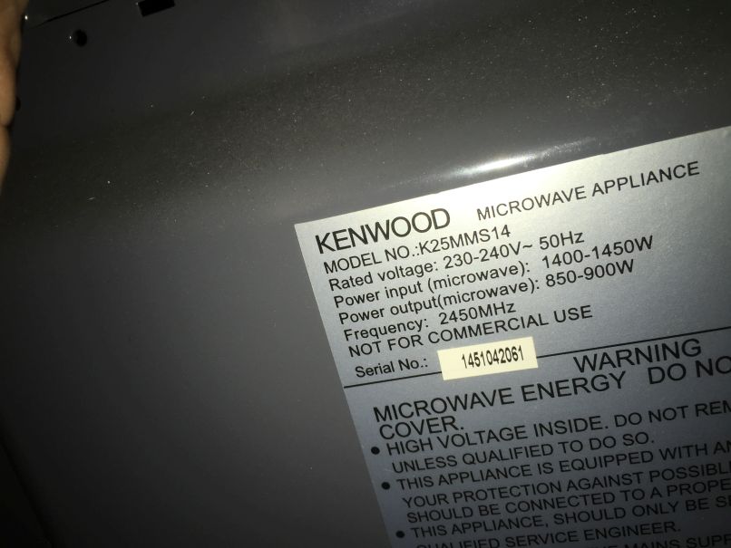

That's the model. The inside looks like it did when it was new to be honest.
