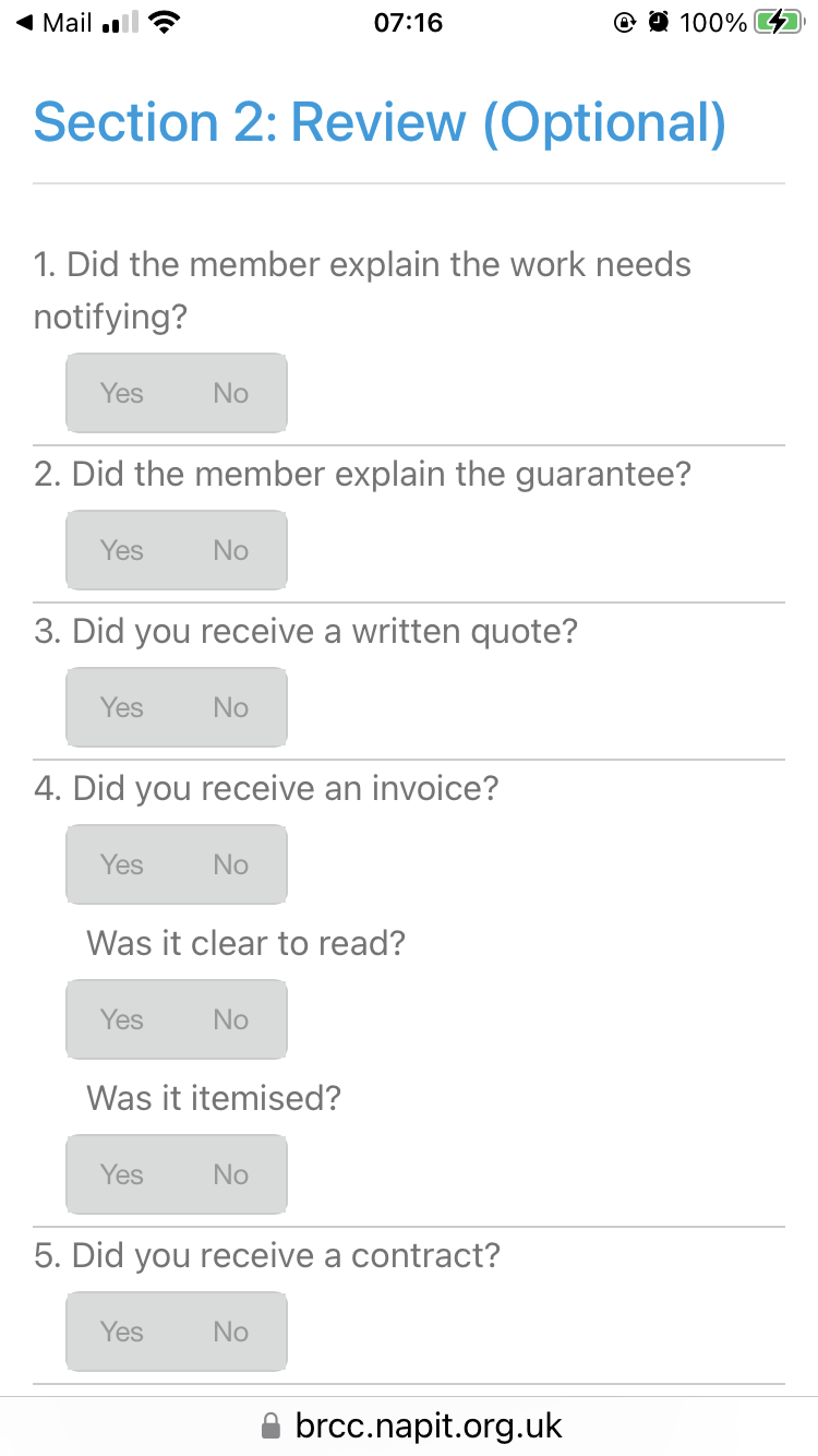

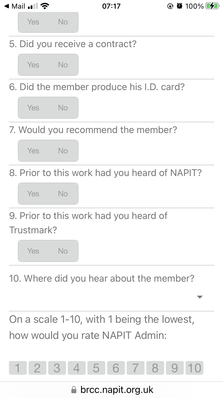

These are the questions the customer can answer!
I'm not sure Napit should be asking all these questions - some of these are between the customer and installer -

I agree, NAPIT should not be asking all those questions.
