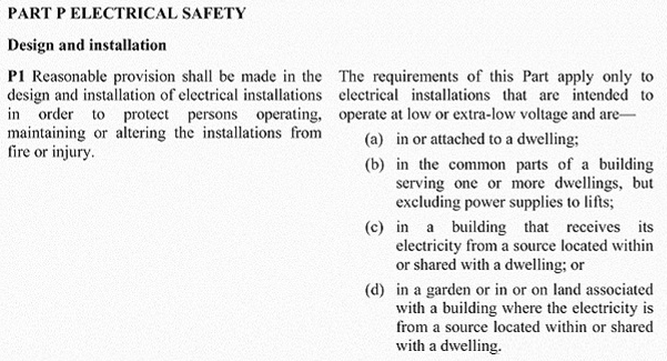

No, Part P is the single sentence which states:
That's it.

That’s not the STATUTORY INSTRUMENT (law).
That is the approved document which (if you read the introduction) provides methods by which one can comply with the law.
Agreed, the Approved Doc is one way of achieving Part P. Part P itself is the law, it is a part of the building regulations, the doc is not.

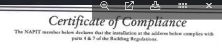

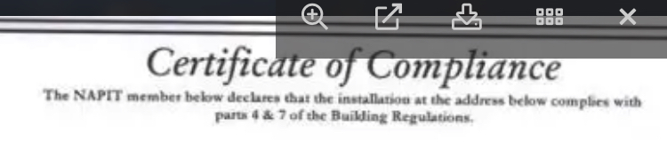

When stating "Regulation 12" then regulation 12 of what exactly?
The compliance certificate, provided to LABC by the CPS says this
Look them up. The paras say basically that the work has been done properly and that it complies with the relavent building regs. Part P in this case As well as B, L, F, M and others that might apply to the work in question.

You are confused. @Murdochcat is talking about the delivery of the Certificate of Compliance (notification). That comes from NAPIT and is sent to the customer and the LABC.
The Electrical Installation Certificate is provided by the electrician.
