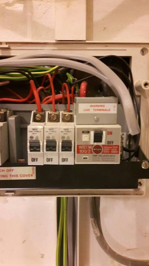

I'd agree with others the report is poor. Unless the cooker socket is likely to supply outdoor equipment there's no code 2 needed for lack of RCD's in my opinion although getting this one socket covered by (30ma) RCD (or perhaps the plate replaced with a non-socket one if plenty other sockets in the kitchen) would be a good idea. The Main Switch appears to be a time-delayed 100ma RCD which is exactly what you DO want for a TT installation.

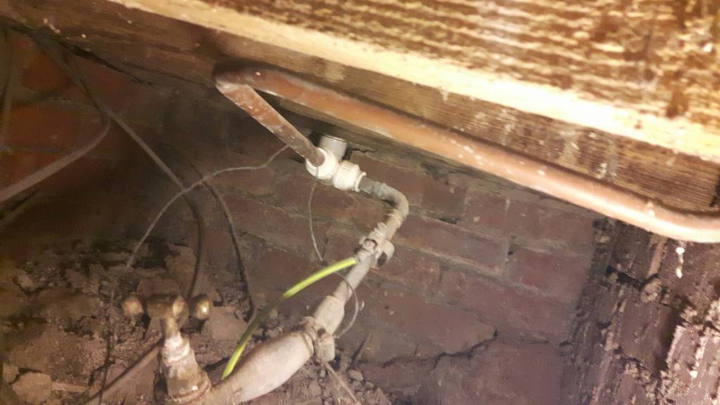

The earth wire is attached to the consumer unit, so should I still do the gas / water bonding?
Yes, it is required.

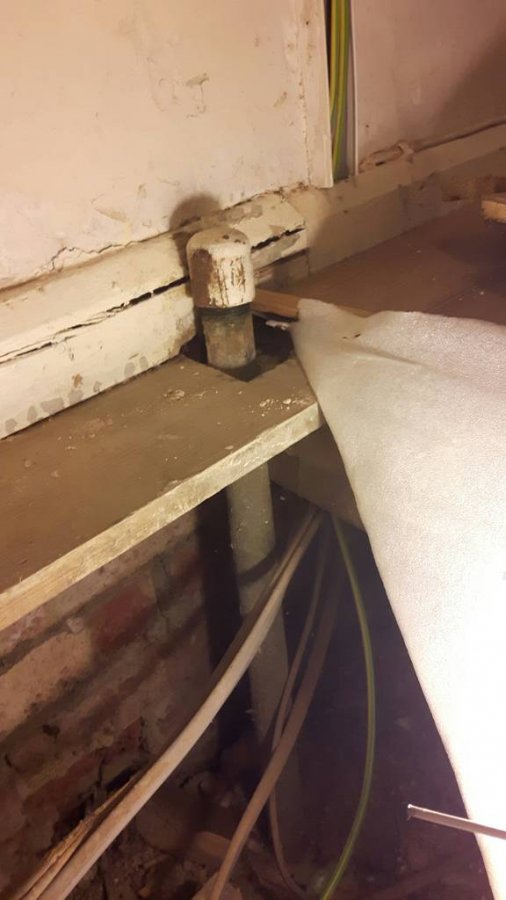

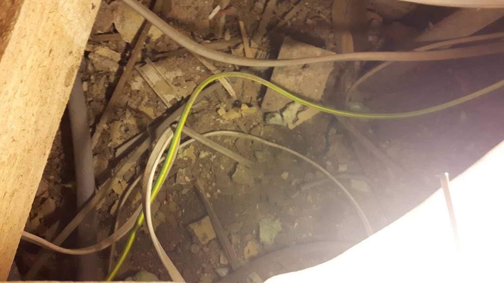

I've been to the property and had a look at the gas and water bonding. I lifted
up a few floor boards in the kitchen and under stairs cupboards and found the
gas and water earth bonding. The gas bonding runs under the floorboards to the
outside gas meter and the inlet water pipe is bonded. I have attached pictures
of what I found for both gas and water.
Mentioned it to the electrician, but they won't change the report.
Please see pictures of the consumer unit with the lid removed.
I notice that the left side contains a 30mA circuit breaker. Does this mean all the RCDs are effectively covered by this?
On the right side is a Time delayed RCD 100mA Trip.
