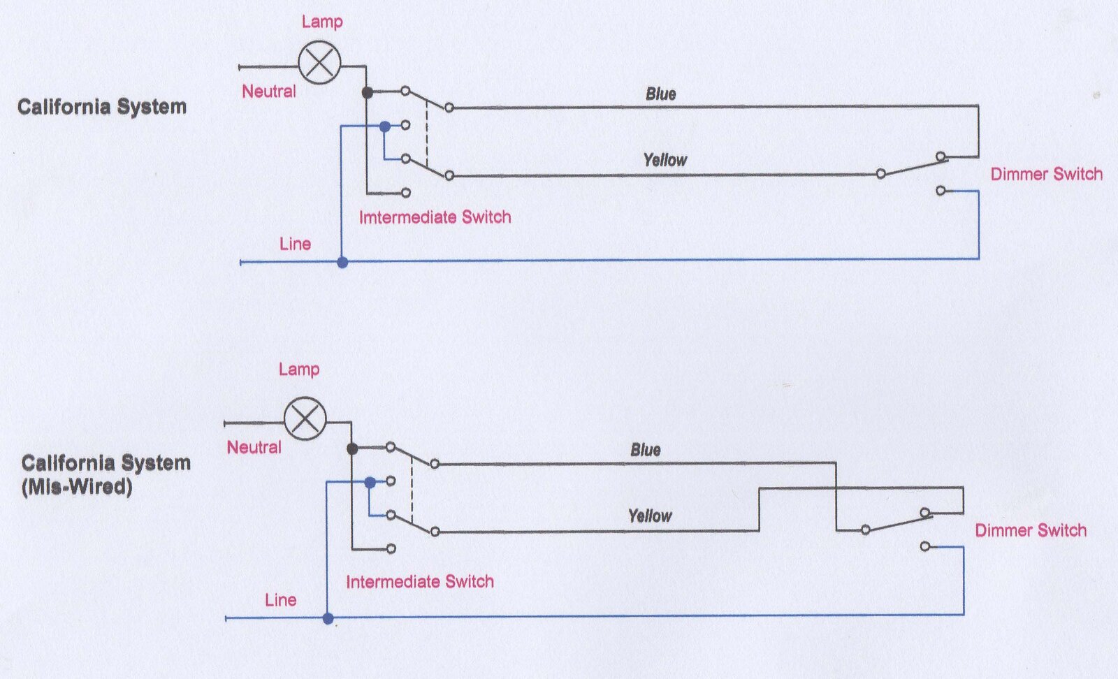

"Analyzing" this "Problem" has been an "Interesting" exercise for a Summer Sunday afternoon - in Australia!

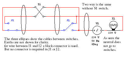

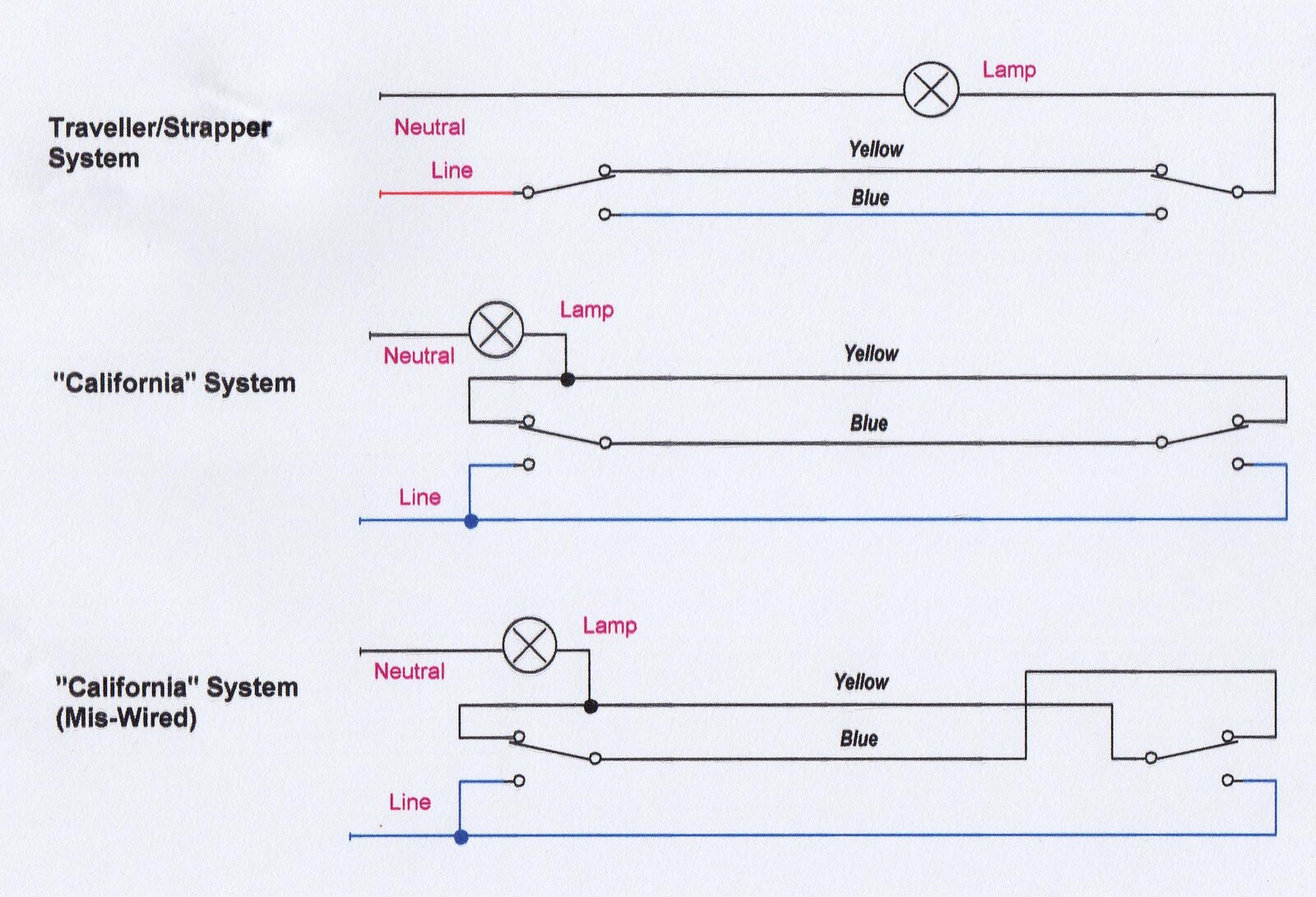

I apologize for using "Americanisms", but I am used to having 2-Way circuits in Australia wired as for that which is called in North America a "Traveler System" but it seems that in the UK this is called a "Strapper" System - as shown in the first diagram below.
I suspect that the circuit is wired as what is called in North America as a "California System", which I understand may be fairly "normal" in the UK and shown correctly wired in the Second Diagram below.
(See https://en.wikipedia.org/wiki/Multiway_switching )
What is that System called in the UK?
One advantage of this second (California ?) system is that the Lamp could be connected at either end.
In North America, Energy (often miscalled "Power") could also be derived for a 15 A/120 V Socket Outlet at the "far" end, if a Neutral is also available there !
The second diagram above shows a correctly wired "California" System and
the third diagram shows the same system wired incorrectly - giving the problems encountered by pmartin008 ,
with the Lamp and Supply Line connected at the "Landing" and the "Dimmer" SPDT Switch at the "Ground Floor".
(The "Named" Colors of the wiring insulation is immaterial, except to indicate the possibility of reversal.)
The above two diagrams show the "Complications" introduced by using a "Crossover/Intermediate" switch to do the job of a SPDT switch.
So, reverse the connections of the Blue and Yellow insulated wires at ONE end and it is likely that the problem may be solved !
Why the original "installer" used a (Relatively Expensive) "Intermediate/Crossover" switch,
in lieu of a SPDT switch
(which would have "done the job" for only a 2-Way [2-Location] switching situation)
is incomprehensible!

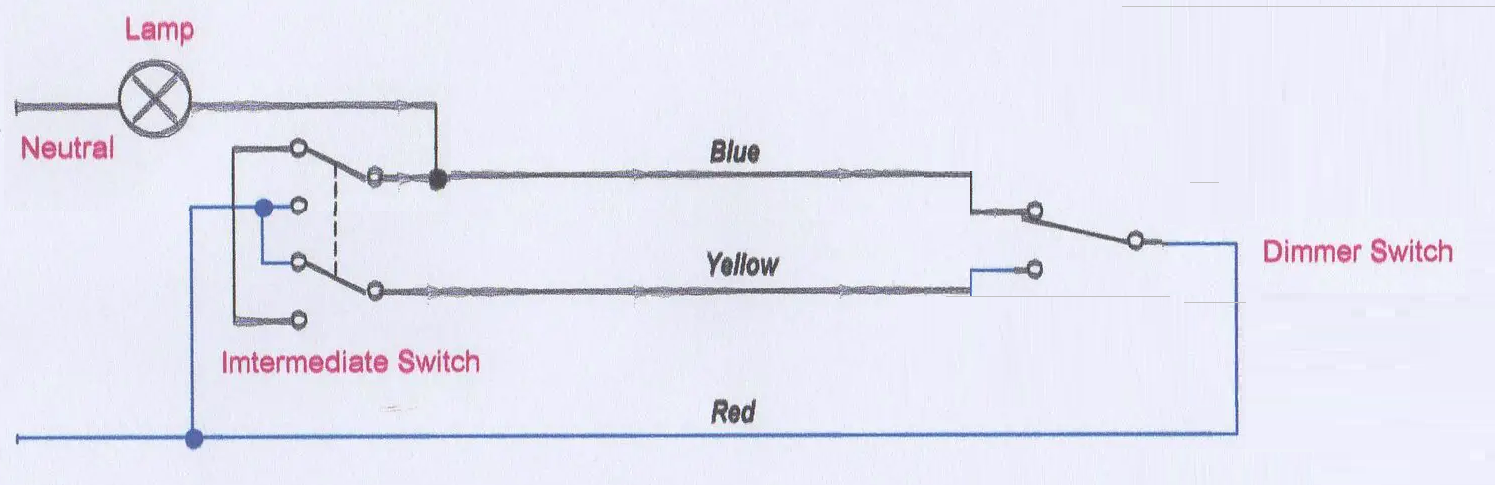

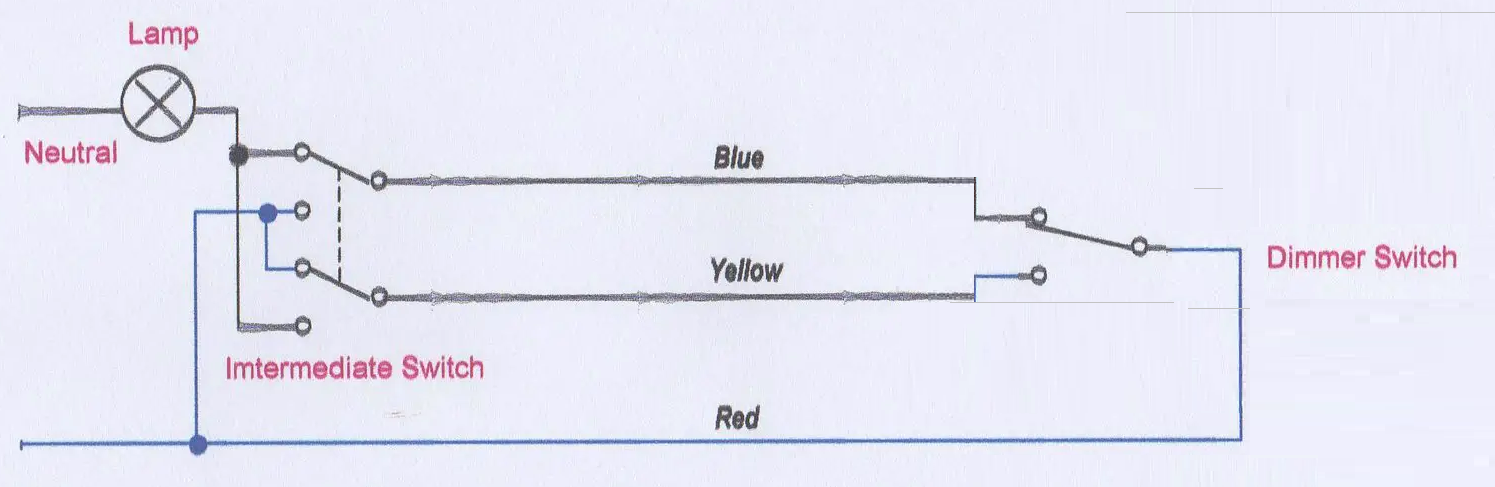

I've used your sketch, and corrected it, to show how it was connected and works correctly
However there is no need to make any changes to the existing wiring at the intermediate switch .
There is no need to make any changes anywhere as the system works perfectly as it was originally wired, all we have to do is find the fault which has developed
In fact, if the Black insulated (Switched Line) wire is moved and connected to the Blue insulated wire, operating the Intermediate Switch with the Dimmer Switch in the position as shown below will have the Lamp ON in both positions of the Intermediate switch.

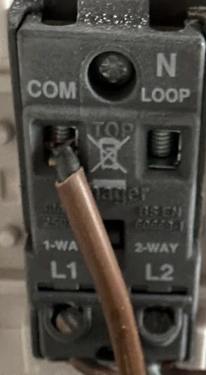

did you meant this with the red in com?

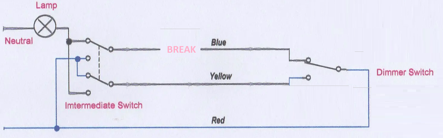

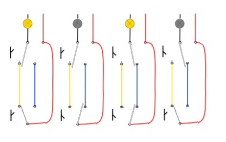

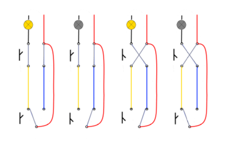

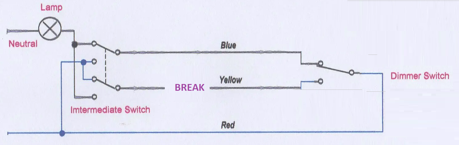

The actual symptom is something like this
0r this
with a break in one of the strappers
Although, reading the posts and diagnosing the information provided, I suspect it's one of the switches. Even further than that, the fact that reversing the reds and black and no light could point to the intermediate switch.

If it where drawn like this
with the red terminated in a different random terminal (let's call it a wago or 'N LOOP') and treat the rest as a 2 way switch, would there be any difficulty understanding the operation?
