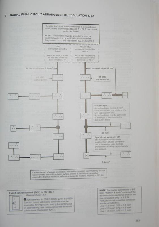

I have found this:
A spur is defined to be a "a branch from a ring final circuit" (IEE Wiring Regulations, Part 2). Consequently, there is no concept of a spur from a radial final subcircuit
Oh dear oh dear....I'm afraid you are wrong. We are not talking about a lighting radial. We are talking about a socket final radial and standard circuit arrangements in the OSG using BS1363 accessories.
If you're talking about the definition and use of spurs and branches, in the context of the 16th Edition, then ban-all-sheds has described the situation correctly.BAS, you are wrong. That's all there is to it.
I don't see the difference between what you call two extensions and what I would call a longer radial.Two sockets at the end of radial would be two extensions.
I think you must have read something wrongly there FingRinal - whilst I don't align with the way he's presented the facts, I believe that what he's presented is indeed factual (with the exception of implying that the OSG can make "demands").If, as you say, a spur is only defined for a ring, why are you using this terminology to refer to radials?
My view is that it's not explicitly allowed, but it's allowed because it's not explicitly prohibited. It makes sense to allow it because it's not unsafe (given any constraints of overall length, voltage drop, etc.).Show me where it allows multiple branches on SOCKET radials as you describe.
( only 1 single or double socket, limiting the max demand to 13A or 26A respectively)
