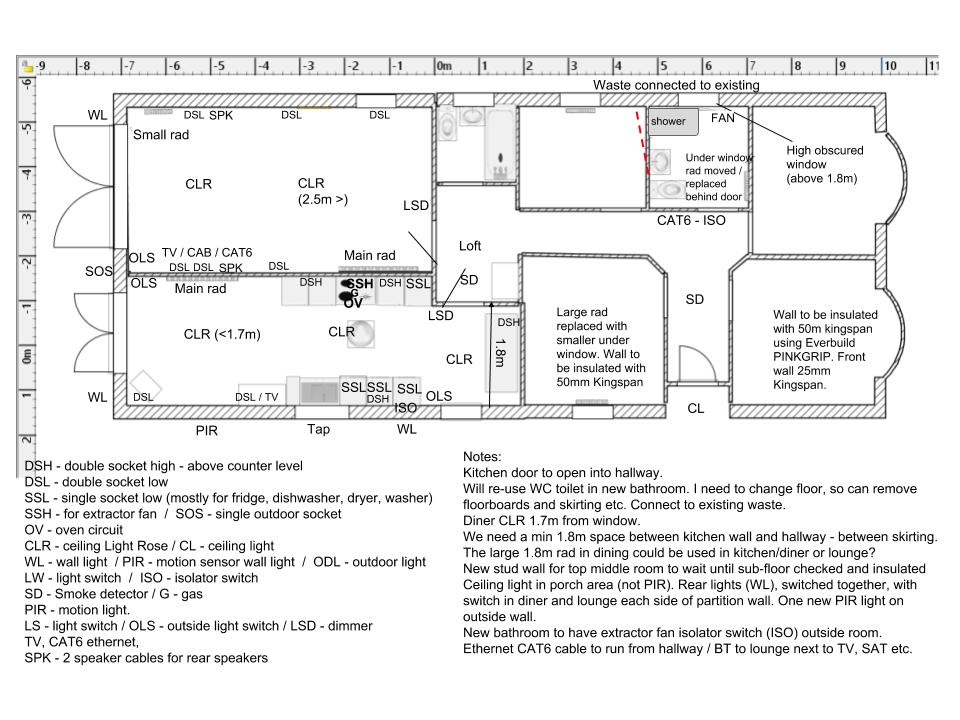

My builder is using an electrician, so not a DIY job, but I am doing the plans, and he asked me to draw up a plan of where I want sockets, switches etc. Also plumbing notes. So, here it is. Anything obvious I have missed?
