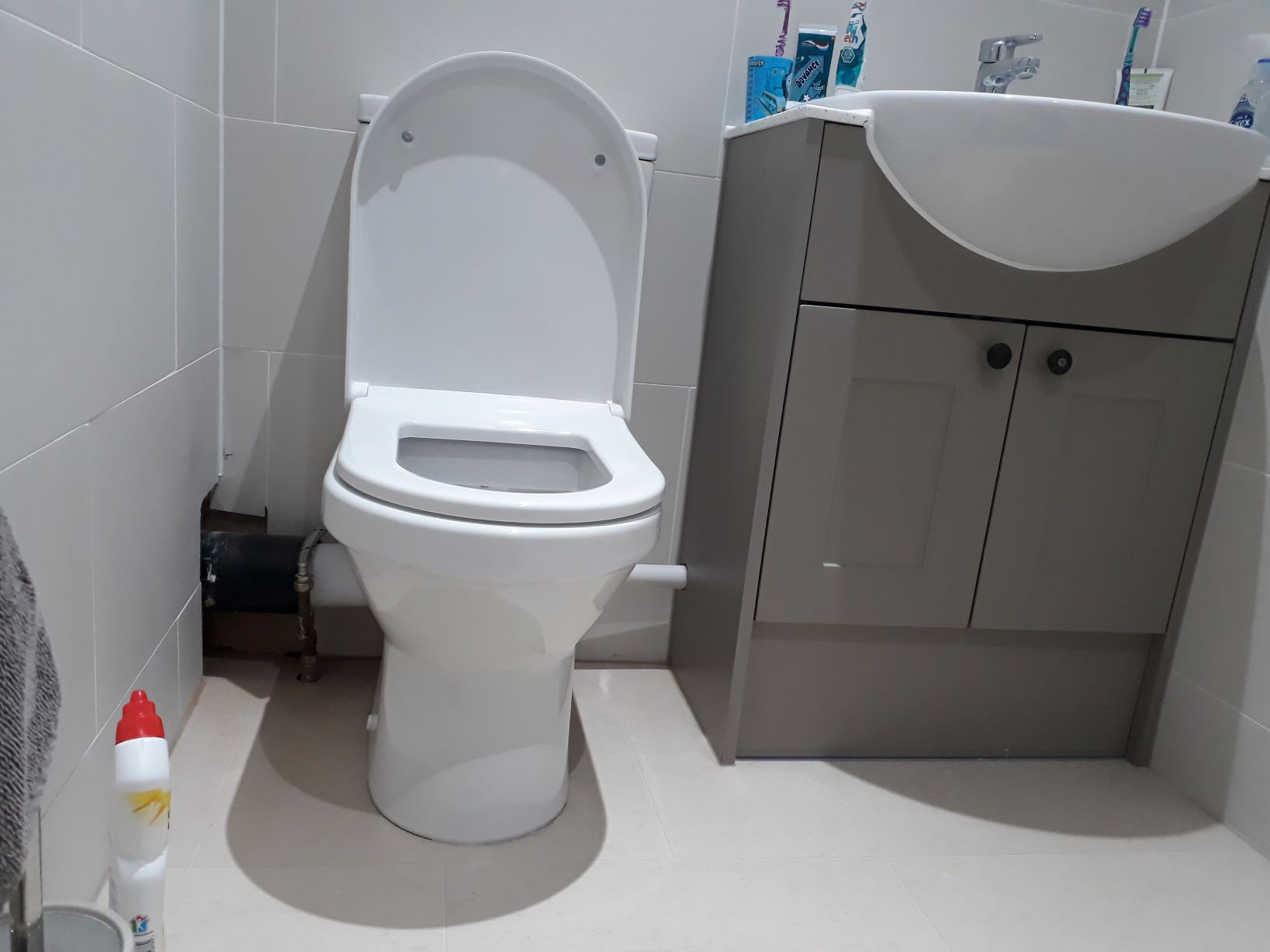

Our toilet is often blocking up. I was wondering if it was worth pushing an endoscope like this down to see if I can find anything, before getting a plumber out.

I should have been more clear in my original posting. The toilet often blocks so that it takes maybe a 1 minute to drain. I then use a plunger like this to clear it but it's a pain to do as one person has to constantly be refilling the bowl while one pumps with the plunger. Thankfully it's not full of brown water, but clear water that takes a while to drain.
Tell us more about the blockage/toilet. Is the pan connector flexible or rigid? Upstairs or downstairs toilet? Anything else blocking up, eg basin next to the toilet? When the toilet is blocked and the basin used does the water level rise in the toilet bowl?

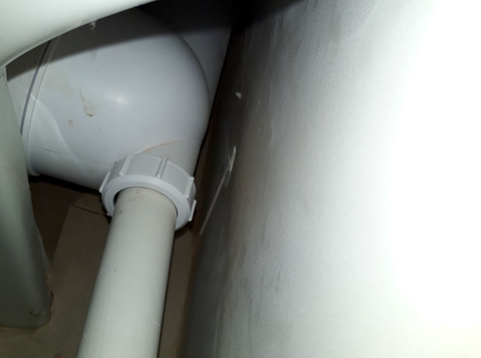

The pan connector is rigid - see photo. I had an inkling that I should be able to do some kind of test with water from the basin, but wasn't sure exactly what. You've clearly said what I need to look for - water rising in the toilet bowl when the basin tap is on. I'm guessing this may give an indication of where the blockage may be? I will try this experiment when it next blocks.

At least your toilet is very easy to remove for access if need be.

When your toilet blocks again and the basin can be used with no problem then the blockage is in the toilet and not down the drain line/soil stack.
My guess then would be an obstacle in the toilet or too much paper is being use.

Your waste from sink enters the elbow of the toilet , if this pipe was pushed in too far and/or cut to leave a rough edge it could encourage debri to build up on the elbow .

Yes to children, no to toilet rim refresher. Fingers crossed it's not a toy. That's good to know that the toilet is easy to remove.
That's interesting. Something to look for if I have to get someone in pull it apart.
