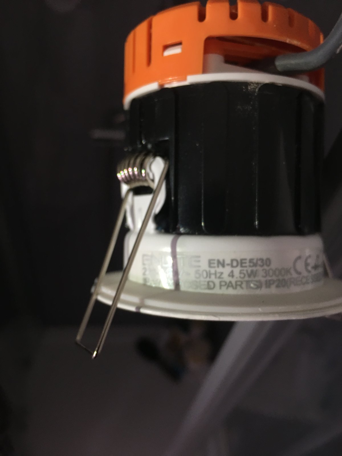

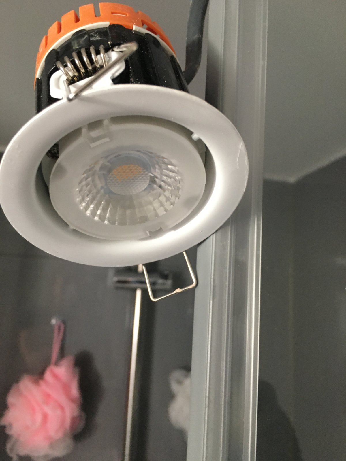

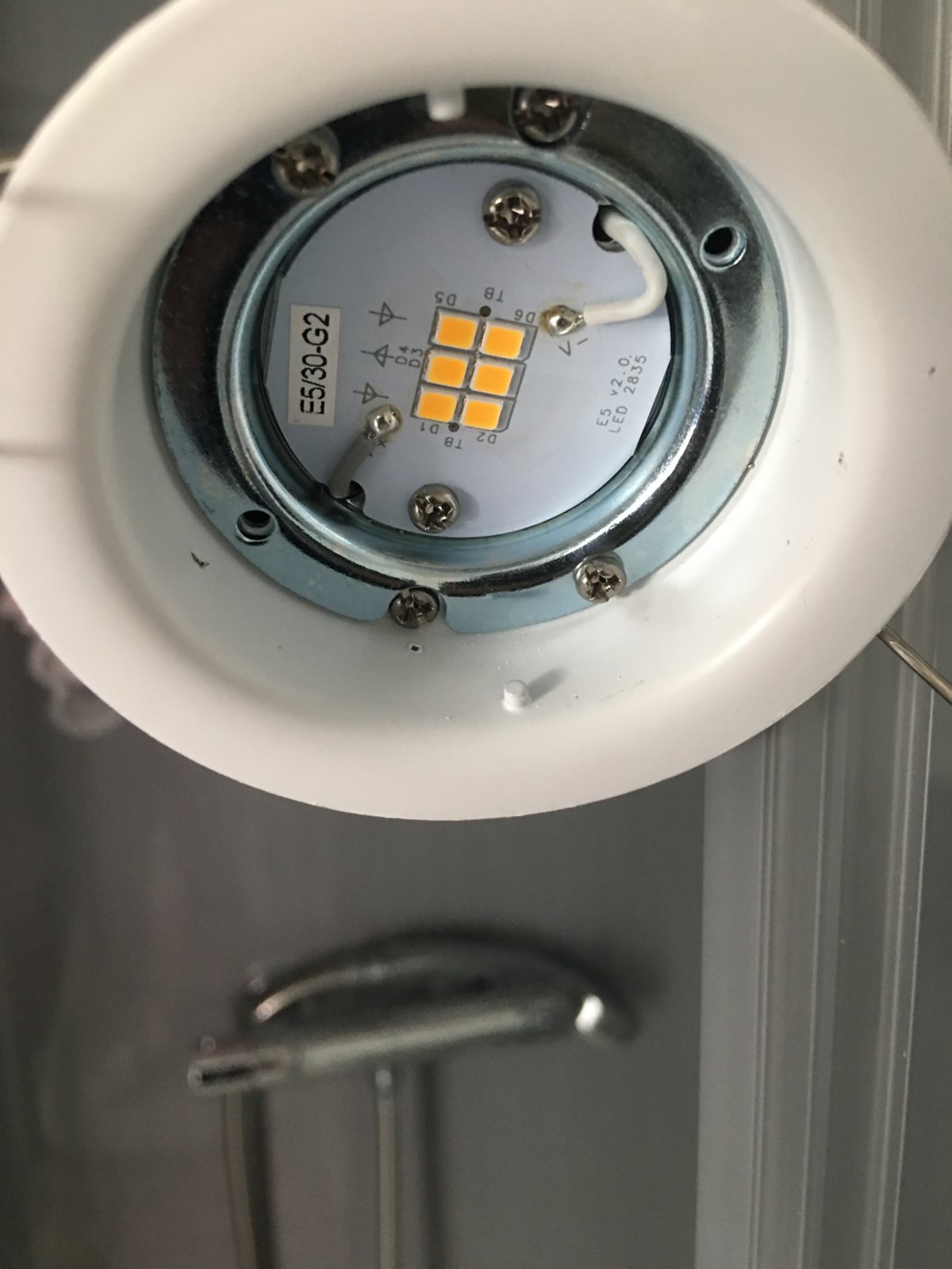

This Enlite downlights had been fitted only for 1 year and 2 of them started blinking recently.
I thought I could just change the led bulb but there is none when I took it down.
Do I have to change the whole unit? If so, how do I do that? It seem to be connected to the wire at the top and not an adapter that I can simply plug in and out.

Changing the entire fitting is required. The wiring needs to be transferred to the new fitting.

Some of the Enlite use push in connections, yours may be similar, under the orange cover that clips off.
ae235
Newer ones now have the wiring into a Plug/Socket arangement
