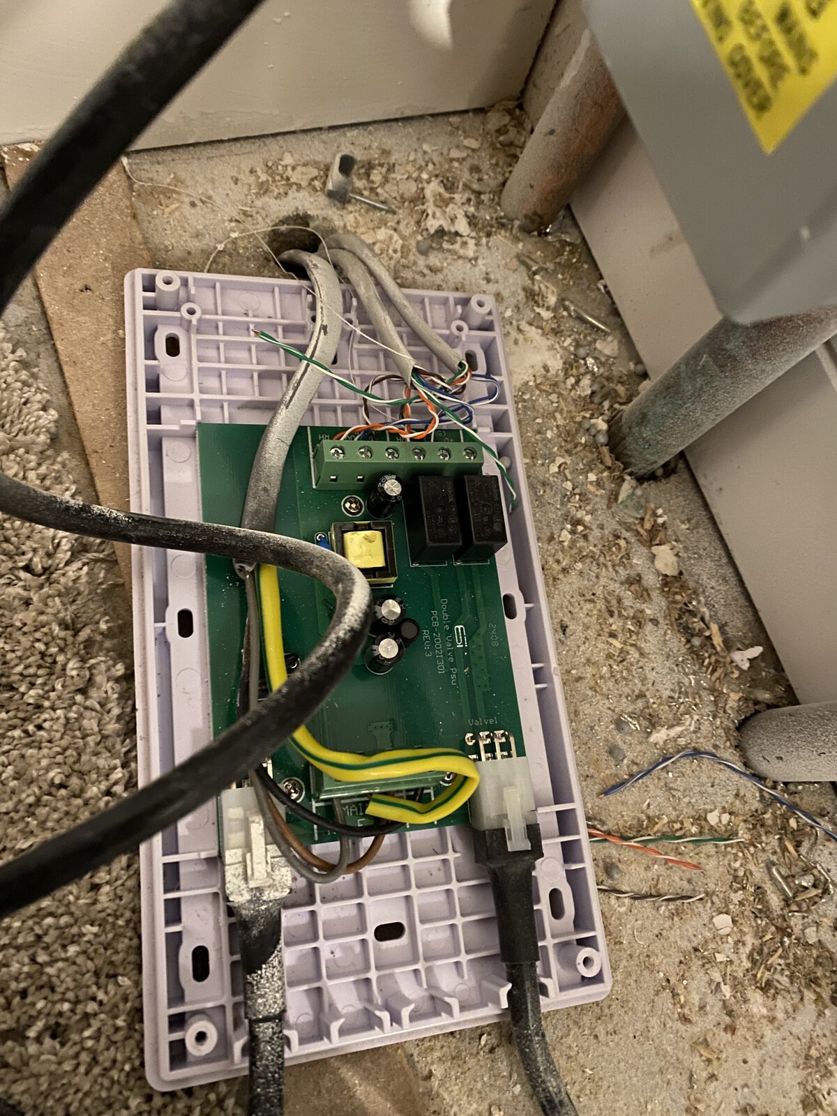

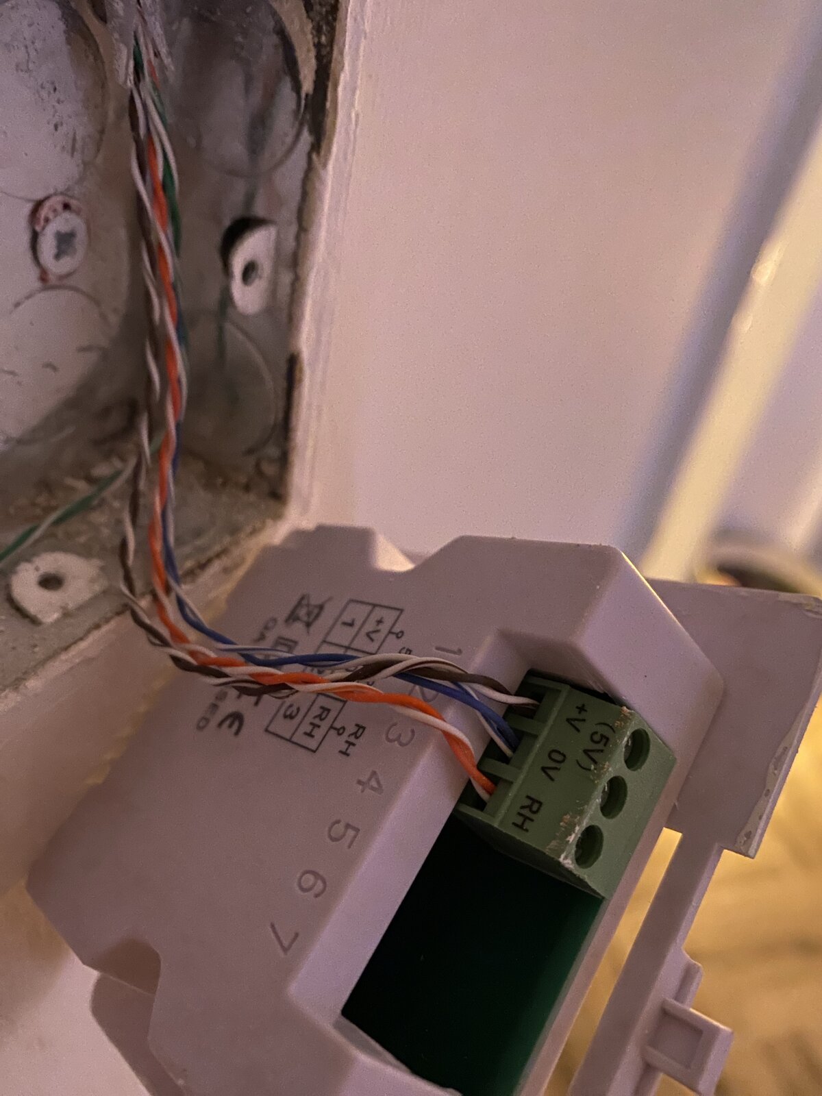

Morning All,
I've purchased a new builder and have ESI thermostats upstairs and downstairs which are mains wired. 5V I believe.
I was planning to install the Tado thermostats myself by messing around with the wiring center but would require the chopping of cables. Before I did this I checked the wiring behind the thermostats and have discovered these are CAT5 data cables which halted my progress and I'm not getting an electrician to do it. Although he's never done thermostats before he said so wasn't 100% sure but was going away to do some research.
Anyway, he has come back to me and said he is going to need to run new wires as the cables that have been installed by the builder are CAT5 data cables which cannot run over 240V. Obviously I don't want new wires run as this would mean cutting out channels etc in the newly built house which the wife will not want.
Someone in a similar position to me but with the correct wiring behind the thermostats has suggested using a Shelly 1 Plus relay as a workaround and mentioned it needs to be a dry contact relay so 240V are not going down data cables as that would obviously be a fire waiting to happen.
Would anyone know anything about that as the electrician didn't really take me on when I mentioned it? Or is my only option to run new cables as suggested?
I've added pictures of the wiring and wiring center for reference.

Or you could decommission your old stats entirely and use wireless stats (i.e. Tado V3+, Hive, Nest, etc.), with the receivers connected at the wiring centre.
Here are some we've done before...
Alternatively, a battery powered stat like a Tado 'Wired' could be used to replace your existing stats, with no wiring changes.

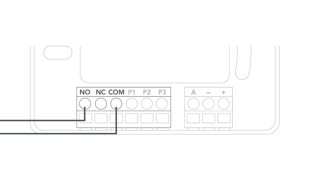

The blue & blue/white wires would go into NO on Tado.
The orange & orange/white wires would go into COM on Tado.
The brown & brown/white wires would go into P1 on Tado.
As earlier, they are battery powered, they do not require 240V.

I'm not entirely sure, but traditionally, a simple heating system may only have a two wire stat that was wired into the wall. It would have a live and a switched live.
Without a neutral, it can't power a mains powered stat - hence there are/have been a few battery operated 'wired' stats, i.e. Tado wired, Hive 'wired', Nest thermostat E etc.
With a wireless system the receivers can be mounted where they are convenient, i.e. near the boiler, or wiring centre; places where getting a mains supply isn't a problem.
There are some wired options that do require a mains supply on the wall, but luckily, you didn't choose one! :)
And I should mention that ESI have gone their own way with their own proprietary extra low voltage system, to try and ensure you keep on buying ESI controls!
They are often found as kits, installed into new-builds to meet part L requirements of the building regs and hence the link in post #2.

No, nothing is coming from the stat itself, it is purely acting as a switch.
The stat is powered by 3 AAA batteries, hence the 4.5V.
5V is coming from the power supply at the wiring centre.
The stat closes it's switch, that activates a relay at the wiring centre - only 5V up to this point.
When the relay closes, the zone valve receives 230V to open and that in turn provides a switched live to the boiler.
All you need to do is switch the boiler/wiring centre off and replace the stat following the comments in post #6

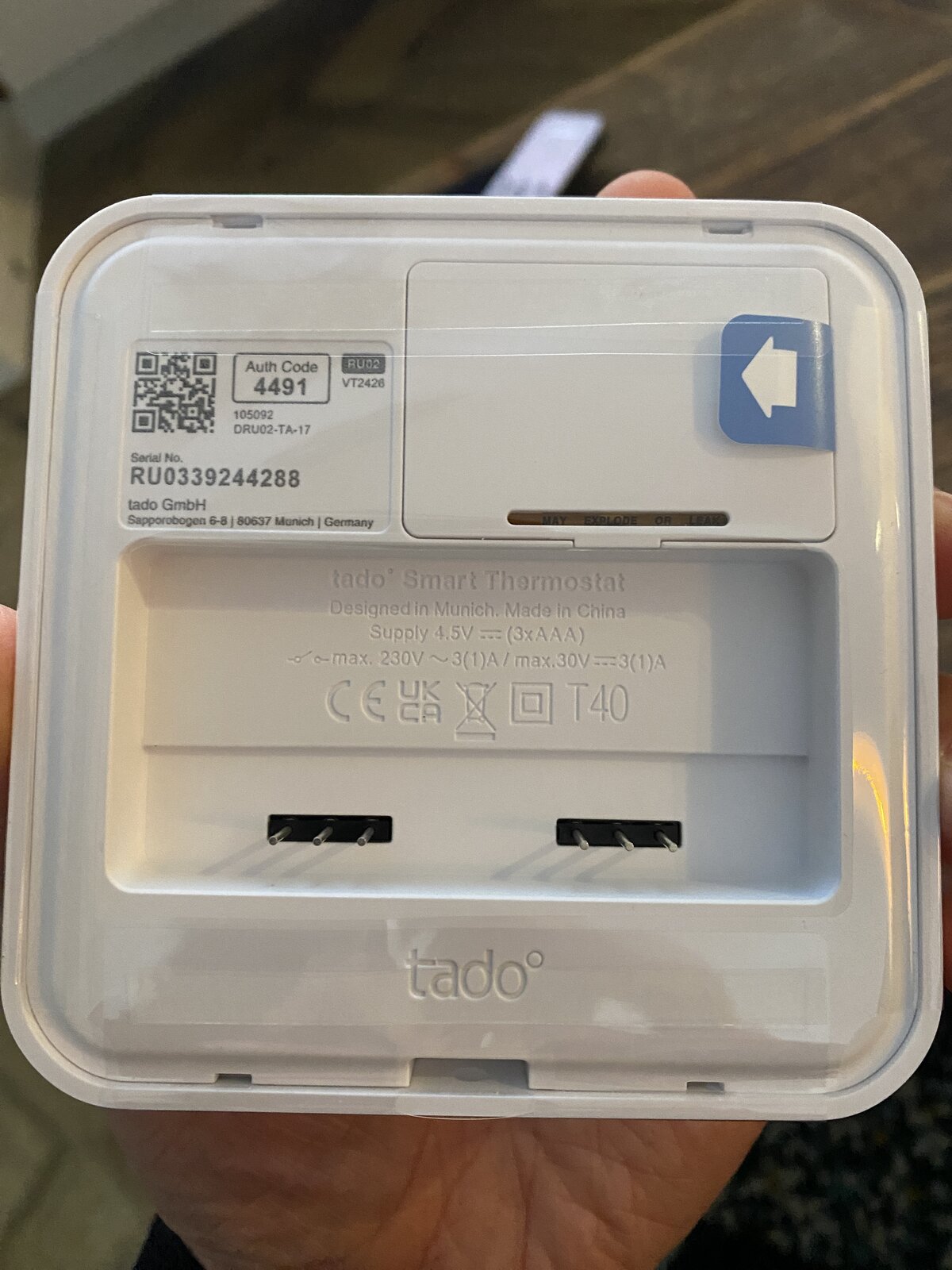

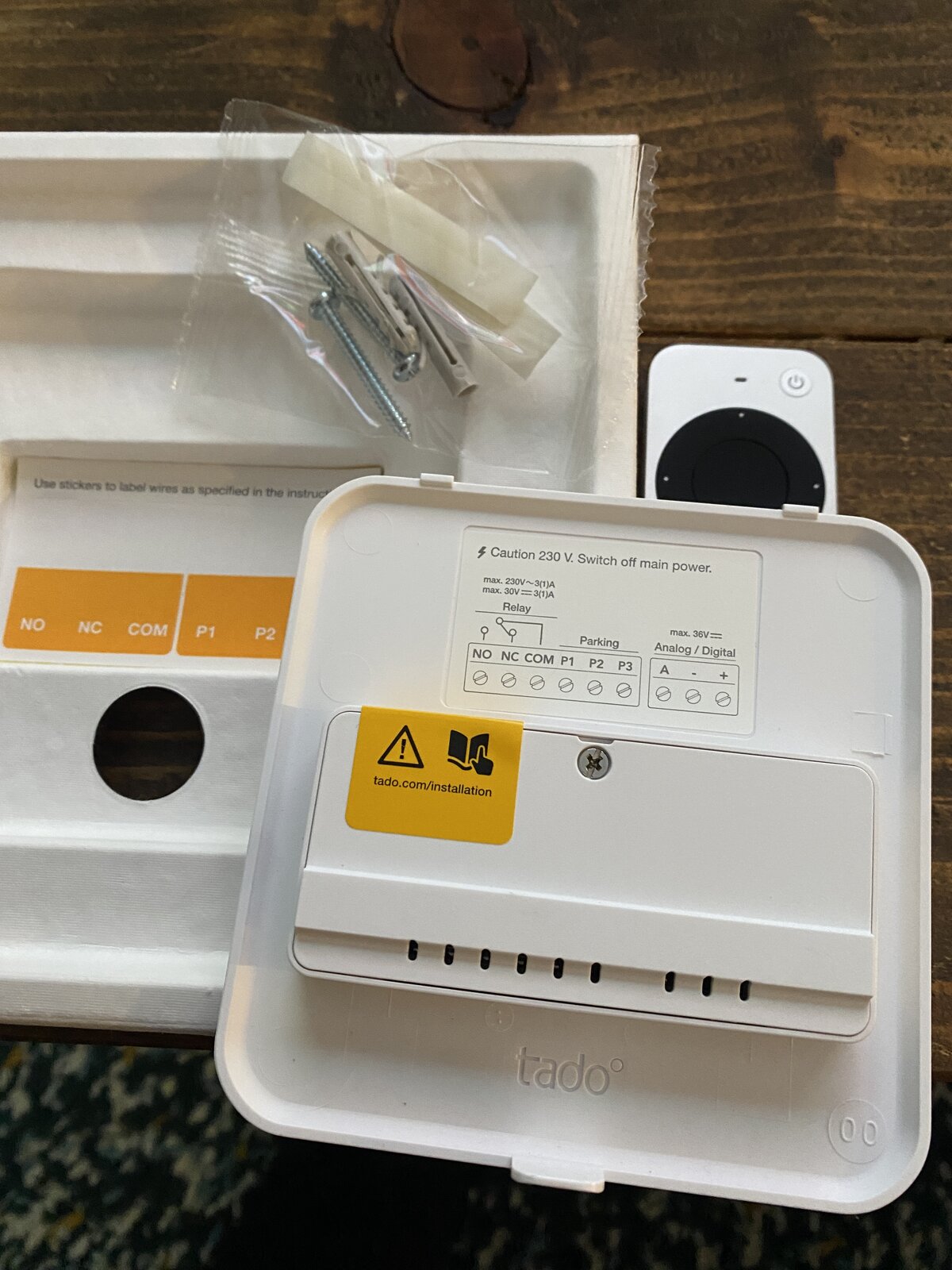

Just checked my equipment and it looks like I do have the correct versions.
