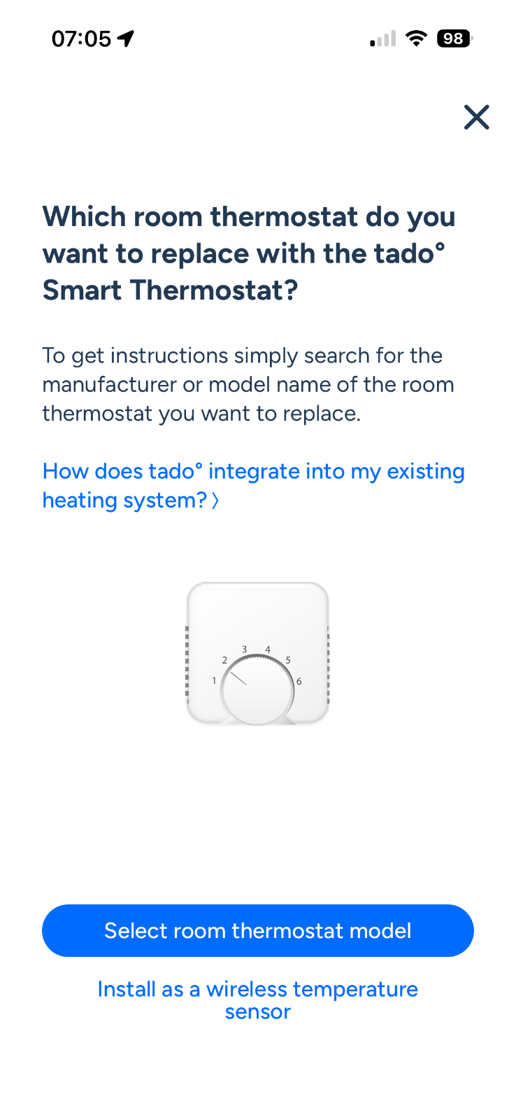

Any chance you can look in your app to see what you told the Tado you where replacing? (Yep I am using V3+ too)
Can have a look if you point me in the right direction as I can’t see anything of use?
Tado > Settings > Room & Devices > Select a Thermostat > Installation Instructions
As soon as you open it you'll see what you replaced.
Not sure if that’s right but if I remember correctly, I selected a variant of an ESI if mine wasn’t listed
