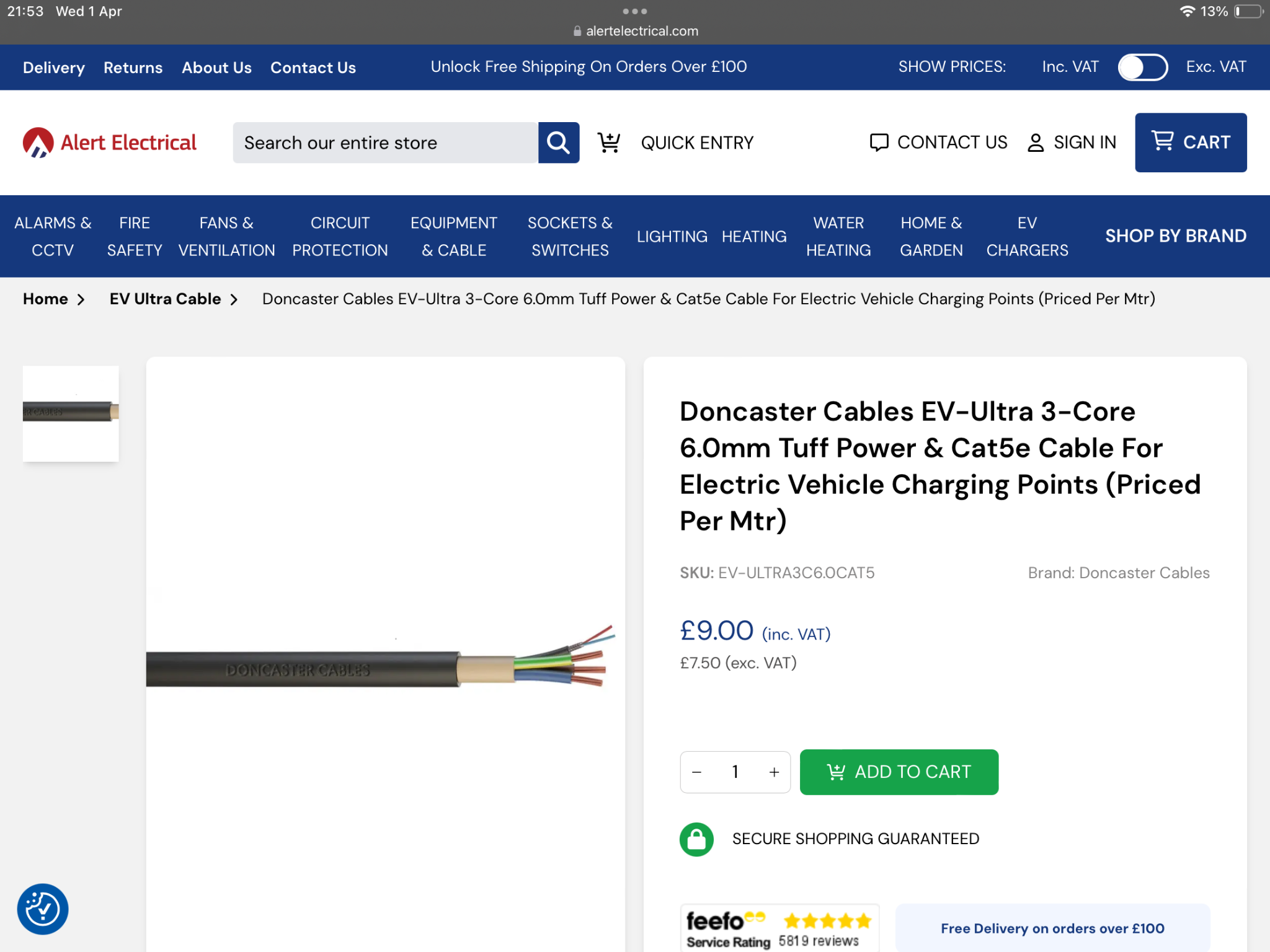

Was looking at some cable today with 3 core 2.5 mm and cat 5/6 in the same cable ….would guess it’s ok
