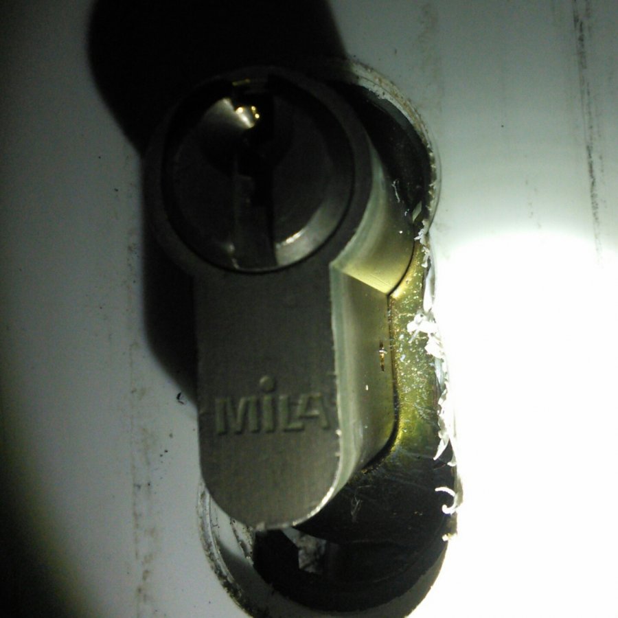

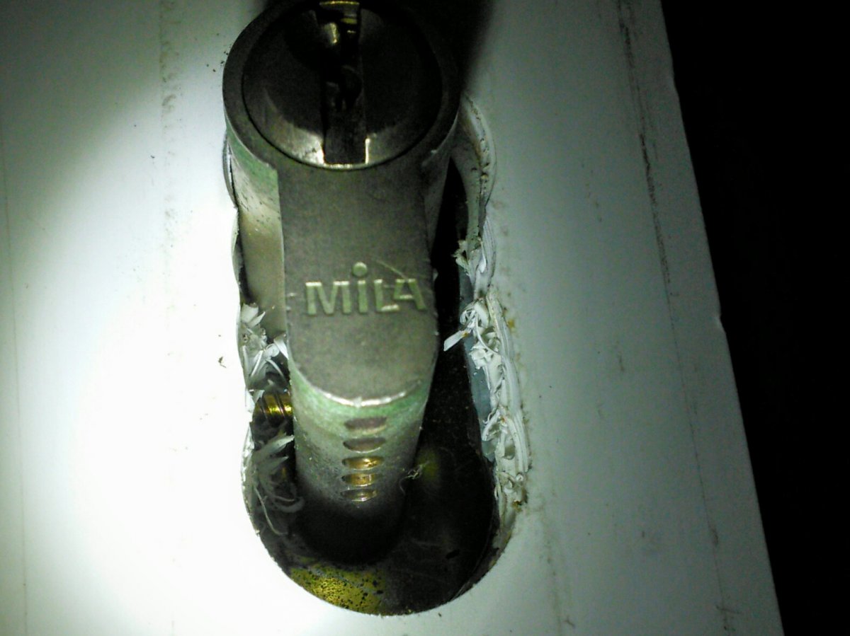

Having had tried to have a better look by drilling for access, someone has definatley put a screw through from the glazed side!
Jeeze!
Thats very odd! Must be a random screw that was meant to just go into the reinforcing. Looks like its definitely a glass out job then.
You could cut it with a multitool with a narrow nosed blade perhaps.
Gaz :)
First thing I thought of was multi tool it out, BUT! That screw is very strange (too big really to be a reinforcing screw) I'm wondering if this door has a mechanically jointed mid rail and that screw is the only thing holding that side of it? Cutting it could cause damage and other problems. I would want to take it out to find why its there first.
On closer inspection of the pictures, it looks like whoever put the screw in has probably damaged the pins in the lock and caused it to fail.
Yes, the door has a midrail. The bottom of the eurolock aligns with the top of the rail, so that's a plausible thought. It's a 30 yr old door, and the lock appears to be the original, so they might have drilled for the cross bar with the cylinder in place?
The lock appears to work properly without any side affects,its the mech thats dead, but I can't find any locks with a hole in the same place for a replacement, and don't want to drill a hole I. A lock if I can help it.
However, im replacing it wit a 3star ts007 cylinder, so no real issues if it is broke!
