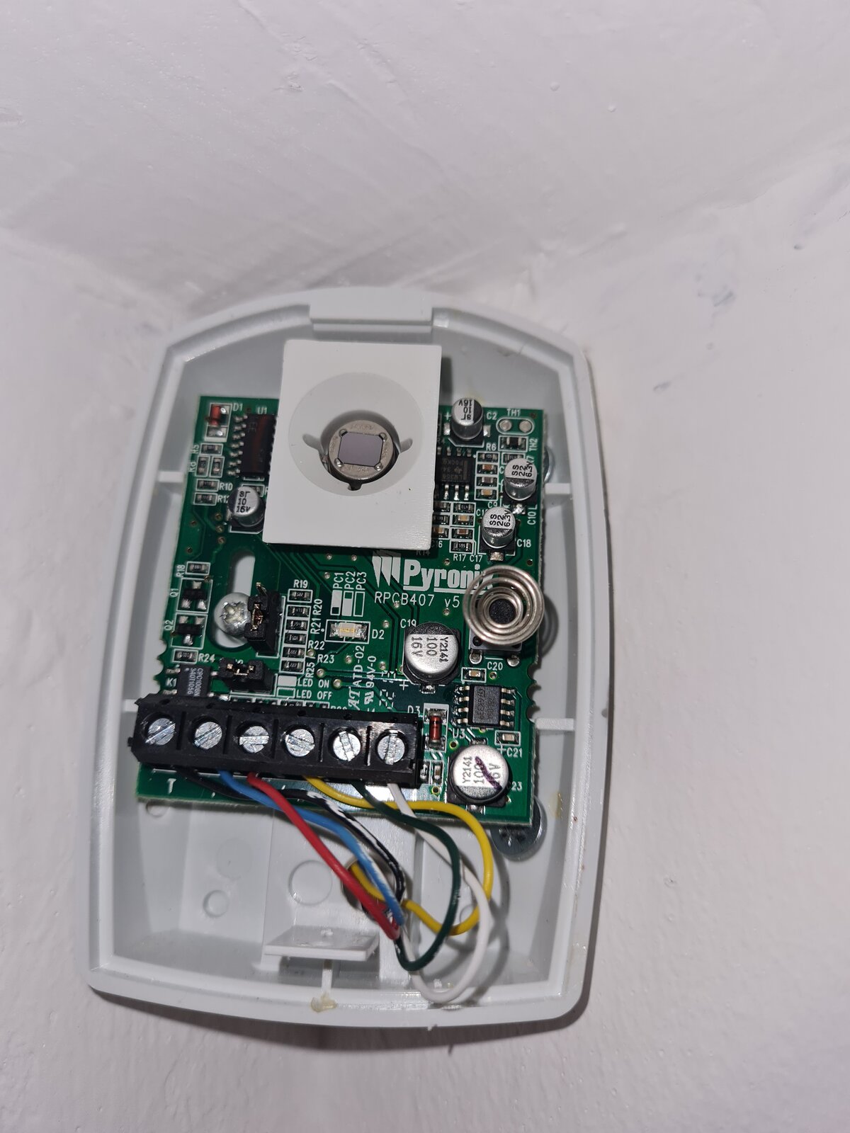

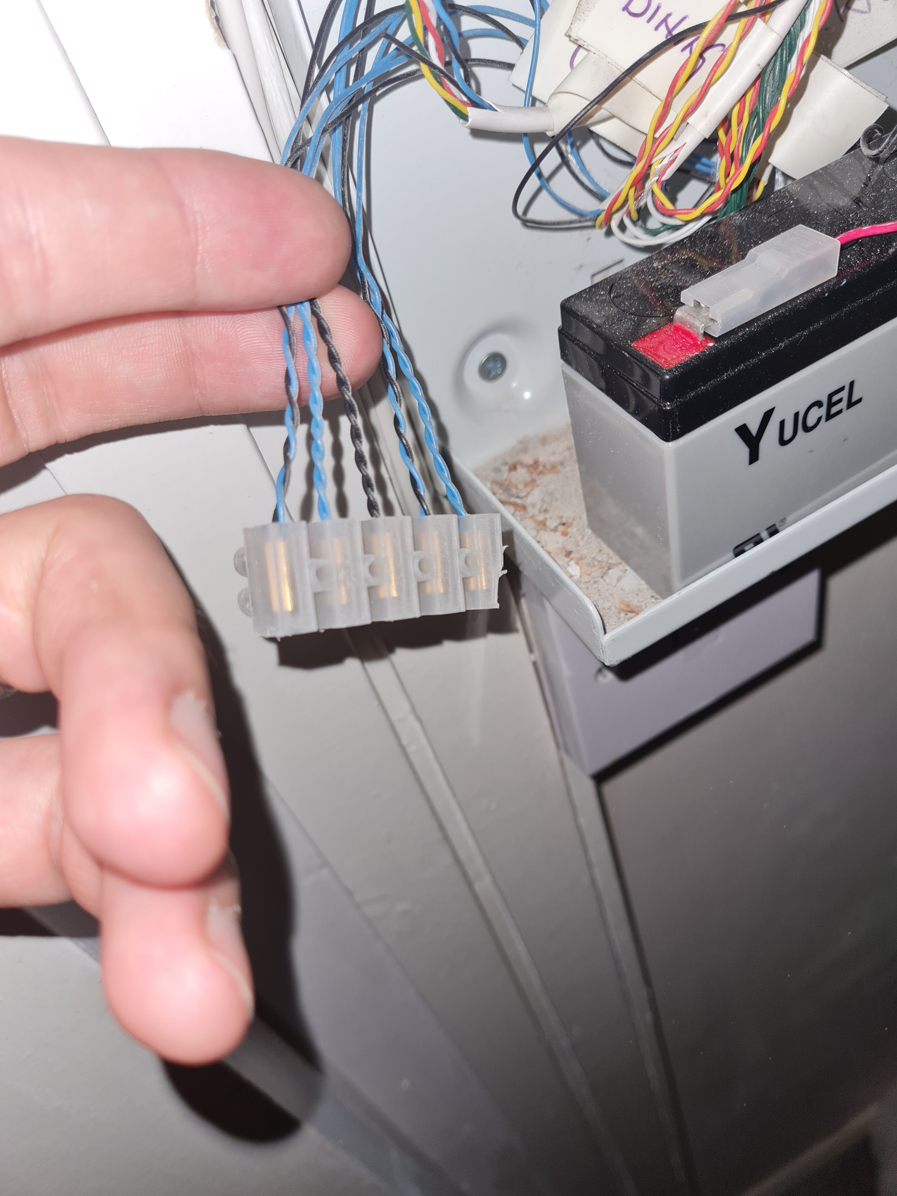

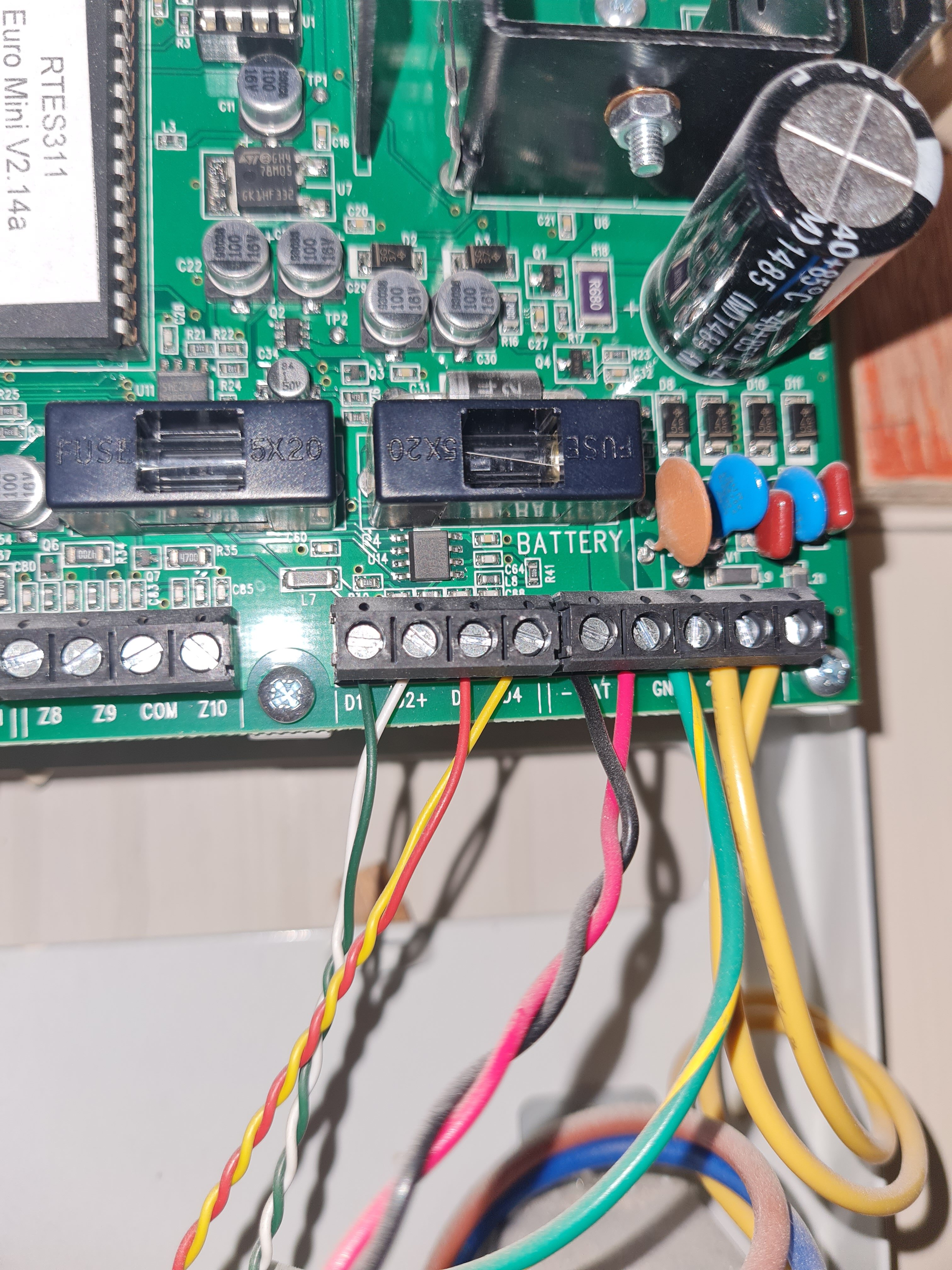

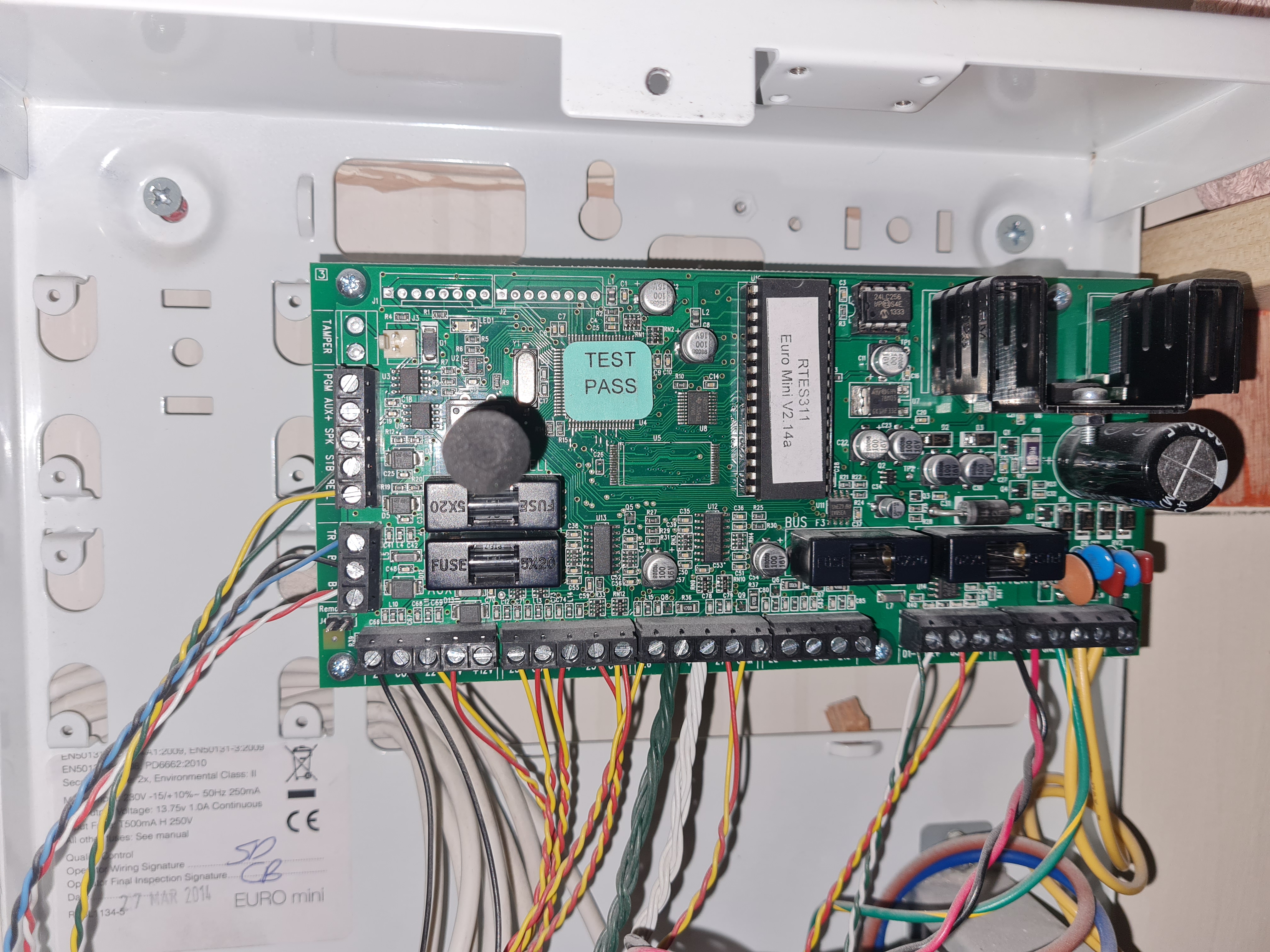

Probably wired incorrectly……post picture of pcb with wires attached , also picture of sensors ….they can be wired two different ways

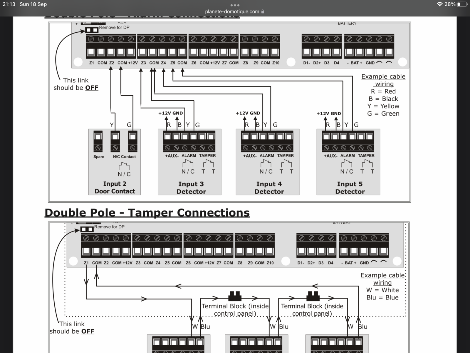

Ok it’s wired as double pole ….you need to check the following
This is how it is wired with double pole …..

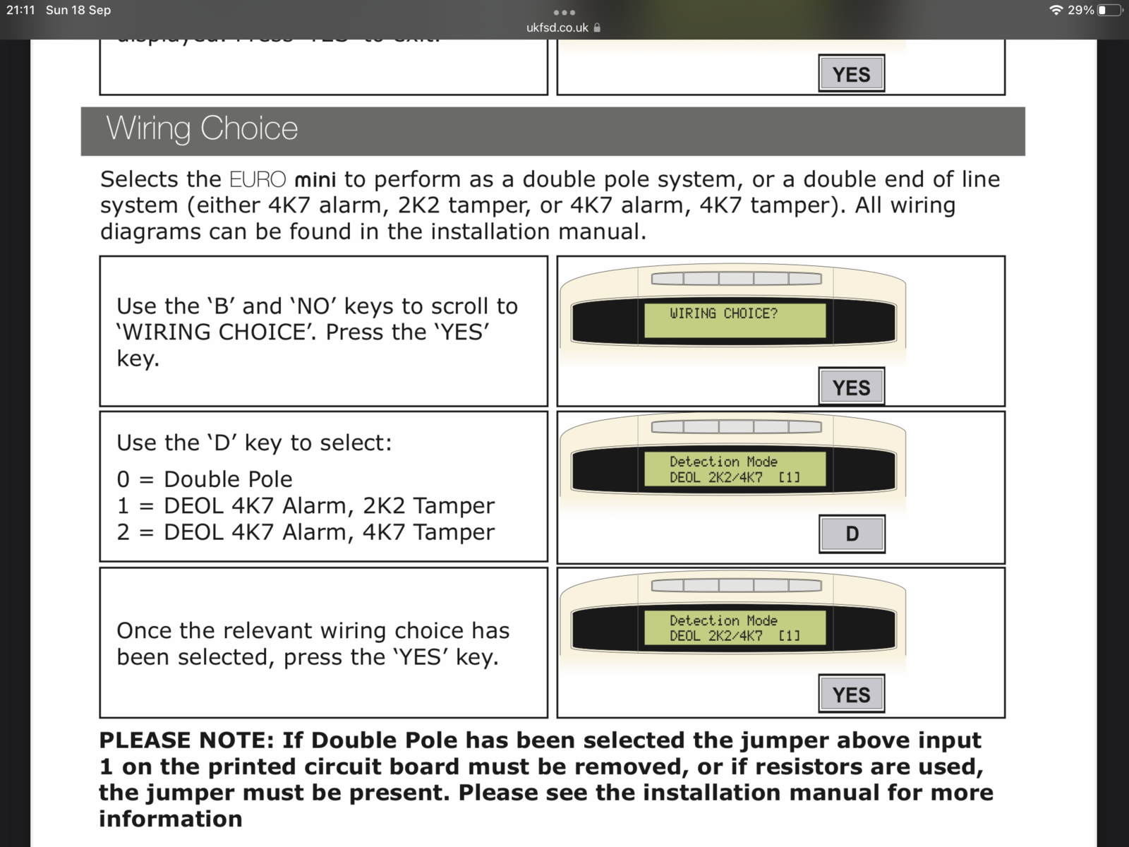

I have changed the set up to Double Pole in the setting, but the alarm is still not triggering.

You need to check zone input programing for each zone.Have any been changed to not used.
ah, yes, all of them were put as unused! I quickly set it to Intruder and it triggered!
