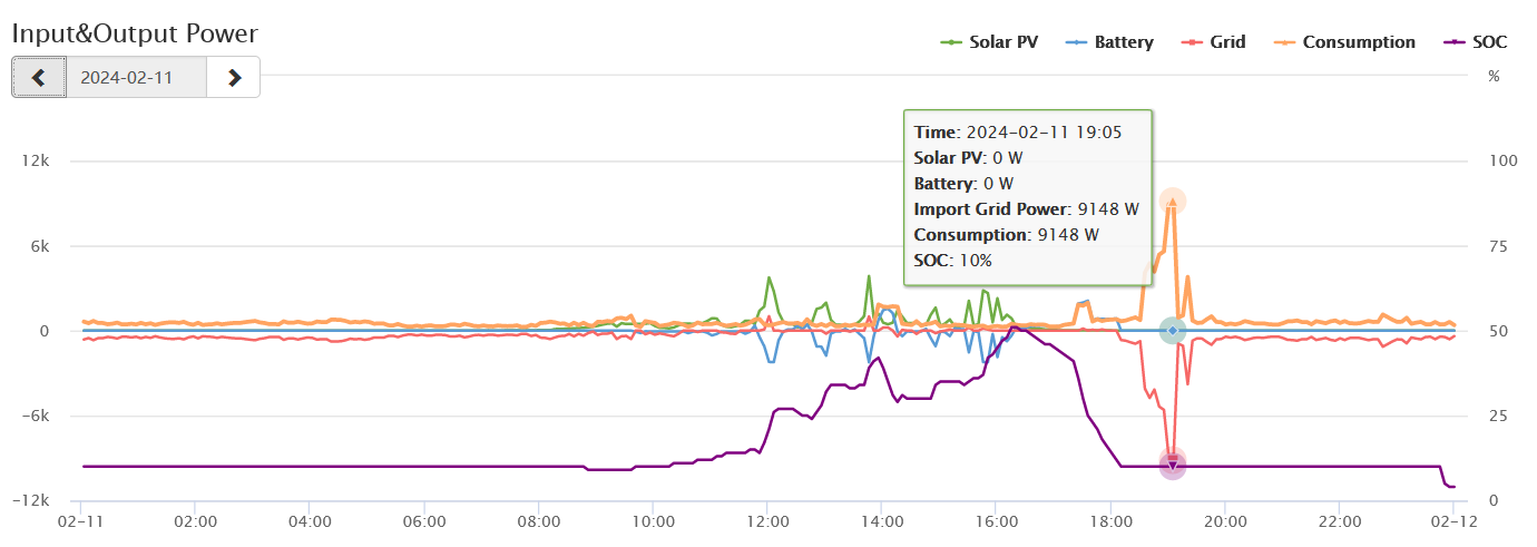

I would agree with @cjcoffin likely you don't need 100 amp, 7 kW = 30.5 amp, I have a three story house with a 60 amp fuse, electric showers, and since I have solar I have a record of what power used when, going back for months, in the main the power used is under 1 kW = 4.4 amps with peaks at 10 kW = 44 amp, and the car charger will auto turn down during the peaks.
Going back to a day where there are high peaks, this is my usage 1707990784704.png SOC = state of charge for my battery, biggest power use in my house is likely the freezers, we have 5 running at the moment, we really need to empty some and turn them off.
