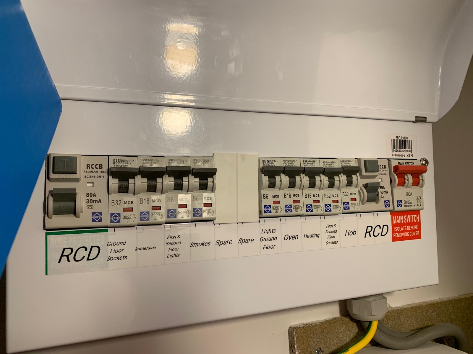

Hi,
My partner lives in a 3 year old new build. She is looking to get an EV charger installed. I have an Easee One that's been removed from another house and would like to use this.
In the garage there is a square black wiring 'box' with a twin and earth cable that apparently goes back to the CU. The house was sold as 'EV charger ready'. I'm not sure of the size of the cable but it is definitely beefy. I'd be very surprised if it's not up to the job.
I've posted a picture of the CU below. Does there appear to be sufficient capacity to wire the charger in? I'll be getting an electrician in to do the job but just wanted to avoid any shocks (!) in terms of extra equipment/labour needed.
I did speak to an electrician informally and all they said was that they'd need to install EV Ultra cable back to the CU as you need the data cables for load monitoring. Is that necessary? I have an identical Easee One at my house and the electrician was fine installing it without any extra monitoring.
The heating is all gas. Usual high power devices on downstairs socket circuit are Microwave, toaster, kettle, instant hot water tap, washing machine, heat pump dryer. Hob is I believe ceramic (glass top, heats up red) not induction.

1) You can't supply an EV from that consumer unit as it stands, as it does not have a dedicated RCD for the EV supply, and I would need to see if the RCD is bidirectional as well.
2) Monitoring the supply power use is not required if you have some other way to ensure it does not cause an overload, supplying the main consumer unit from a 60 amp fuse and both EV and main from a 100 amp fuse, would clearly mean there is 40 amp spare for the EV charger, as to if one can see there is always 32 amp to spare is good enough, is down to the installer.
3) One would assume if 80 amp RCD's are used, your supply is 80 amps or less, looking at right-hand side RCD.
4) One likely will want a low tariff to charge the EV with, and to get the low tariff suppliers like Octopus insist on doing the job of fitting the EV charging point to their spec. Which in the main means a dedicated consumer unit, even if yours could be used.
The Easee one states that it has an internal RCD, does this mean a dedicated one would still be needed in the CU? https://easee.com/en/2023/02/this-is-how-our-rcd-works
I guess any questions around this would depend on your answer to the previous question.
The meter fuse is 100A. Would the two 80A RCDs not each supply half of the circuits?
I am on Intelligent Octopus Go at my own house and Octopus have never asked about the installation - in fact you can use that tariff with a granny charger as long as the car is IOG compatible. The switch from OG to IOG can be done instantly via the app as long as you have compatible EV or charger. Most chargers are not compatible.
So I pay 8.5p/kWh for off-peak, 00:30 to 05:30, but my son pays 6p/kWh and also has charging outside the 5 hours, as Octopus can decide when his car is charged. I have an EV tariff, but not got an EV charge point, my battery is static and part of the solar panel set up.
The RCD type units supplied in most (all?) EV chargers aren't compliant with the british standards because they're not a mechanical switch with a test button. So basically, you do have to have a RCBO but there's no reason you couldn't have one fitted to that CU (I'm not sure whether lewden make a single module double pole but you have 2 modules available regardless).
Looking at the loads on the CU, she has electric cooker, heat pump and immersion heater. Off the top of my head, anything less than a 100A supply (you should ask the DNO to confirm the fuse size) I'd be wanting load curtailment on the charger. However, there's no reason other than maybe aesthetics that an EV ultra cable would have to be run back to the consumer unit/meter box if an adequate power cable is already in the garage, any 2+ core data cable would suffice for the CT clamp.
I wouldn't read into the 80A RCDs - as you say they're only feeding half the board each and it's a maximum current rating, not any indication of design current.

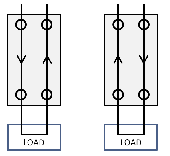

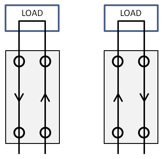

... I would need to see if the RCD is bidirectional as well.
Umm...
With an RCD connected this way round, then for half of each cycle the current flows in the direction shown on the left, and for half of each cycle it flows in the direction shown on the right:
With the RCD connected the other way round, then for half of each cycle the current flows in the direction shown on the left, and for half of each cycle it flows in the direction shown on the right:
So, umm ...
What am I missing?
What am I missing?
In terms of those diagrams, nothing.
However modern RCDs contain electronics which are powered from the supply. it may be a requirement of the manufacturers spec that those electronics are disconnected when the device trips - which would not happen if a supply was connected to the 'load' terminals.
The test button would normally be disconnected when tripped, again this might not occur if the supply was connected to the other terminals.
Some RCDs require the presence of the supply voltage to operate. Others do not.
Whether they are 'bidirectional' or not is up to the manufacturer.

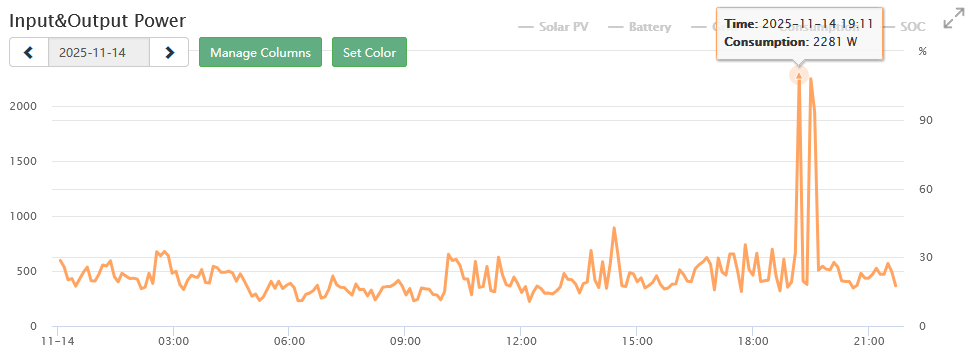

Either the supply, or the total of distribution, should be below or equal to RCD size. I am not saying I agree with that, in my home I can look at the power used, 1763156801663.pngand I know nowhere near the 60 amp limit of the fuse, not that it matters as all RCBO, but in the main the 60 amp fuse is a left over from the days of the Wylex fuse box,
