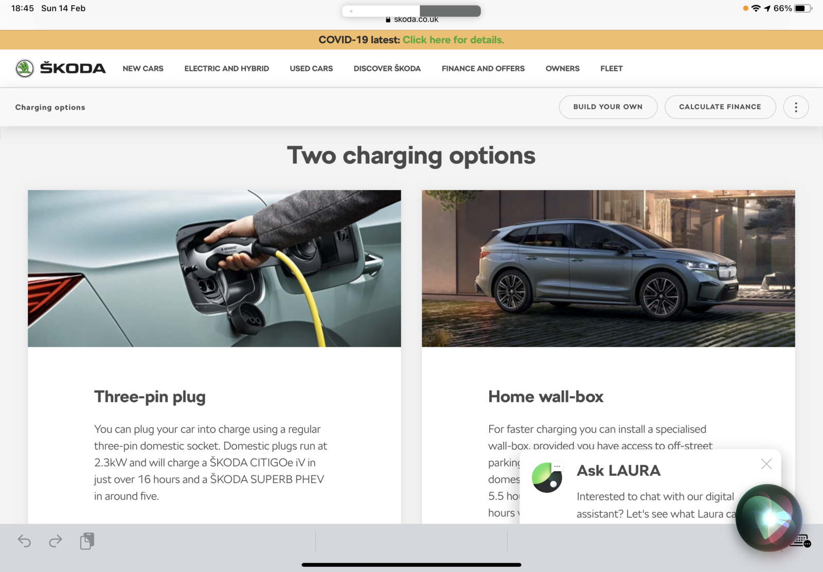

Thanks for the reply. However, looking at the SKODA website they seem quite happy with the idea of using a “regular three pin domestic socket”, saying that it would charge the SUPERB PHEV (what I have ordered) in about five hours, as opposed to three and a half for a “home wall box”.
Are they out of order in claiming this? Or has the technology moved on?
Marketing tripe from people who wrote the website, or the operating instructions from the vehicle manufacturer?

Here’s a screenshot from the official Skoda UK Website.
I’m not doubting anyone on here, but it seems they might be storing up a few lawsuits if this is incorrect/dangerous.

Here’s a screenshot from the official Skoda UK Website. I’m not doubting anyone on here, but it seems they might be storing up a few lawsuits if this is incorrect/dangerous.
It sounds as if the vehicle you're getting must have a very small battery, if it can be charged in less than a third of the time it takes to charge a "SKODA CITIGOe iV". I presume that it must be a 'hybrid' - what is it's alleged 'electric range'?
