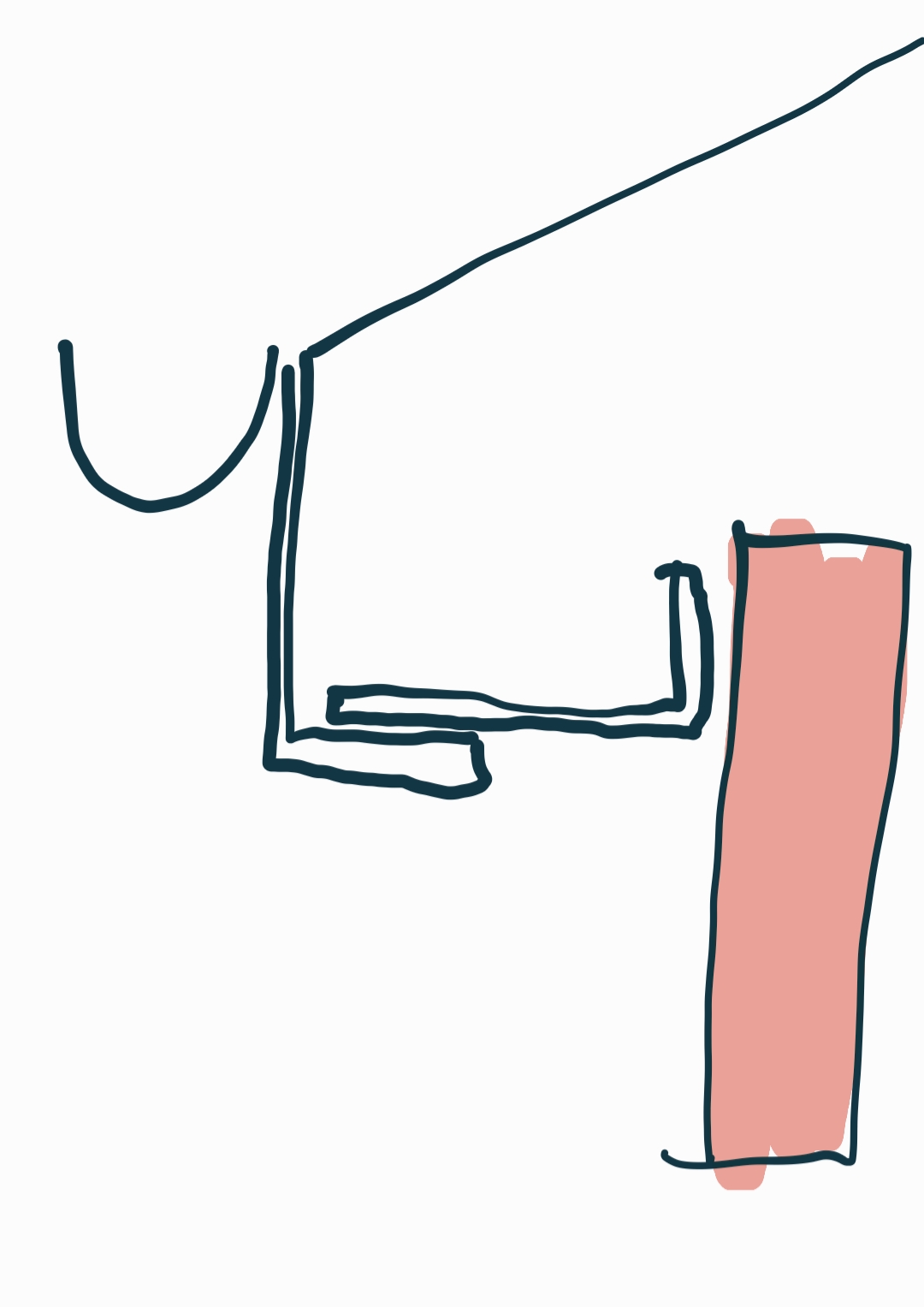

Expanding foam
You should not be seeing daylight between the gutter and the fascia. That will potentially let rain run down the fascia and not in to the gutter - and that will add to that awful efflorescence staining on the wall. Needs some plastic eaves tray it the roof is pitched or a drip forming if the roof is flat
I would use a piece of fascia to cover that. Cut it to a width so that it pushes that fascia out and keeps it straight not bowed like it is now, the 40mm section will go against the wall (stick with silicone) and will be within the soffit, the other end rests on top of that fascia lip again stick with silicone.
That sounds so complex. I got lost halfway through. Will just get upvc trims and use silicone to seal the gap. The builder did a runner, he was meant to finish everything off but wanted money first

Here
I am going to order upvc trims. The gap I need to put it on is around 55mm wide. If I purchase 45mm wide upvc trims would it ok if I join a half of another upvc trim by using silicone? There is 5 pieces in the pack.
That'll fall to pieces in seconds and look sh1t. You probably wont be able to buy the exact size you need, so buy bigger and cut it down and install with the cut edge hidden.
Ok thats fine. That is true. It wouldn’t look nice. Will get the 65mm upvc trim so that it covers it all in one go. The gap us roughly 50/55mm
