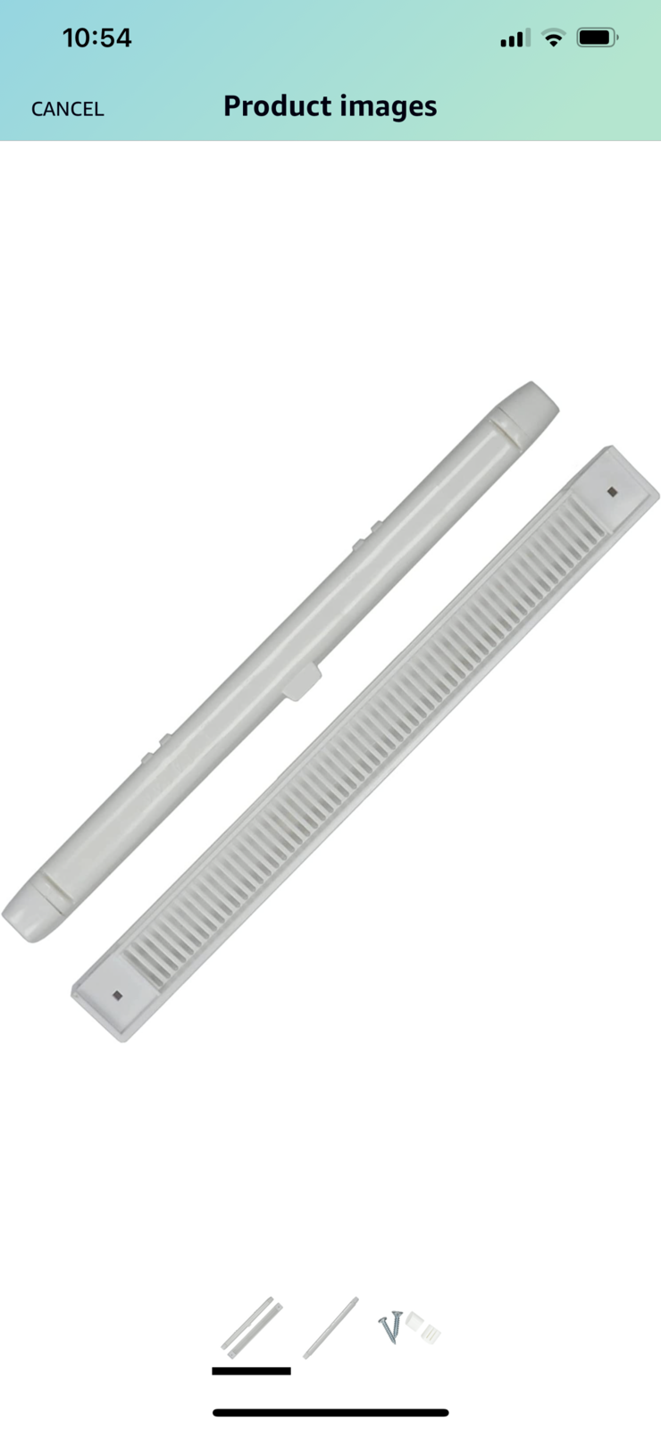

Hi there. The upvc trims look alright, Need a more wider trim but I was told by a builder to purchase these ventilation trims. Are these better? It provides ventilation which is good.
Those look like weep vents for uPVC windows.
You are right. Ill just reorder a wider upvc trim. Will it be alright if its blocked off all without any ventilation holes etc.?
