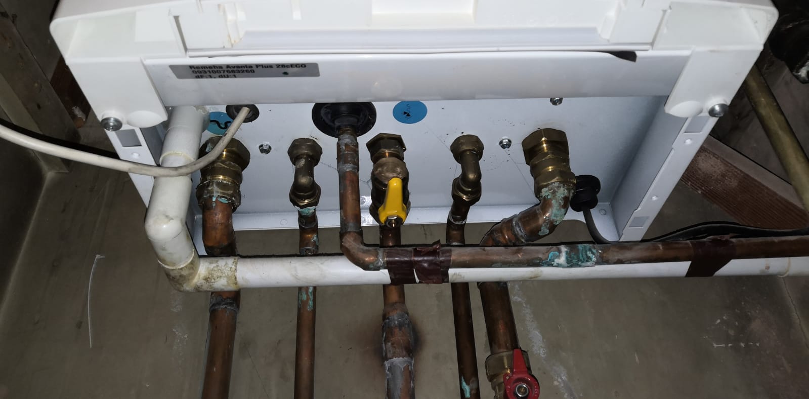

Expansion vessel replacement, do I need a registered Gas person to fix it, or a 'handyman'

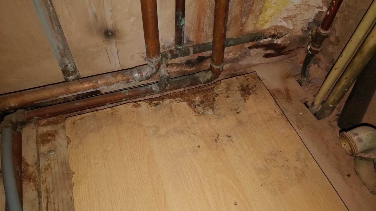

actually. had a proper look and with proper light on the situation, underneath it looks like this..
maybe this is the issue?

Nozzle
There she is on the right.
meaning the leak? and the oxidation?
Id have imagined the floor would have to be quite wet with a lot of loss of water for pressure to drop, or is that not always the case?
It's hot water {sometimes} landing on hot pipes, most of it will evaporate only a small amount pooling on the floor or joists. I concede if it's falling onto a plasterboard ceiling, you'd see it mark through.
To me it looks like the 28mm elbow to the right has a build-up of corrosion indicative of an active leak, and where it has dripped to the 15mm below (which is the relief line to outside) there is a sleve which also has corrosion products, but there's an area where there is none. I think that's because the excess flux has been washed off here (on account of the drip from leaking compression fitting above).
Nozzle
Ahh got it. Thanks. you could well be correct.
Having tidied up the boiler cupboard, the floor underneath has some damage to the chipboard placed underneath. but i remember that being damaged a little bit when i moved in 7 years ago, but guess its gotten worse.
I guess i was expecting a lot more water damage to show for the lack of pressure.
So maybe after all, i don't need a proper gas engineer for this, just someone to fix the pipes and then wait and see what happens in the coming months.
if still pressure issues, then get a gas engineer in to check the expansion vessel?

Yup, that's too high to check the pressure relief valve (prv) outlet. Only other way to check would be to loosen the prv connection at the boiler but that may be a step too far for you.
Keep the system cold and bring the system pressure on the gauge up to 2.5 bar and then run round all the connections/fittings under the boiler there with a coloured loo roll/blue roll and see if any parts get the paper damp.
Then use a radiator bleed valve to reduce the pressure back to 1.5bar.
