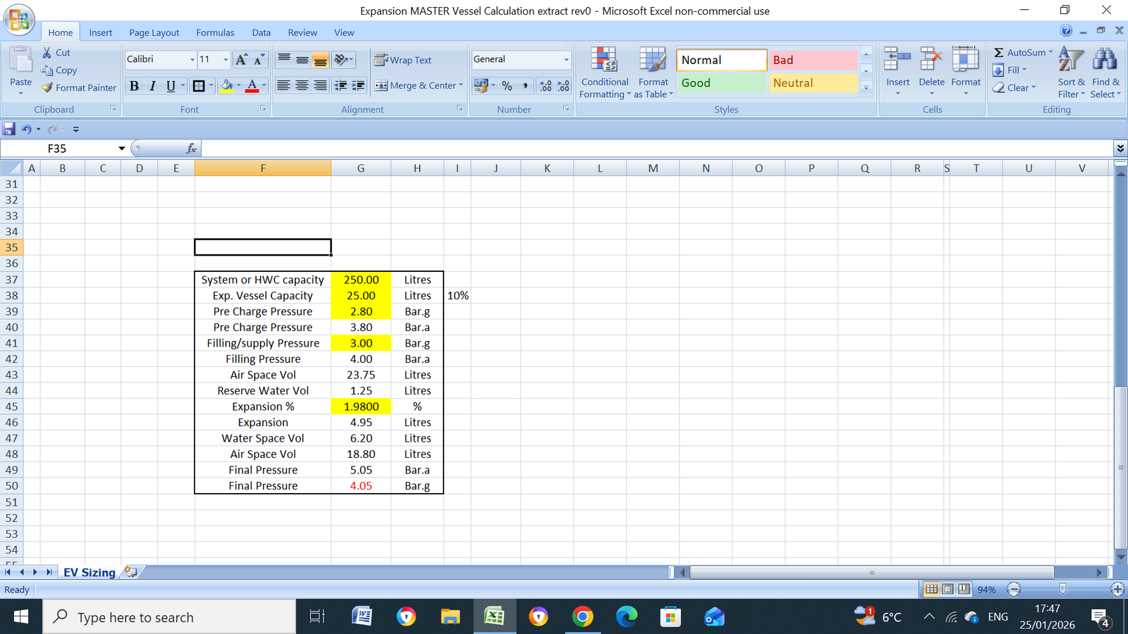

A stainless steel UV cylinder with its pressure reducing valve set to 3.0bar (with a recommended precharge of 2.8bar) and a EV sized to 10% of the UV cylinder's capacity will have a final pressure of just over 4.0bar if fully heated from 5C to 65C, its expansion relief valve might be typically set to 6.0bar and its T&PRV set to 8.0bar, example, below, of final pressure.

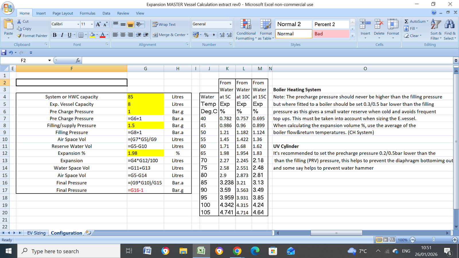

Can't obviously speak for @Madrab but IMO the EV diaphragm should never bottom out, this is why a precharge pressure 0.2bar less than the PRV (pressure reducing valve) set pressure, usually, 3.0bar, is recommended, some say it also helps to prevent water hammer as the EV acts like a spring to even out any pressure fluctuations. The dynamic pressure might well drop to ~ 2.0bar at very high flow rates especially during periods of high usage, at certain times of the day. If you set the precharge to 2.0bar and leave the PRV at 3.0bar, then the "worst case" scenario is that say during the night while reheating the cylinder when the PRV pressure might well be 3.0bar is that the final pressure after a full cylinder reheat will be 4.58bar instead of the above 4.05bar. If you know that the static pressure will never be higher than 2.0bar and you set the precharge to 1.8bar and the PRV slightly higher than the static pressure, to say 2.2bar, then the final pressure after a full cylinder reheat will only be 2.81bar. Of course, in all cases, the cylinder pressure will fall to the pressure after the PRV once you run off the expansion volume, almost 5L, if a 250L UV cylinder is installed and pro rata for other UVC capacities.

Unfortunately I cannot post a excel file on here but anyone interested can build their own spreadsheet from the screenshot, then just change the values in yellow to suit their own requirements.
