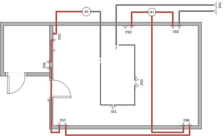

So, I've spent quite a bit of time today crawling around the eaves of my loft, attempting to trace the route of the socket cables and have produced the diagram above showing what I found. The grey lines are grey 2.5mm cables, which I suspect are from the original house build and the red/brown lines are white 2.5mm cables, which I believe were added as part of the loft extention, 16 years ago.
The sockets DS1, DS2 and SS1 are located on the 1st floor in bedrooms and each of these has two grey 2.5mm cables entering the backbox from above. I have been able to confirm the bedroom socket DS1 is definitely being fed from the loft and I have traced the two grey cables, one of which goes to a loft socket (DS3) and the other disappears under the floor and I'm unable to track it due to insulation, hence the question mark. There is another grey cable from under the floor, which connects to a white cable via JB2.
There's a question mark against the white cable between DS5 and DS6, and also DS6 and DS7 because I can't follow these white cables under the flooring, but I'm pretty sure they are following the suggested route.
When we bought the house 21 years ago, we paid a little extra to have the loft "formed" and also to have electrics made available to the loft, so I suspect this is why the grey cables and some of the bedroom sockets are fed from the loft rather than from below the bedroom floors.
My suspicion is that DS2 and SS1 are being supplied by the original grey cables, but I can't confirm that.
So, it would appear that DS4 is a spur and possibly not the end of a 5 spur radial circuit connected to the ring circuit. This is the only socket in the loft with a single cable, hence the reason I originally thought it was the end of the spur. It does look as though the other loft sockets are part of the ring circuit that runs around the 1st floor bedrooms.
Does this seem a reasonable assumption? Is there any way I can test this?
If, for example, I disconnected one of the cables at DS7. If this was part of a ring circuit, the other cable should still be providing power, so the socket should still work. Likewise, all other sockets should continue to work?
So this looks safer than you said in your first post, as there is only 1 spur.

Just to say - if this is the situation, then all is fine and proper.

Yes, even with my limited knowledge I feel happier about the wiring than I did this morning, so it was worth mapping it out. I also suspect the grey cables do run to SS1 and DS2 given that both these sockets have two cables and both enter from above.
So, with the assumption that this is one large ring circuit, including 1st floor bedrooms and loft (with a single spur to DS4 - I wonder why they did this!), can I prove this by disconnecting one of the cables at, for example, socket DS7? If it wasn't a large ring circuit, wouldn't this socket, or possibly socket DS6 or DS8 stop working? If they all continue to work doesn't this prove it is a ring circuit?

If you ever have to do that again, you can buy cable tracers. They come in two parts, a signal injector and a receiver. You just connect the injector to the end of the cable you want to trace, then follow the hidden cable with the receiver. The receiver works for several inches away from the cable, even buried in walls.
