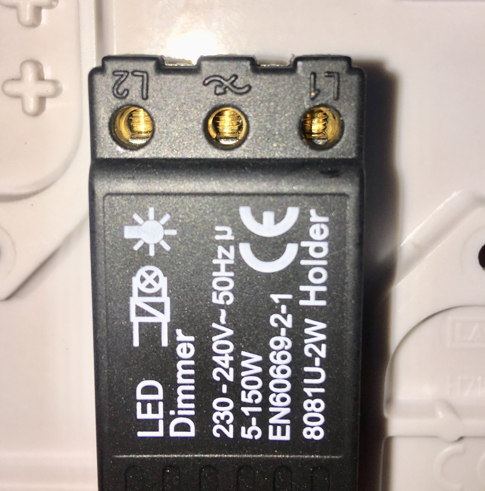

Old light switch had L1 L2 on the back of it.
Red wire was L1
Black wire was L2
The earth wire was connected to the metal box in the wall.
I am now changing this for a dimmer switch,like in photo supplied.
There is L1 L2 & a wavy line symbol
Do i wire this dimmer switch like so,
Red wire in the wavy line symbol & my Black wire in the L1

Yes
