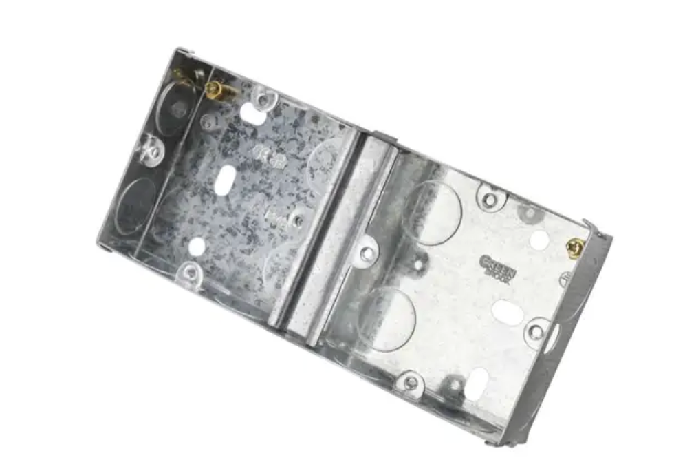

In our old house in the bedroom there are 2 single sockets either side of the bed that are basically an extension lead running under the floor popping up next to the only socket in the room with the extension lead terminating in a 3pin plug.
I wish to replace this with a proper fused spur to the bedside sockets.
Are there any double sockets with one side being a 3pin and a fused switch other than the 45amp cooker ones, or do I have to install 2 single boxes?
The existing socket is a ring btw
you could use a face plate and modules
You will require a decent depth backbox, if you find you have to change that Id suggest that simply adding an additional single for a standard fused switch may be easier.
You could fit the FCU next to the exiting socket then feed the bedside sockets from that.
Dig out the existing single box and fit one of these
Fit a 13amp FCU on one side and feed the socket (and the add-ons) from ther load side of the FCU.
Simples

Thanks everyone. I did consider extending the ring but, tbh the floorboards are very old and lifting them without damage isn't worthwhile. I was under the impression that any spur off the ring should be fused.
