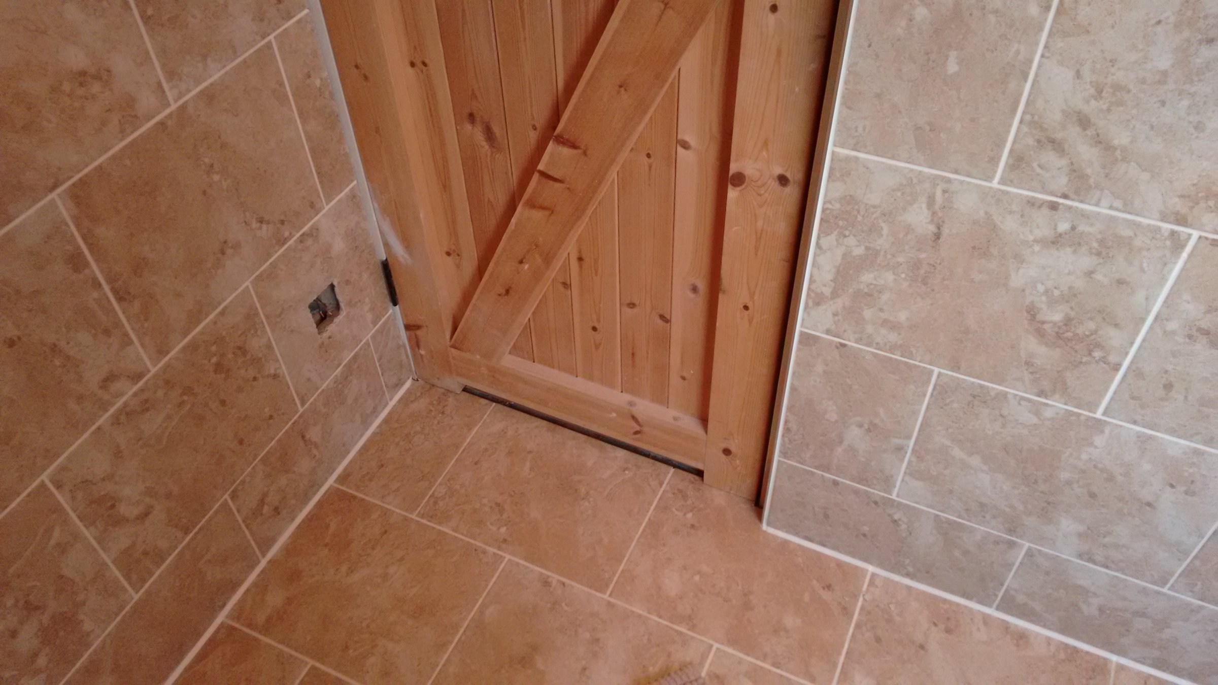

Hey guys,
Titles probably a bit misleading...but I've attached a few pictures to move things along :)
For some unfathomable reason we asked the sparky to put the spur for the towel rail behind the door. After tiling its painfully obvious there is no way to fit it there. I probably should have realised before I grouted, but cest la vie twas my first attempt at a bathroom.
I'd like to move it to the other side of the door but the element flex is nowhere near long enough. What I thought would be better, would be to leave the existing spur, run some new flex under the door, and locate a new spur outside the bathroom on the otherside of the wall where the rail would be located. Fortunately I havent replaced the threshold yet so taking it up will give me access.
Sounds like a reasonable plan. Any precautions with regards to zoning, and how I run the cable? As I've tiled and grouted it would have to go across to the door frame, down and under.
Definitely seems like a more sensible option, although it'll mean chasing out and plastering over afterwards. What about the existing spur - just go straight up the wall?
Straight up, yes! If they are paramount boards, then it would be possible to route cable with little chasing and damage to walls.

It's a switched spur
Is there space to move the towel rail to the left of where the spur currently is? I'm guessing not.
Nah theres not enough depth between the tile surface and the back of the door. Wouldnt be convenient
The new spur could be placed on the landing to save cutting a square hole in the tiles. With it on the landing, this may make a good place to fit a switch or timer if you don't already have one.
I think this is definately what I should be aiming for, putting a spur on the landing. It's figuring out how best to get it there form the current spur position!

Theres a light switch for the bathroom so its already partially *channelled*
Funnily enough directly underneath the top of the stairs is a set of sockets. I would say its pretty much inline with where the light switch is
How easy to lift a floorboard or two on the landing and get a cable from somewhere and fit the spur on the landing?
