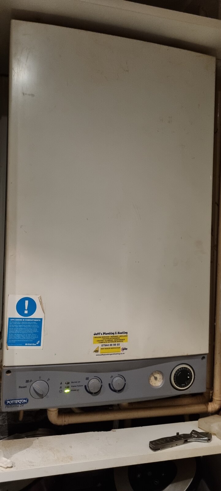

"Potterton 24" isn't super helpful I'm afraid - it just tells us it is a 24kW boiler made by Potterton. What's the model name please, or can you post a photo of the boiler?
As above, your builder is very very wrong to tell you that it's fine to use in its present condition. It absolutely must not be used until the situation is rectified by a Gas Safe Registered Engineer
This is the boiler, it's a potterton performa 24, that's all it says

Flue components for this (20 year old) non-condensing boiler will not be available.
New boiler time, regrettably.
Boiler relocation, reusing the salvaged existing flue unlikely to end well.

"Performa" was the missing bit of information.
As Polesapart says, the flue is no longer available for this boiler, so your options are either change the roof, or get a new boiler. If you go for moving the roof, the finished surface of the roof must be a minimum of 300mm below the bottom of the flue terminal.

Not to counter any of the pro's here but surprisingly it seems the flue and parts may still be available but you would need to contact them to confirm, some of these suppliers list them but don't actually have it.
https://www.heatingspareparts.com/boiler-spares/partno/247719/240639
You can report it direct to those that prosecute....
Builders enclosing flues is a continual problem..
https://www.hse.gov.uk/contact/concerns.htm
I hope you're not relying on the builder to sort out the electrics/plumbing & heating...that's often a recipe for trouble (builders are well known for screwing over the other trades).
Flue components are still available for these but are an extortionate price
