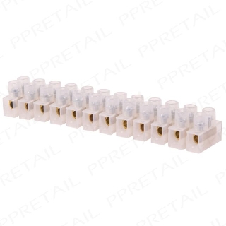

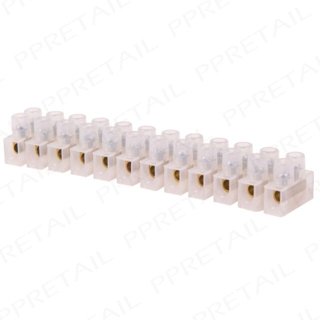

Hi, been getting round to replacing all sockets and run into a problem. On one socket all the wires are too short they have been very snugly pushed in and all the ends were weak so snipped them off now they too short for new socket. What's the best way to extend these wires now the earth is ok just the n and L can I just use wago connectors for them? And if I can which ones should I go for as space is very tight.
Any help please
Just use the old fashioned connector blocks - separate one each for L and N - much smaller than Wagos.
Oh dear, this will cause an argument.
Just use the smallest you can get all three wires in.
Put all three wires in for the whole length of the connector so they are all gripped and forced together by both screws.
For example:
The amperage of connectors is just a guide, use the smallest connector which are usable. Aim to get good overlap, between the conductors - in each, you will have two in from one side, one out, aim to have all three tightened onto by both screws, so the conductors cross over in the connector.
Ok thanks so doesnt matter which amp I use then will I need tape them up aswell? Just incase they come loose inside backbox?
Ok was just thinking with trying push wires back tight but il leave the tape.
Just to double check I can use any amp block like this one I've attached?

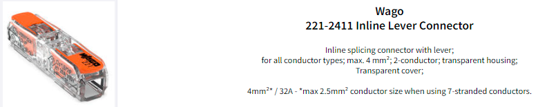

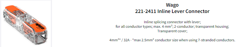

Before Wago 221s came along, I would have agreed with you, but I'm not so sure anymore - particularly since one can now get things like ..
Kind Regards, John

As for the 'size' issue, as I've said, I'm not so sure about that now that we have 221 series Wagos (and also 'in-line' ones, such as I illustrated). That could become increasingly important if one was faced with the (in my opinion 'silly') arguments about 'current ratings' of connector blocks - if, in a situation such as the OP's, one felt compelled to use a connector block rated at 30/32A, they are quite large!
Kind Regards, John
