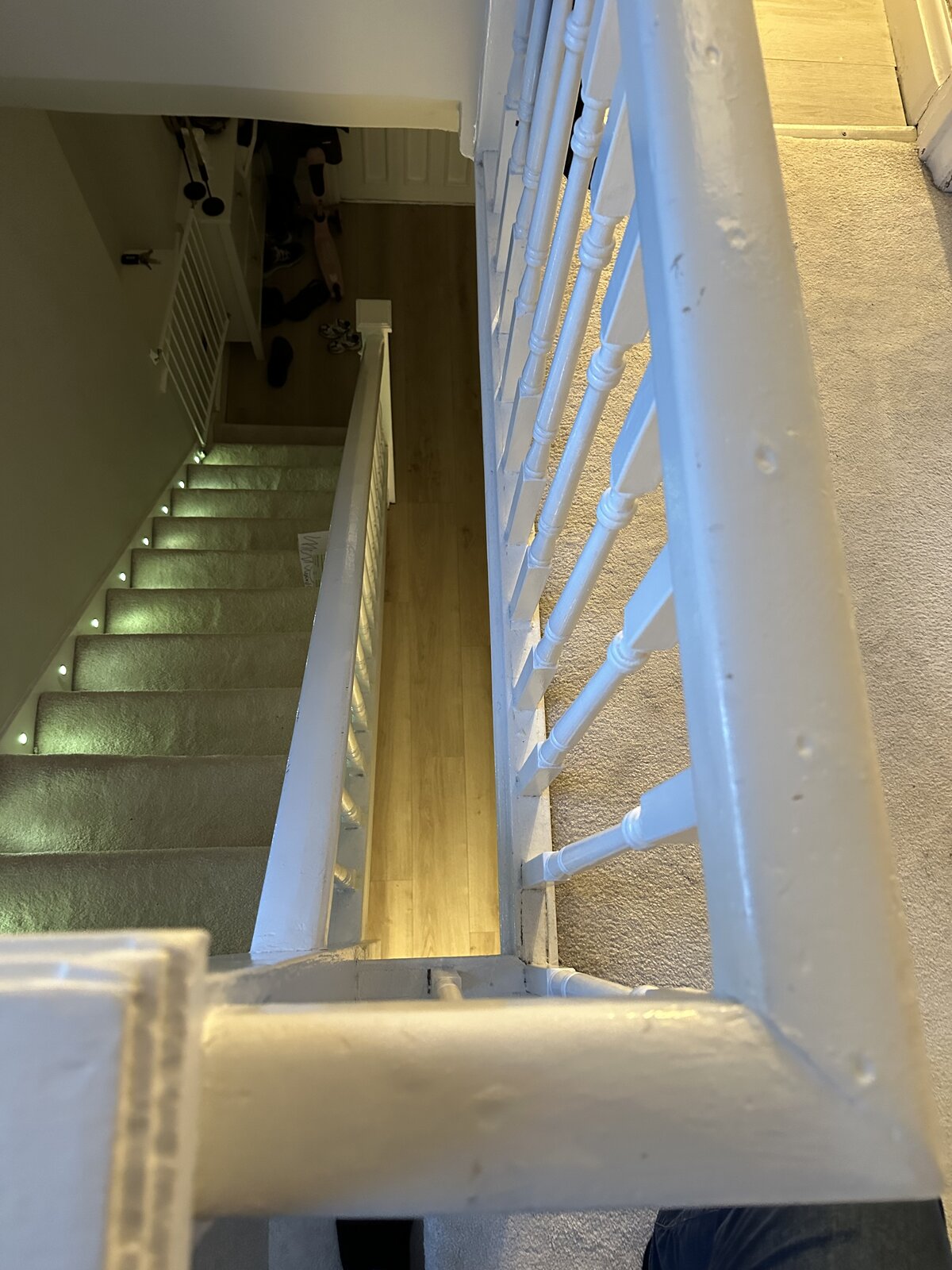

Not sure this is the correct forum to post in but I’m just after some advice. Is it possible to extend the floor space of the landing? In my mind it seems a rather straightforward job. I know it’s a small gain but it would make a big difference to our (my wife’s) life.
I have uploaded a photo. I would like to extend over the gap, and I want to replace the handrail anyway. Would it just be a case of connecting extra timber to the existing floor joists and boarding top and bottom and fit a new hand rail directly to the newel post?
You would have to make it secure/structurally safe.

Do you have 2 metres vertical headroom presently, measured plumb from the outside most point of the tread? If not, then you should not make it worse.

Making the landing wider I’d say is possible but a faff. You’d be oversailing the chunky trimmer which I assume runs along the edge, with limited options to support it at the ends

Not sure how the alteration would affect the headroom?

It would not affect headroom no, my main concern is how I would tie into the joists in the box room to provide support. I was thinking I should be able to access the joists through the bulkhead and put some sort of joist hanger there.

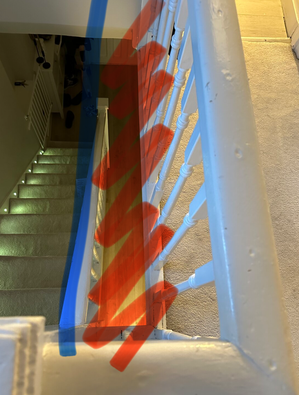

Do you mean to fit a new joist where the blue line is and board over the orange gap to make the upstairs hallway wider?
