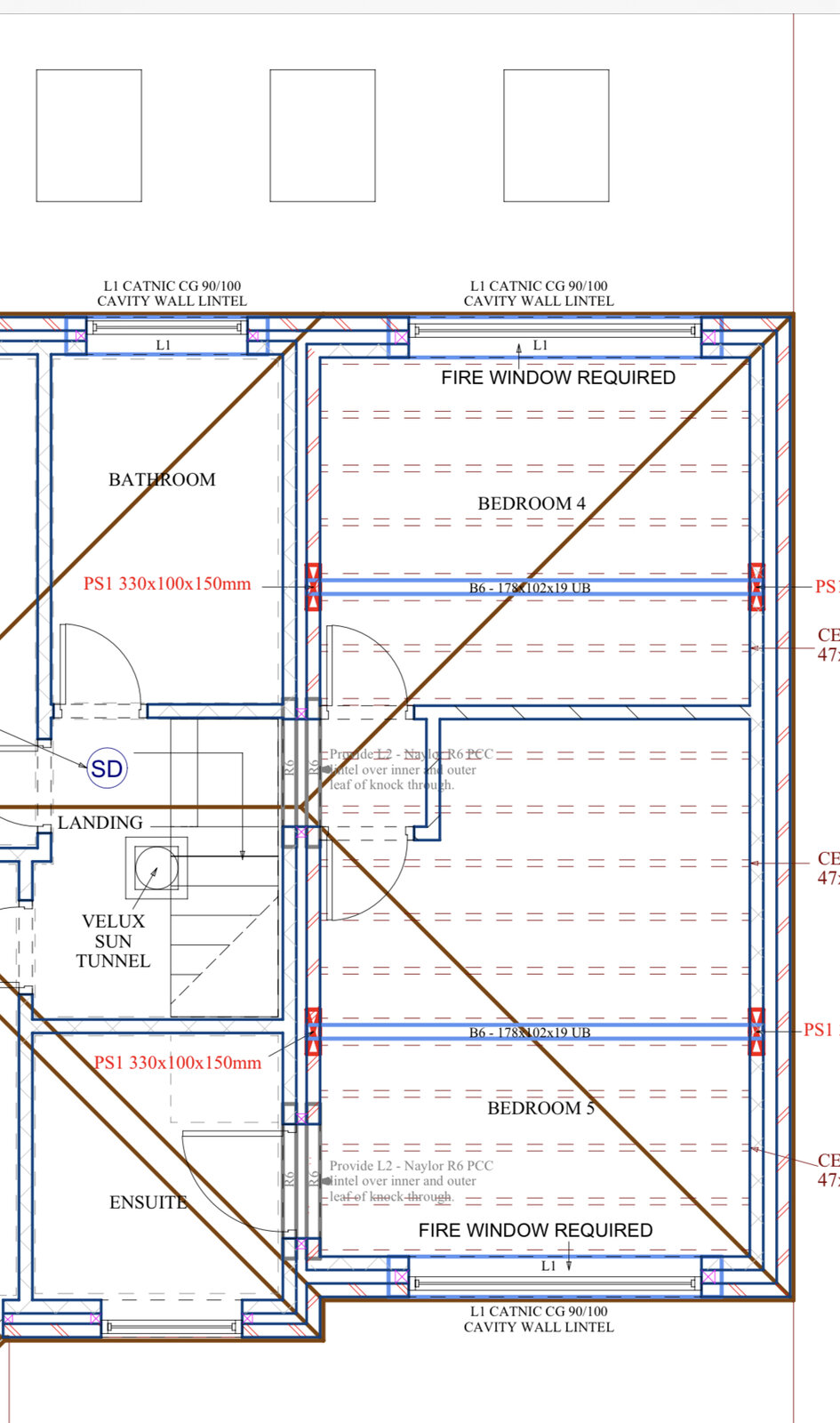

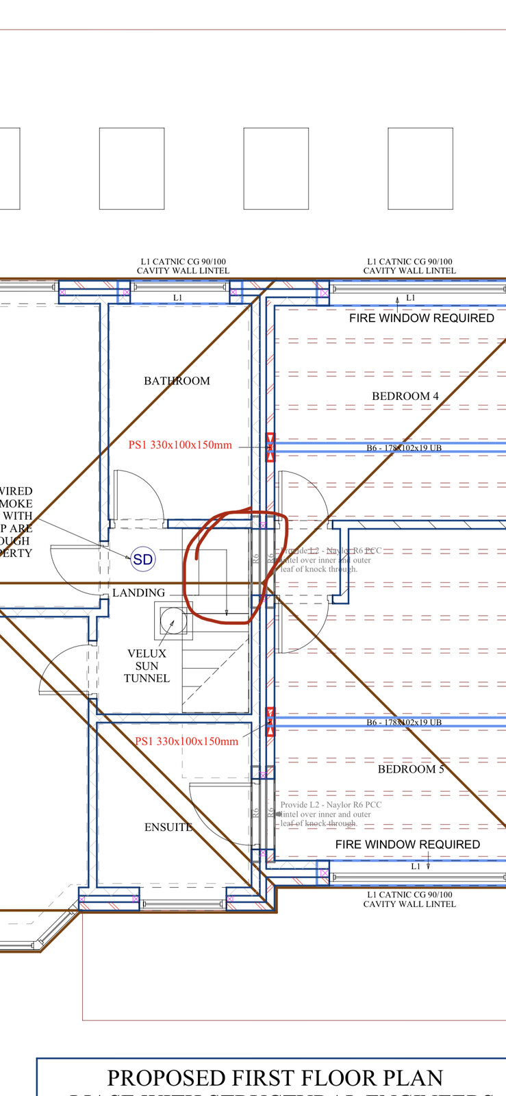

Hi All,
I got a question, can someone help?
My house is semi and extending to 2 storey.
From the stairs I’ll go up and from landing if I turn left and one step climb I’ll go to existing rooms. If turn right I’ll go to new rooms. I would like to know what is the building reg minimum requirement of the space where I’m turning right/left?
Drawings photo attached.

If it's 2 risers up to the new floor level, the arrangement on your drawing would comply.
Minimum distance from the top rise to the facing wall would be equal to the width of the stairs.

Lol. That's a bog standard extension on a semi.

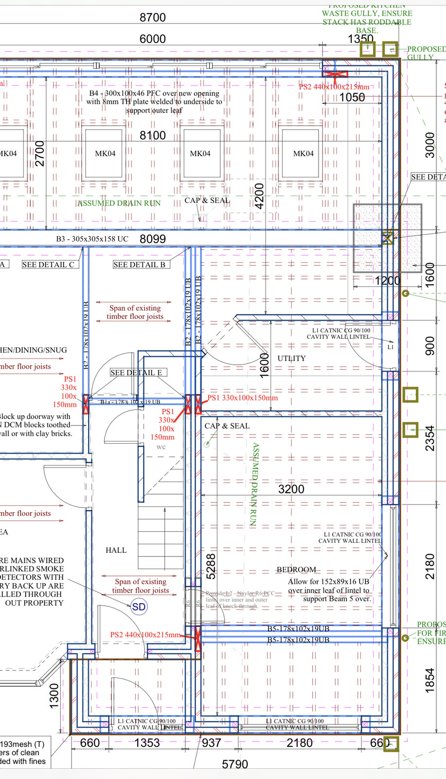

Thanks for the reply. Yes I got setback 300mm for first floor, but still didn’t understand why steel is needed at roof level. I will ask again my structural designer. Attaching ground and level 1 drawings. I haven’t installed level 2 steel yet. But level 1 is done.

And a bog standard cut roof with hips and purlins that need support.:rolleyes:
Do they?
Good design, efficient design, economical design means that steel beams would not be used in this type of extension.
Unless say you are a clueless designer, or a structural engineer being paid to use as much steel work as possible. But never mind, the client will pick up the bill.
I'm sure you've done many extensions on semis. And using steel beams must be standard?
I have done an identical hip end extension, yes. We used steels and timber posts to collect the purlins. The roof was plain clay (heavy). Once the roof was loaded, there was enough deflection on the beams to warrant the ceiling being battened down 15mm or so. Still better than a massive hip blade.
