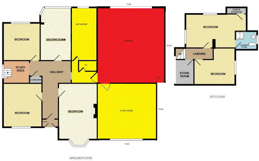

Red = New area
Yellow = Change of use for room

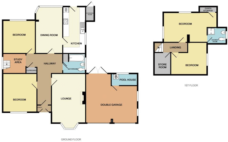

I am having thoughts about extending my bungalow.
Extension will go to the side where there is currently a 2nd driveway.
The double garage external wall is a single brick wall.
The front of the garage where there is currently x2 double up and over doors will be blocked and replaced with a window.
The internal walls I believe will need to have batons installed, insulation added and then plaster boarded.
The floor is already levelled with concrete.
New area is 48.75m2
Garage area is 30.25m2
Total area of 79m2
Roof will be flat EPDM with a lantern, rear of extension will be bi folding doors.
I have 2 approx. quotes for the work - both quotes are miles apart.
As you can see from the diagram, the majority of the walls are already up.
I have a architect to draw up plans soon, but what kind of approx. figure should I be looking at for the building work?

£33k and £110k ! (Both excluding kitchen)
£80k to £100k would be my stab in the dark.
Youve basically got in round figures a 50sq m new extension and a 30 sq m garage conversion.
It is never ever gonna be a £30k job
