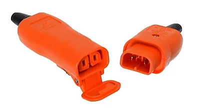

Hi,
I am trying to find an extension for this lawnmower cable. Pics at the bottom of this post.
The cable is approx 10 metres long and I want to get an extension of another 10-20 metres.
I currently use the cable plugged into an extension reel, which requires regular re-positioning.
I suppose I could just use a single gang, standard extension, plugged into the reel, and I could then plug the existing cable into that. Something like this:
But was hoping to get something more like this:
Can anybody please advise on the best solution and/or please tell me what the designation of the socket is so that I can search for cable?
The lawnmower is this one, which is 1800W.
Any thoughts would be much appreciated.

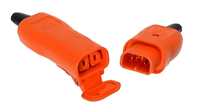

The lawn mower plugs and sockets are available 1656438610396.pngbut in the main you need to make them up yourself, seen very few ready made, the plug and socket you show is reversible German and not permitted in the UK because it can be reversed, not that it would matter for a lawn mower.
Since the lawn mower is double insulated it only need two core cable, so making up a special will be lighter than standard three core, but from link I don't know what plug and socket already used, maybe you can post a picture.
Thanks @ericmark. The pictures at the bottom of the original post are of the existing cable and here is a picture of the plug on the lawnmower and the socket on the existing cable.

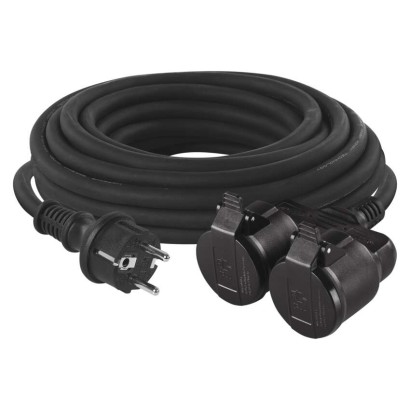

Thanks @EFLImpudence. I found this one on the UK site. Does it look OK?
It has double sockets, but that won't be a problem, and is 5 metres longer than the single socket version.
It's 3 core and 1.5mm.
As I mentioned earlier the mower is 1800W (~8A I think), so I think the 1.5mm will be OK.
I plan to daisy chain it with the supplied 10 metre cable for a total of 35 metres. Is that OK?
