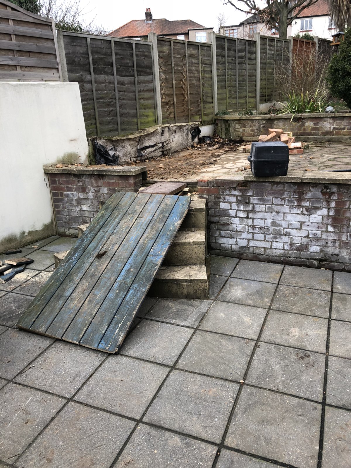

I’m looking for advice on getting an extension wall built that will be partially under ground. The current wall is a retaining wall as attached, which is about 800mm off ground level. The extension wall will be up to this height with windows sitting on top.

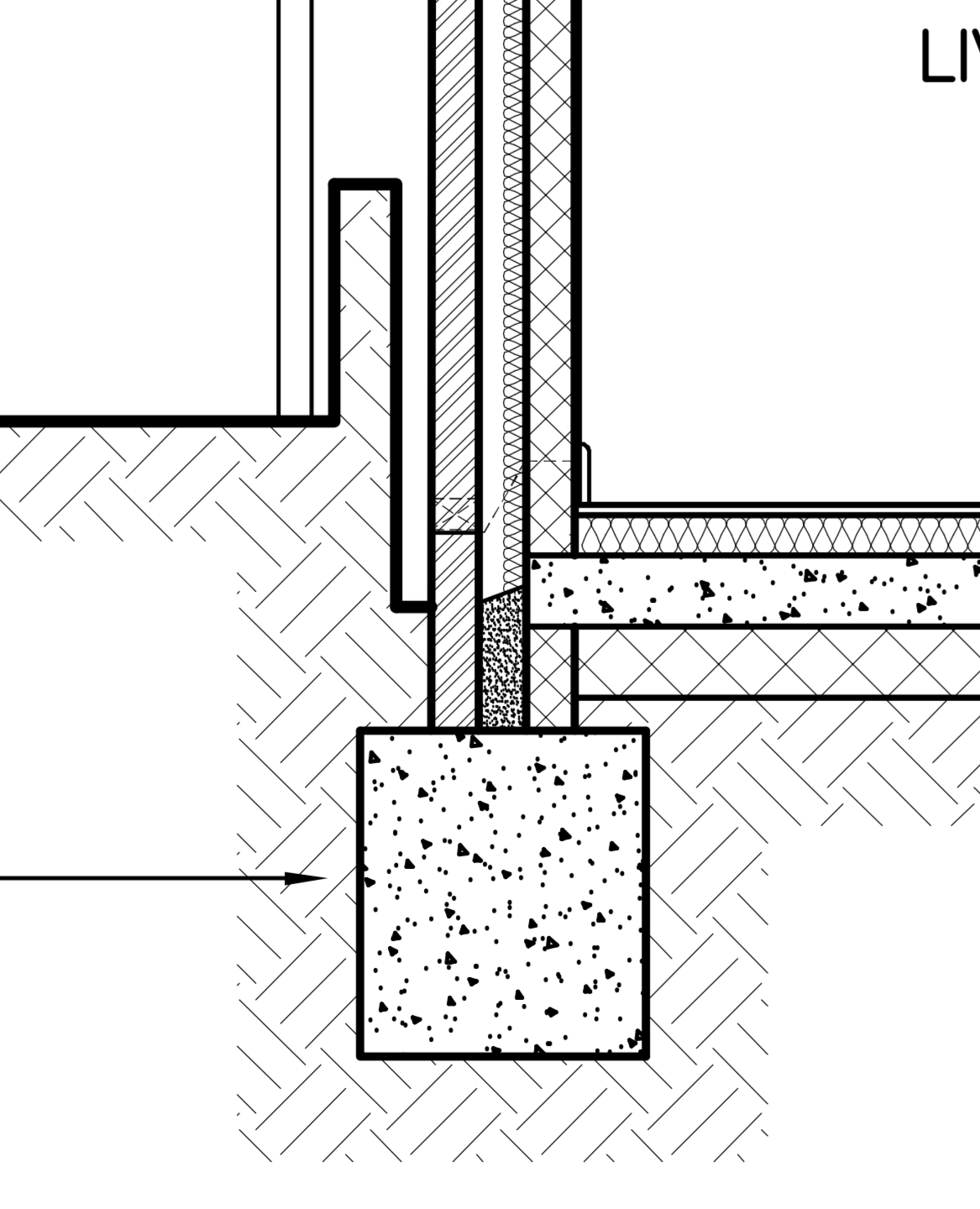

There are three ways that immediately spring to mind, some as suggested by your builders, the first would be to keep the existing retaining wall and just have a little gap eg

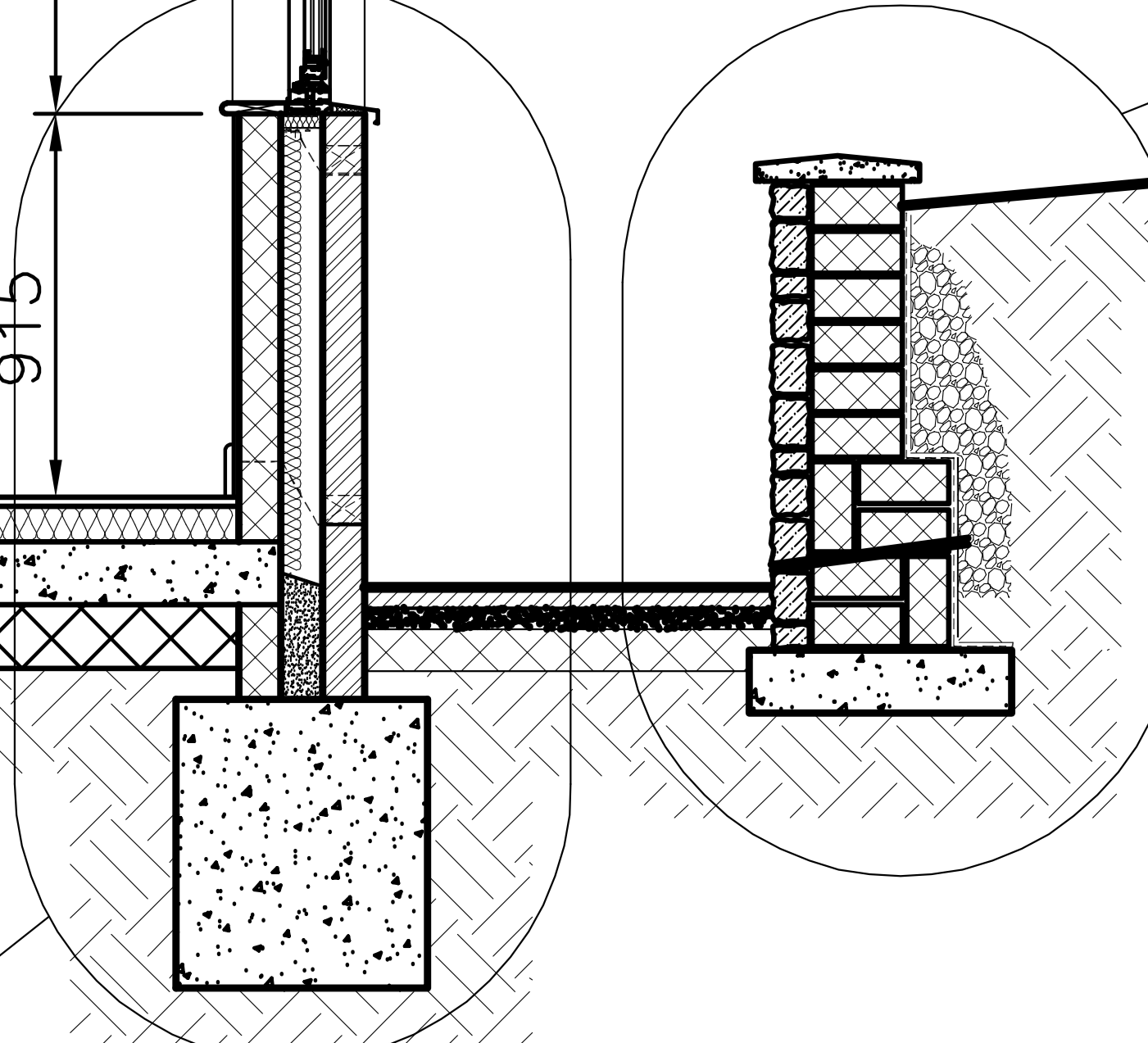

The second building a new retaining wall further back and a normal house wall eg

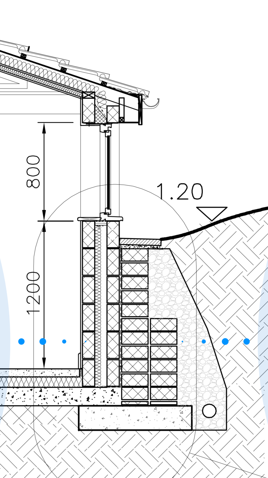

And the third to build the wall as a retaining wall eg
The first two maintaining the underfloor vents is easy, the third I guess you could build in some extended telescopic vents.

For #2 creating another retaining wall will result in wasting space between the house and the new retaining wall.
I believe #3 is what I am looking for. From the looks of it, the image shows a cavity wall and 2 skins of blocks being laid flat. So that’s a wall of approximately 700mm at its widest?
Sure but No. 3 is higher than yours so you could probably lose the additional block leaf on the outside, there are many ways to do this, a thinner RC wall with internal insulation for example, this is just one example but it's a simple solution and maintains a consistent insulation bubble around the cavity.

Do you see any issues with this setup for the retaining wall:
300mm aerated foundation Block - 100mm cavity - 100mm aerated block.
The rest of the walls that are not retaining I will use 100mm standard dense blocks.
I hear aerated blocks offer better moisture protection than standard blocks so makes sense to use them under ground?
Ok, I’m thinking now a 200mm outer wall 100mm cavity, 100mm inner wall should be sufficient and that leaves 100mm either side the foundations. The existing wall has stood for over 30 years at 200mm, so I’m hoping there shouldn’t be any issues with a new 200mm wall.
Cost wise a 200mm and 300mm retaining wall is roughly the same, due to being able to use additional 100mm blocks instead of ordering an additional lot of 300mm blocks.
Also just checked with celcon, they don’t recommend using any of their blocks, be it the foundation Block, or the hi 7 Block for the retaining part of the wall. Guess it’s the standard dense concrete block it is then @ 2 layers
