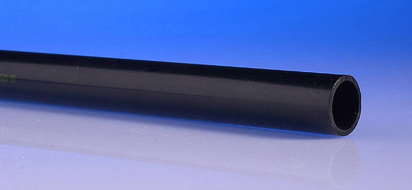

I wish to run some 10mm cable on the out side of the house (for less than two feet) to make my shower installation easier. Can anyone tell me what kind of conduit I require to protect the cable and where to source it from ?
JP
JP, the conduit you would need to put 10mm twin in would be 32mm, and you would need to buy at least 1x 3 meter from a wholesaler.
You may just about get away with 25mm, but you would have the same problem.
Cheers FWL,
Would this be the standard white conduit you use behind plaster or is there something different required as it's going on a na out side wall ?
JP said:
Cheers FWL,
The white conduit your speaking of is oval I assume, which means it is not conduit, but capping, is noy UV stablised and should not be used externally.
If you wish to use plastic it must be BLACK as this is the UV stablised variant.
I am curious as to how far up the wall this short section may be, if it is less that 2.5 meters up a wall, I would urge the use of steel conduit or protection.
It's right under the eaves, 4 - 5m high. I don't care what it's made of I just wondered what I should use.
It looks like this:
FWL - curiously, I was thinking the other day about your idea of using SWA for a shower cable, and about the problems of routing in inside the house, and I also thought about running it up the outside of the house and in through the eaves. Presumably SWA would be OK just clipped to the wall?
Ban, SWA can be clipped on the outside wall with no problems, it's one of the tasks it's designed for.
