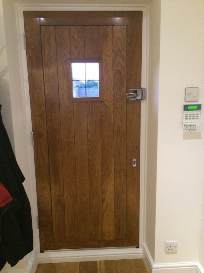

Hi,
I had a solid oak door fitted about a year ago, since then the door has started to drop very slightly.
On inspection, the joiner has cut too much off the bottom of the door completely exposing the tenon joint, leading to the door now being more of a parallelogram.
What are my options?
Thanks for looking.

There only appears to be a top and bottom rail. Hopefully the photos will provide some clarification. Thanks for the messages so far
i dont want to criticize another man s work but it looks close to 50mm cut off the bottom :(
Yeah, I'm afraid he's taken far too much off hence the issue, can you see the top of the door and how much the wood has come away from the top rail?
You also have to take into account that the timber in the middle is loose fitting to avoid cracking.
Sorry to say but it was very poorly fitted, and unfortunately it will need replacing as even if you changed the bottom rail you would need to change the lock positions and the hinge positions. Long shot I know but Is it possible to get the guy back that fitted the door originally and see if he is prepared to help at all.
