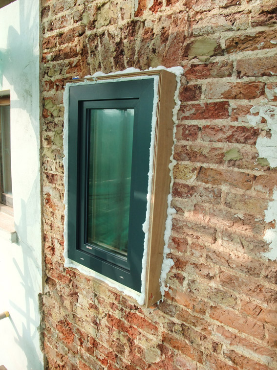

5) Windows, I’m looking to replace the windows at the same time, so what is the best way to fix the new windows, some suggest an 18mm ply box created inside the existing opening which allows the windows to come out, giving the appearance that they are still “Standard” distance from the wall when really the are now fixed to theouter PIR rather than brick. Inside window cill will be bigger, but I’m happy with that. Is this a good way to do so? (I would set back the ply enough so that it isn’t touching the outside layer) or is there an alternative?
6) Fix window first or boards?

You should fix your windows first as it's much easier, you can either use a ply box; timber batters on the wall or window brackets.
If you use a 180mm cill is a standard size so you can stick about 50mm on your brickwork and then this gives you 20mm drip and then you can fix normally. The ideal solution is to have the window inside the insulation so just forward of your brickwork though.

window inside the insulation is possible - if the window can fix within 100mm, and the window can fix securely to the insulation board, or i can engineer something to sit in the insulation for the window to attach to!

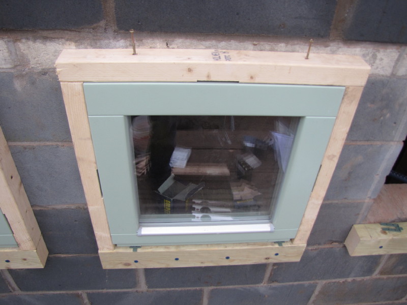

No doubt you've seen this image however it would be better done in cement board, this is a way another is just to add timber batons around the windows to fix into, there is a bit of fiddling cutting (a rabbit in the back) the boards accommodate the timber.
Similar to this, however your batons need only be 50-75mm deep, I'd also fix the windows normally with either brackets or fixing through the frame into the timber.
For large tall windows and bifold I use steel angle just for the bottoms.

Tomfe, that's basically what I was thinking in terms of fixing the windows. (Though not sure how I can do the round bay and keep it strong!)
Do you have pics of the internal setup of those? Or drawing of the cross section?
No but there's nothing complicated about it, it's just a box. You can make it full reveal depth or not just think about how you are finishing the internals.
