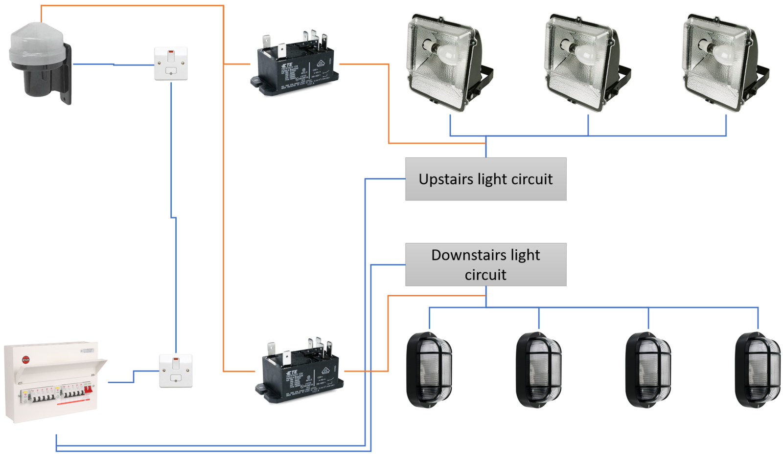

Some time ago I posted asking for help with our external lighting circuit (see thread here https://www.diynot.com/diy/threads/external-lights-floods-bulkhead-circuit-issues.531240/ )

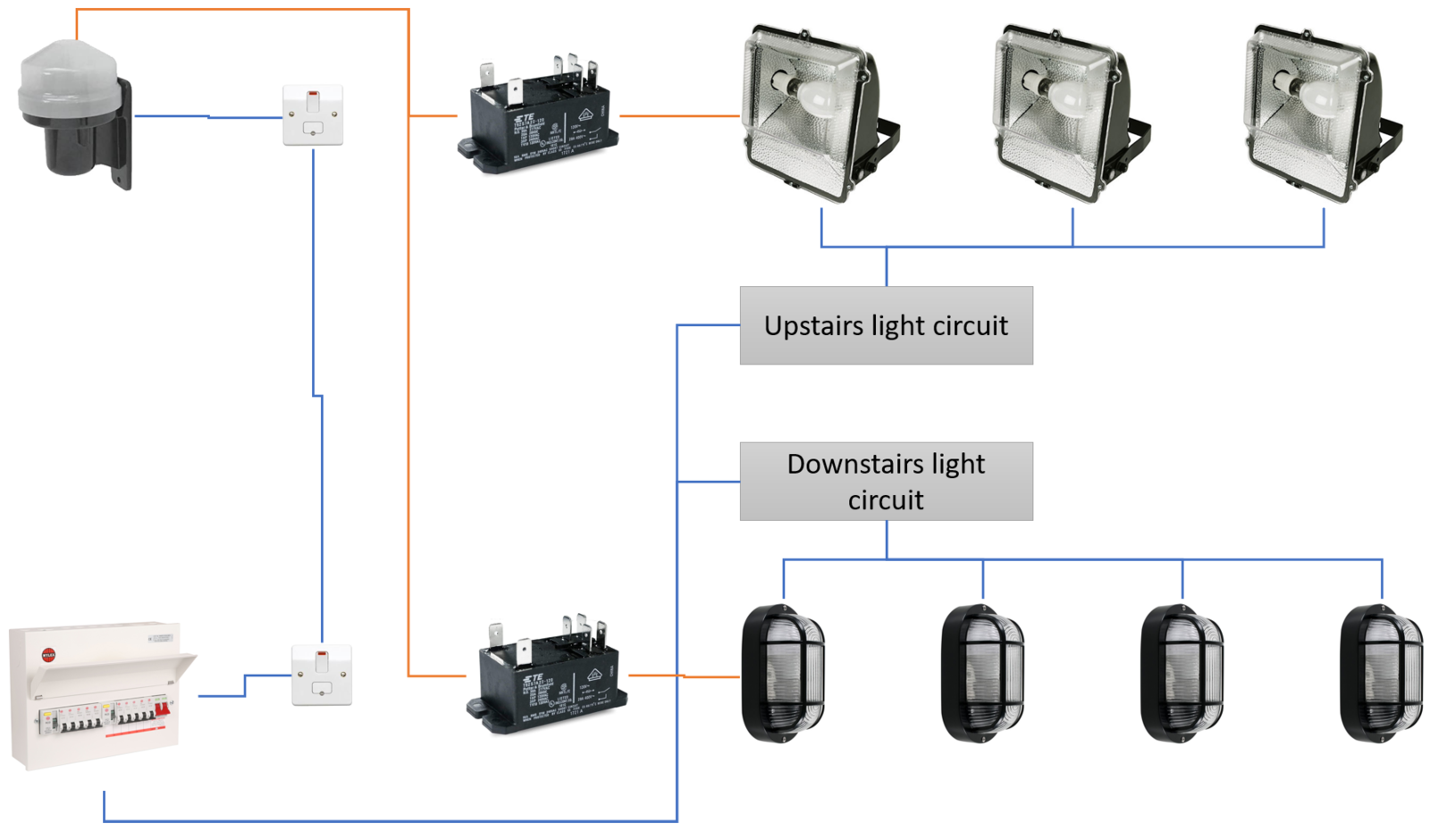

Long story short, I've replaced the 3 sodium floodlights and all lamps, checked the circuit and fuses, and it is now all working. The circuit looks something like this:
The photocell is the switch to the two relays/contactors, which in turn switch the upper sodium lights and lower bulkhead lights around the outside of the property. Power to the upper and lower lights comes from the upstairs and downstairs light circuits respectively.
The whole system is now working as it should, with the exception of the 3rd sodium light. This spends its whole time switching on and off randomly. It is a completely new unit with switchgear incorporated and new lamp. I had replaced it once before and believe it has been replaced by the previous house owner too as it didn't match the other two originals.
So, it appears there is something up with the circuit but I don't know what I should be looking for. Could a voltage drop cause such behaviour? What should I be looking for with my multi-meter? Is it just a coincidence that the unit failing has the longest cable run?
Any advice/suggestions welcome.

I'm a bit confused by your diagram.
Two circuits - upstairs and downstairs - on one wire?
Being picky.... the device you show on the upper left is a photocell - a dusk til dawn switch. Is this what you mean?
A PIR is a movement sensor - sodium lights dont work well with a PIR because of the long run up time.
I guess he means that the power for the load side of the contactors comes from the upstairs lighting circuit for the sodiums & the power for the bulkheads comes from the downstairs lighting cicruit?
Check the voltage at the third fitting, sodium ballasts have different tappings, you may need to move the wire to the 220 volt tapping

When the whole circuit energises and the lights come on, all 7 lamps light up and then after a bit of time the last sodium on the run switches off for a little bit, then re-ignites. It does this randomly at undetermined intervals, whilst the other 6 lamps stay on.

Sorry, PowerPoint isn't the best for drawing circuits, and I'm no spark so wasn't sure how best to show it. There is a circuit from the CU for upstairs lights, and a circuit for downstairs lights. The switched output from the photocell runs in parallel to the 2 relays. I've updated the image slightly to (hopefully) clarify a bit. Very simply, blue lines are power, orange the switched live. In my simple head, the relay is acting in place of a simple lightswitch as the photocell couldn't handle the load of all 7 lights on its own.

Not picky at all - good spot and a lesson to me not to do 2 things at once. I do indeed mean photocell - the circuit is designed to offer dusk till dawn lighting. The fittings are SON with internal ignitor.
I did indeed - hopefully a bit clearer now!
I guess he does - so the diagram is confusing.
Didn't know this - very useful. Would it be feasible for the voltage to drop sufficiently along the circuit to the last sodium?

I think were RF is going here is that SON lamps tend to cycle as they reach the end of their life.... they will burn for a while then extinguish, cool off, re-strike & repeat the whole cycle infinitum. This cycle often takes around 10-20min depending on the temperature. Could this be happening?
Also, if a SON lamp with an internal ignitor (shown by an 'I' within a triangle on the lamp) is installed into a fitting which also has a built in ignitor then strange things can happen.
SON lamps intended for use with an external ignitor (shown by 'E' withing a triangle) dont usually start at all if used in a fitting without an ignitor.

These are brand new SON lamps in brand new fittings - I don't believe it is a lamp approaching end of life. As it has happened with this particular unit previously suggests there is something underlying. The cycle takes longer than 10-20min too. I have a spare lamp so can swap around to prove one way or another.
The lamps and units were bought together as compatible lamps & fittings, and the other 2 lamp/fittings work perfectly.
The wiring runs for 1m from the relay to a junction box; here it splits with a single run going to the fitting at the back of the house (about 5m) and another run going to the two fittings at the front. This runs for say 8-10m into another junction box, where it splits off for the 2nd fitting and then continues on for another 2-3m to the final fitting. So the fitting that is failing is on the end of a shared loop, farthest away from the supply. (It's worth bearing in mind there is about 4m between the CU and the relay too.)

A really simple test you could try is swap the lamp that’s playing silly devils with one of the good lamps from the other fittings and see if the fault moves with the lamp or stays with the fitting.
