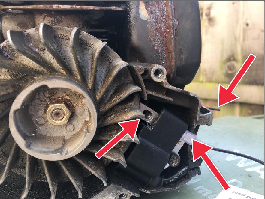

My FS120 had a broken wire & fell on the floor.
It was part of the coil so i purchased a new coil & now trying to fit it.
Now i had 2 wires coming out of the case which were connected to a kill switch to stop the engine.
There 2 wires were both on the coil,lower Red wires in photo.
With cover off & broken wire on the floor whats the wire that you can see top right of photo ?
I was wondering if it was a continuation of one of the wires on the coil but not sure ?

If you wish to retrieve it at some point it's the kill wire to the switch and then back to the engine to an earthing point.
