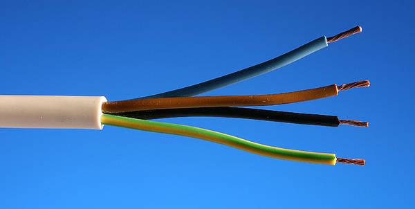

For goodness sake.
Round 4 core flex would have G/Y, brown, blue, black.
Perhaps it's that.
For goodness sake. Round 4 core flex would have G/Y, brown, blue, black.
Would it? I've never seen such an animal.
I think that EFLI's suggestion is much more likely - that it's actually brown/grey (not blue)/black - which would obviously be 'as expected', whether flex of 3C+E.

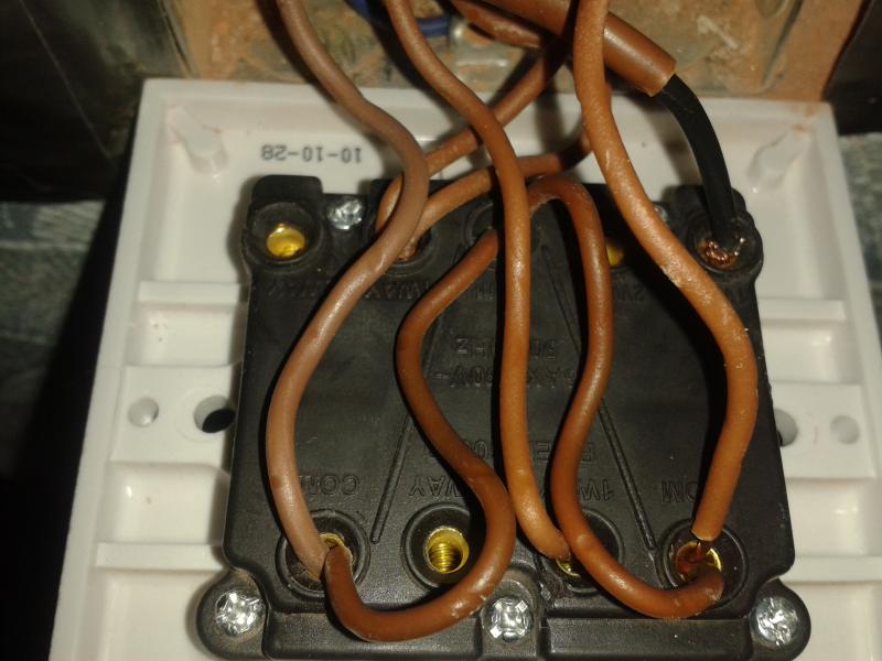

Hiya the light I'm trying to fit is a Polaris security light with sensor. It is replacing an old security light that also had a sensor. Unfortunetely it was taken down before I could see where the wires went. I've attached 2 pictures. One is a diagram of the instructions as it's peling it down at the mo so can't take a photo of the actual light. the othe is a picture of the light switch which has 3 lights connected to it (from left to right) 2 indoor porch lights working from one switch, outside porch light and the finally the the security light I'm having trouble with. //www.diynot.com/network/muimui/albums/ I'm not sure how to load images, so hopefully I've done it right.
Hope this helps[/img]
Did you have a separate switch which turns the light on (regardless of the PIR) and/or did the previous PIR also operate some other light?
Whatever (and assuming that there are no other wires), it would seem that your brown and black (with brown sleeve) need to be connected to the light's terminals marked LS and L - one way around or the other. If you get them the wrong way around, the light will probably be on permanently, regardless of the PIR, so you would need to swap them.
