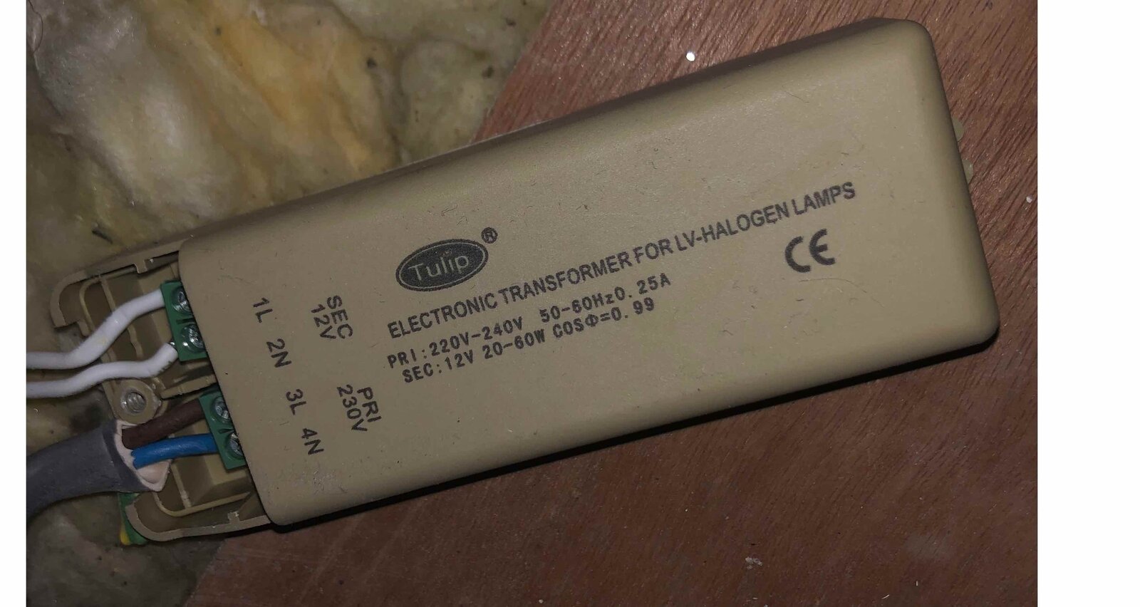

I have an ageing extractor fan above a shower that goes into the loft. It has a two pin centre bulb which only comes on when the extractor is switched on. That continues to work. I thought I'd use a multimeter to check the DC power output in the transformer in the loft and can't work out why it always shows 0v. The meter is working - it measure the main voltage (as 330V which I understand to be correct) and I can test AA batteries with it ok. I plan on just changing the unit anyway but though I'd ask a) what am I doing wrong or b) could the transformer be at fault? Thanks

Photo of the transformer attached - looks DC to me

Looks like mains 230vac imo with 12v step down transformer for the lighting. No mention of 330v anywhere.
It's either busted, or it doesn't output anything until a suitable load is connected.
Given it's age, busted is most likely.
Either way, it's years past the time to sling that and the halogen lamp away and fit an LED instead.
If you want to keep the existing fitting, then a LED lamp and suitable LED driver will be required.
