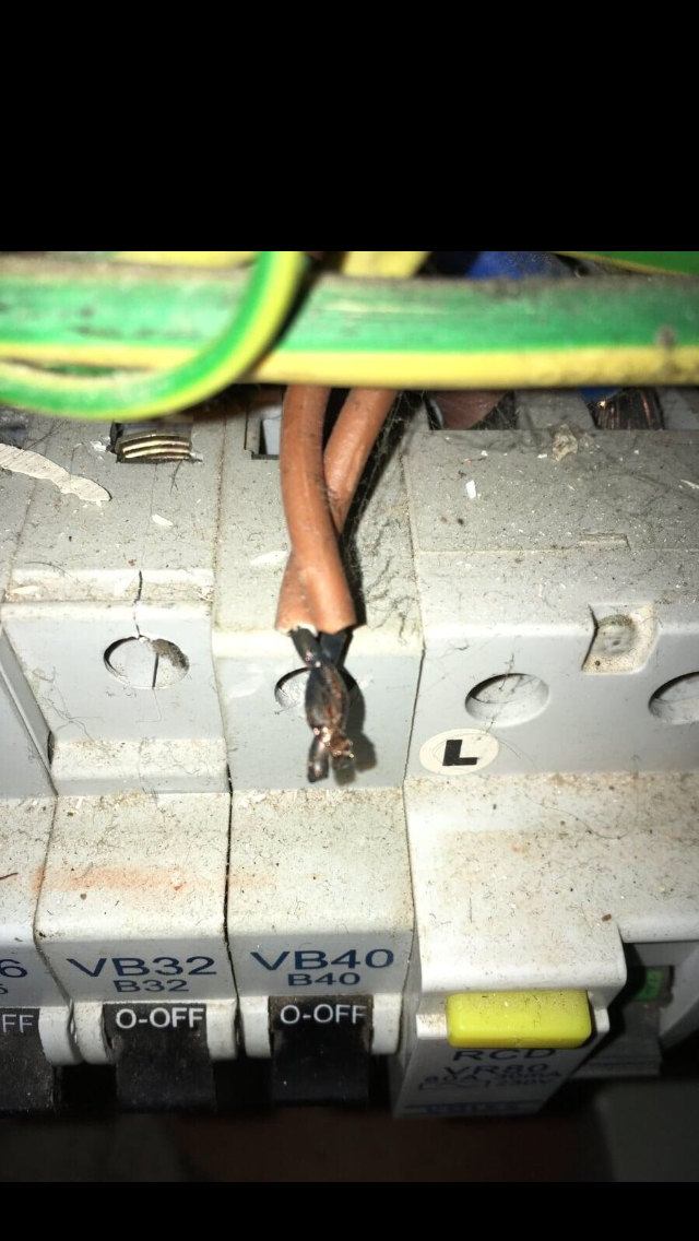

Hi, I have a rental property with a few failures on the eicr.
I have a few items I need to address eg mcb ratings to change (even though they passed last time with the same company)
Do I need to get a certificate to say thats been done or can I do it myself and document it ?
thanks

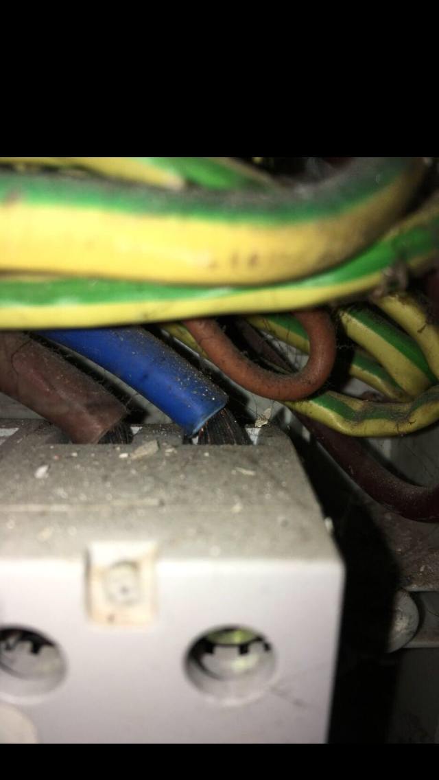

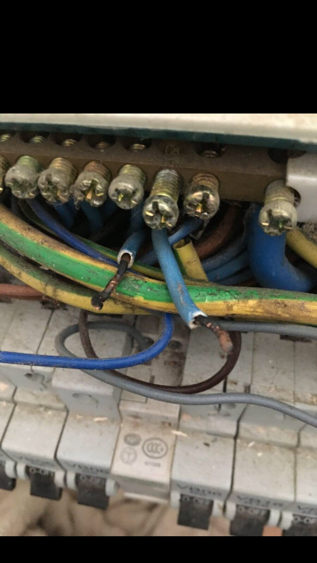

Thanks, apart from the circuit breaker mismatches, the copper of the cable looks black in one of the flats, which they said is unusual, they put it as thermal damage but theres no sign of insulation etc melting.
the other issue was a low insulation reading on an internal lighting circuit fitted with a pir sensor.
when i questioned the engineer he said he had asked his boss if the sensor could have caused this, but the boss said put it down on the report.

You might want to ask more about that. If they did the IR test with the PIR circuit, it certainly mioght have affected to IR readings but, depending on how they actually did the IR test, might even have damaged the PIR.
Did he give that a "C2" code? If so, you should ask what 'urgent remedial action' he believes should be undertaken.

Are any more of the wires that black colour? I see it on the stranded wires and maybe on the earth wire
I've had this effect on a coaxial cable which I put down to water ingress, no way was it possible it had overheated.
The dirt on those surfaces isn't just dust, I think it looks like it's been subject to something atmospheric but before anything else I'd like to know how many wires are black.
If that ring final has been attached to the 40A breaker, could that have a bearing?
Thanks I think they all are black but Ill double check today.

Thanks, they gave “F1” code, “Further investigation to ascertain fault on circuit.
on the black cables its “Further investigation to ascertain extent of thermal damage”
Thanks, That 40a breaker is for a shower Im currently getting no hot water from, but I know the shower is ok as it works when in a different flat. Could this possibly be the cause ?
