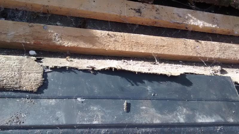

I was wrong; felt support trays were fitted. But the felt is pretty knackered and the equestrian who did the work just shoved the trays up with little regard as to whether they went over or under the felt.
So I need to remove more tiles and battens and replace the lower felt section. By how much should the old felt overlap the new felt and by how much should the new felt overlap the support tray?
if you take a couple of rows of tiles off you can work from above, the horizontal timber that you have seen in other situations is used to hold the soffit down on top of the top row of brick at the back, if your situation means that you dont have anything to push the soffit down on you can use the same method and nail the back end of the soffit up to the same type of arrangement. if the new soffit is a brick lower then add the size of the brick to the current fascia height and buy that depth. also the eaves trays need to be below the old or new felt, usually the bottom few inches of old felt is perished so if you stanley it of 100mm up first across you can get the eaves trays under without ripping the felt upwards

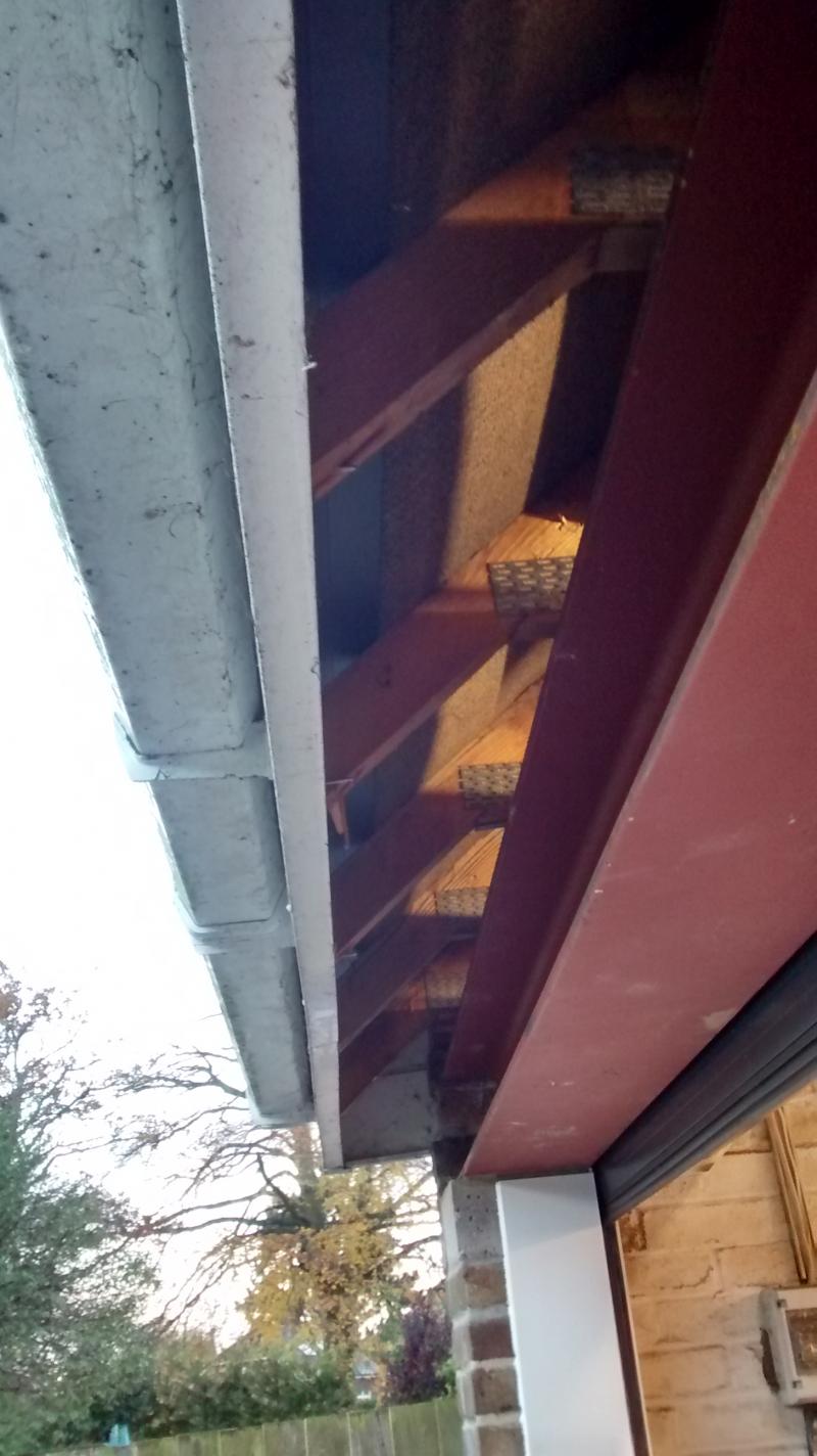

Thanks for the replies so far. The steel and new door are now in place. I've used a circular saw to cut off the bottom inch of the existing fascia board so that I could fix in place hangers at the front edge of the roof trusses/rafters to mount both the fascia board and tack in place the front edge of the soffit. I've also put in a second set of hangers dropping down just in front of the beam to hold the middle of the soffit. I'll use a sealant/adhesive to mount the back edge of the soffit to the underside of the steel.
Thankfully the truss/rafter ends are nicely in line.
Here's an interim photo; I forgot to take one with the hangers before it got dark.
