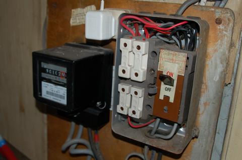

Another issue with old installations is the lack of earthing and bonding conductors. Could you post a picture of your consumer unit, meter and cutout? This will help us to give you more useful info.

I've asked for a photo to be uploaded but I guess you won't need it now.

Gosh that's an old one! Though it looks neatly done and in good condition. The cables appear to be PVC and no deterioration is obvious in the pic.
Time for rejuvenation, I think!
As it has old ceramic rewirable fusecarriers, there may well be wear or erosion in the contacts, especially where the fuseholder go in. You might find scorch marks on the prongs of the fuse carrier.
Otherwise it could be a loose connection, or even a crack in the ceramic. If there has been a loose connection in the past, sparking may have eroded the connection. It may also be the switch, which is a moving part so can wear out or get loose.
I can't see any earth wires, which is very worrying.
The tails look undersized.
That sort of era could even have asbestos flash pads in the fuse holders, take care.

didn't see that
it could be swapped with the one from lower left.
On 2nd thoughts, maybe it's the r/h one that is disused...
You were right, there is a crack in the bottom fuse carrier. The fuse for the lighting is the left hand one. There are earth wires, too, they just don't show up in the photo (Lord Lichfield I ain't!). There is another fuse box underneath the one in the photo. This is a newer one, installed about 20 years ago, and there are earth wires from the fuse box in the photo down into the newer box.
