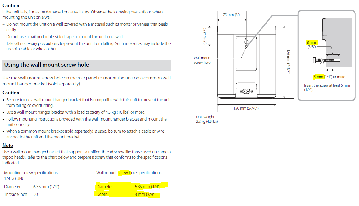

Hi all, I'm trying to find the right screw to attach my speaker to a speaker stand.
I have the details (see image) but at the nearby hardware store they are pretty useless.
First they gave me one screw (M5 I believe) which is too small. Then another one (M6 I believe) which is slightly too big.
Is there a website where I can buy the right screws?
Many thanks!

If an M5 is too small and an M6 is too big would this be a non-metric screw such as BSW (Whitworth) or BA (Armstrong)?

Thanks guys, that was extremely useful. I was focusing on the hole specifications, didn't notice the screw specifications...
You could just use a standard bolt in the wall mount bracket and lock it in with a nut.
