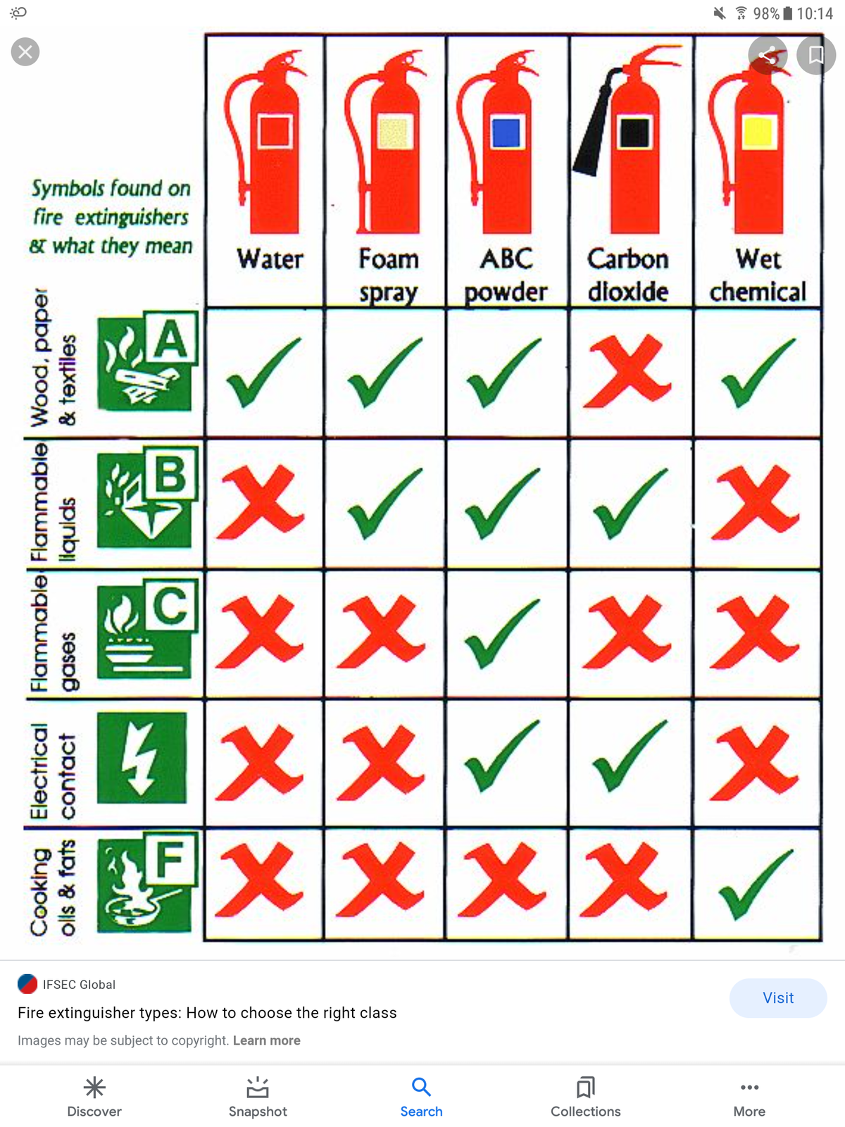

I am after a fire extinguisher that copes with live electric fires and also fires induced from the hob and cooking. Can you please recommend and appropriate extinguisher? Also do they need to be serviced/replaced every x months/years?

Screenshot_20210508-101429.pngPhone 999 and leave it to the professional's. The use of the wrong extinguisher can cause more problems.

Water mist. Look it up. They are safe to use on just about every kind of fire, certainly in domestic situations, including electrical fires.
I have both carbon dioxide and dry powder available in my kitchen, I prefer the carbon dioxide one as it leaves no mess (although that's the least of your worries) but using the other on fat fires is not advised as people tend to squirt it directly at the fire and then blow burning fat out of the pan.

Surprisingly, the water mist extinguishers don't leave a mess! It's more of a vapour than liquid water.
