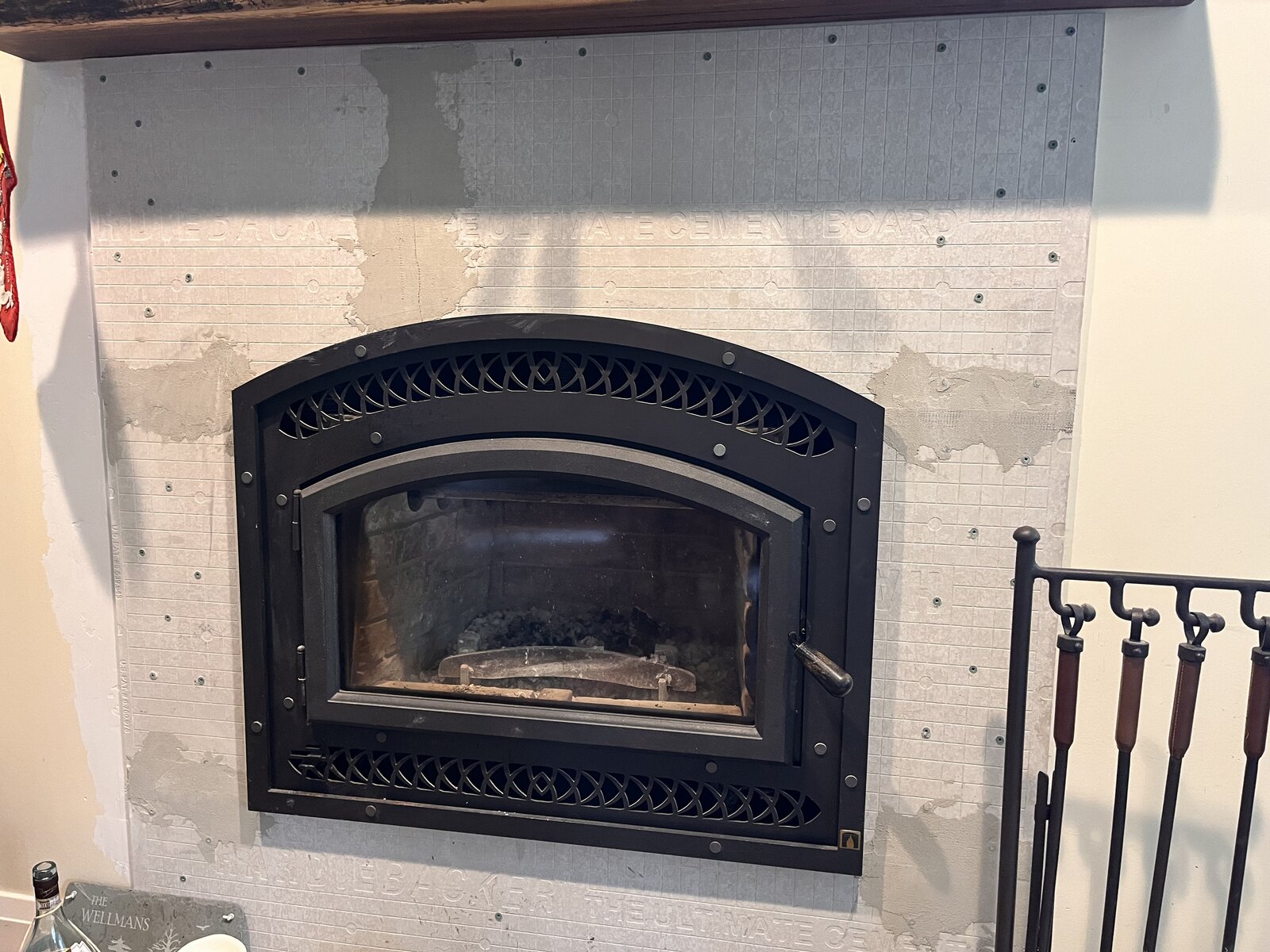

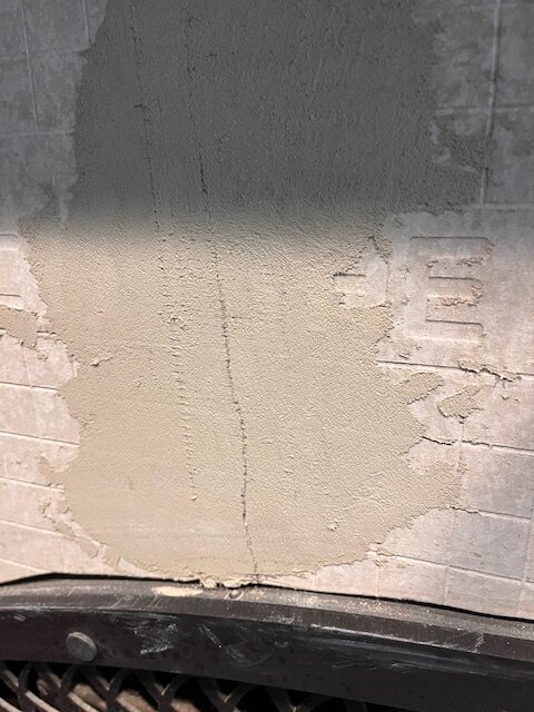

For an older Bis woodburning fireplace I have attached 1/4 hardie backer surround. It is loose against the fireplace sheet metal but secured to studs on both sides. While deciding on tiles, a hairline crack developed over the door of the fireplace. I filled with thinset (mapei ultraflex) and fiber tape. Weeks later, I burned a couple logs hot and the crack returned. Should I open the crack and refill? Or tile over the crack? ?? Thanks.
This extends from directly above the door to the underside of the mantel.

There is no cracking problem at the joints, just above the door where it has gotten hotter.
There are no metal studs. There are wood studs flanking the fireplace and a header above. You can see where the backer screws are driven in.
That seems a large unsupported distance for such thin boarding. I cant see the construction behind but it appears you could be very close to combustibles to comply with regs
